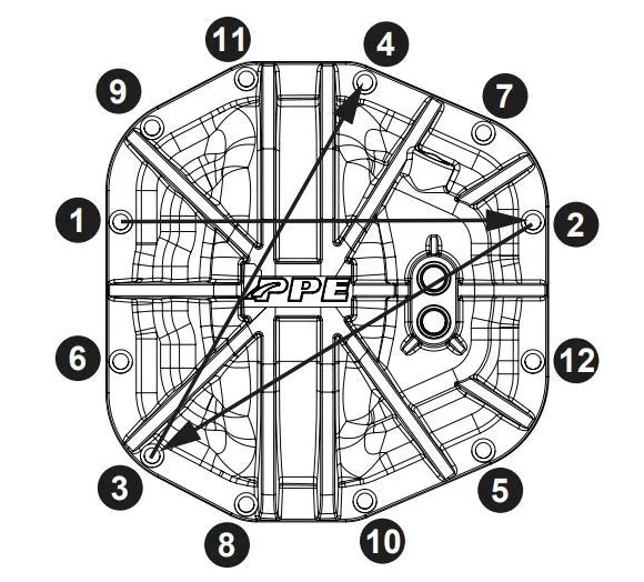

So finally planning this for tomorrow and lost confidence on rear diff torque specs and pattern. Reusing the stock rear diff cover (22 Badlands). Cannot find a pattern other than the PPE cover pattern which looks a bit uneven. 177 in-lbs or 14.75 ft lbs plus 25 degrees, or 25-30 ft lbs from the Dana spec sheet? Also read not to reuse the bolts as the factory spec is torque to yield, which is odd to me for something like a diff cover that is supposed to be serviceable.
Any insights on the torque value, pattern and reuse of bolts for stock rear diff cover is greatly appreciated! Probably over thinking it. First time on this. Thank you @CarbonSteel and others for all the great info in this thread!
Unlike some fasteners, the service manual for the rear diff cover does not make note of bolt disposal. I say clean and reuse them. New bolts are relatively inexpensive though.
The factory specification with the Ford reusable gasket is as you've noted. 177 in.lb. (20Nm) + 25 degrees for both the studs and the bolts. I think I had torqued mine to ~24 Nm with a dab of thread sealant in an alternating pattern. Reused the gasket. No problems.

The PPE pattern is spot on and the bolts and the OEM gasket can be reused 10x or more (I did on my Wrangler which has the same axle).
I think I torqued to 22NM and called it a day. I have had no leaks.

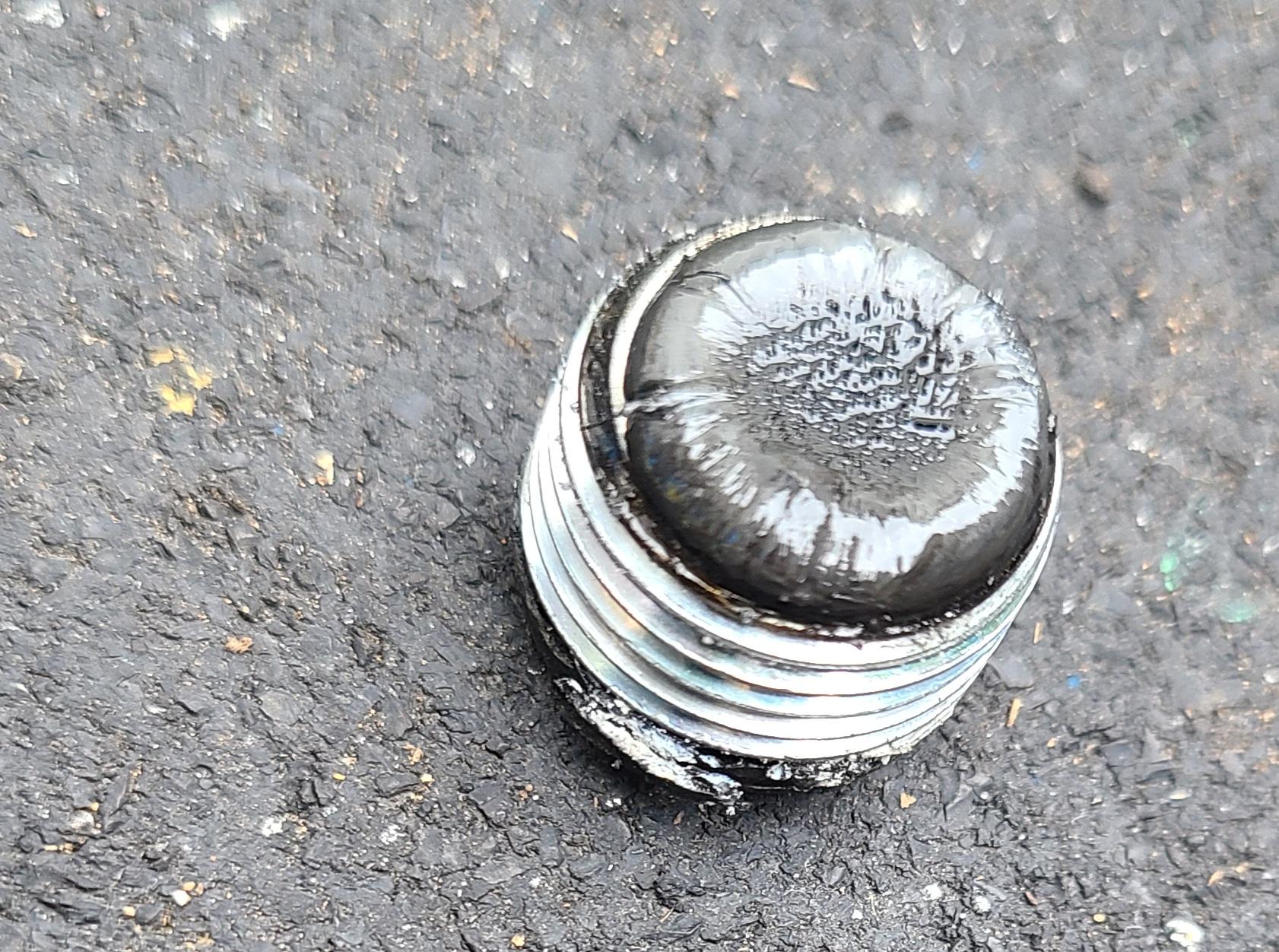

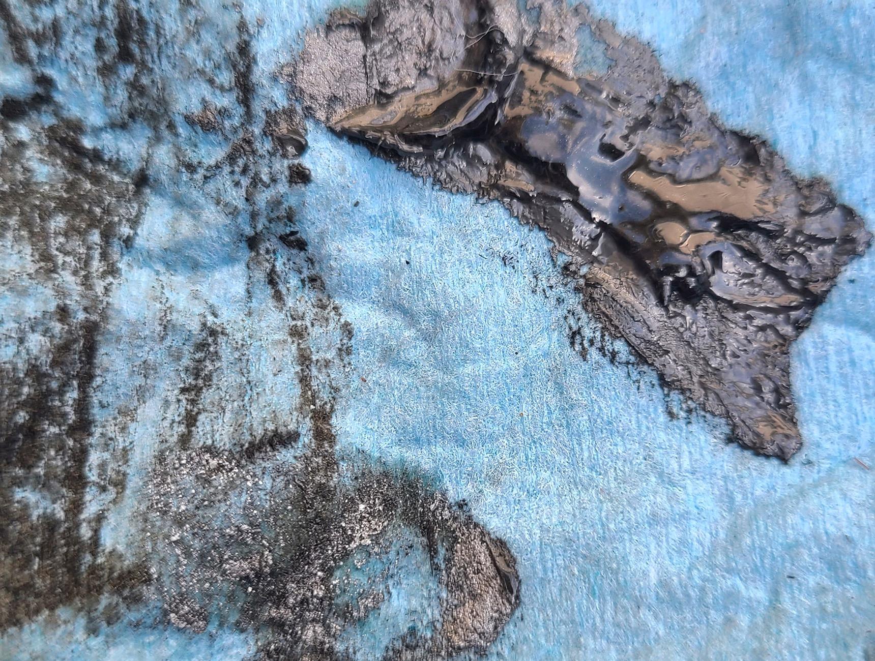

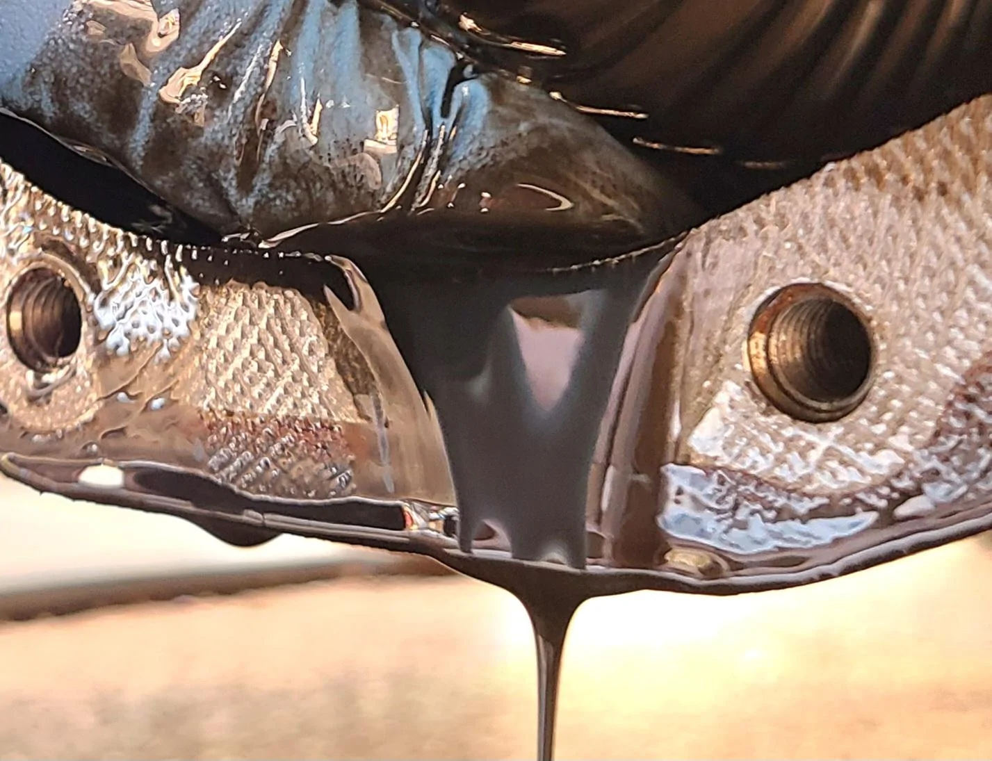

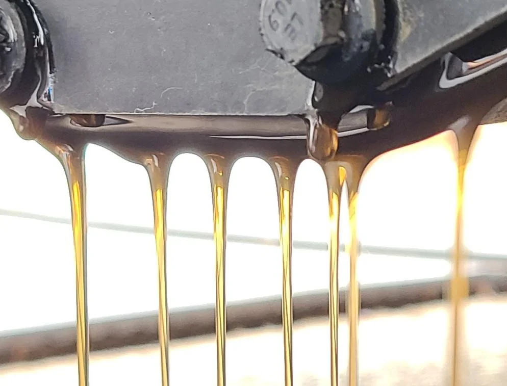

So glad for the good folks on this thread and the opportunity to easily prolong the life of the Bronco. Pulled the fill plug and it was doing its thing, covered in metallic sludge. 9,500 miles new. At first drain the oil looked reasonably ok but by the end it was terrible. Didn’t measure but drained less than 1 quart / half-filled. Obligatory pics attached. Takeaway: gear oil smells bad.
