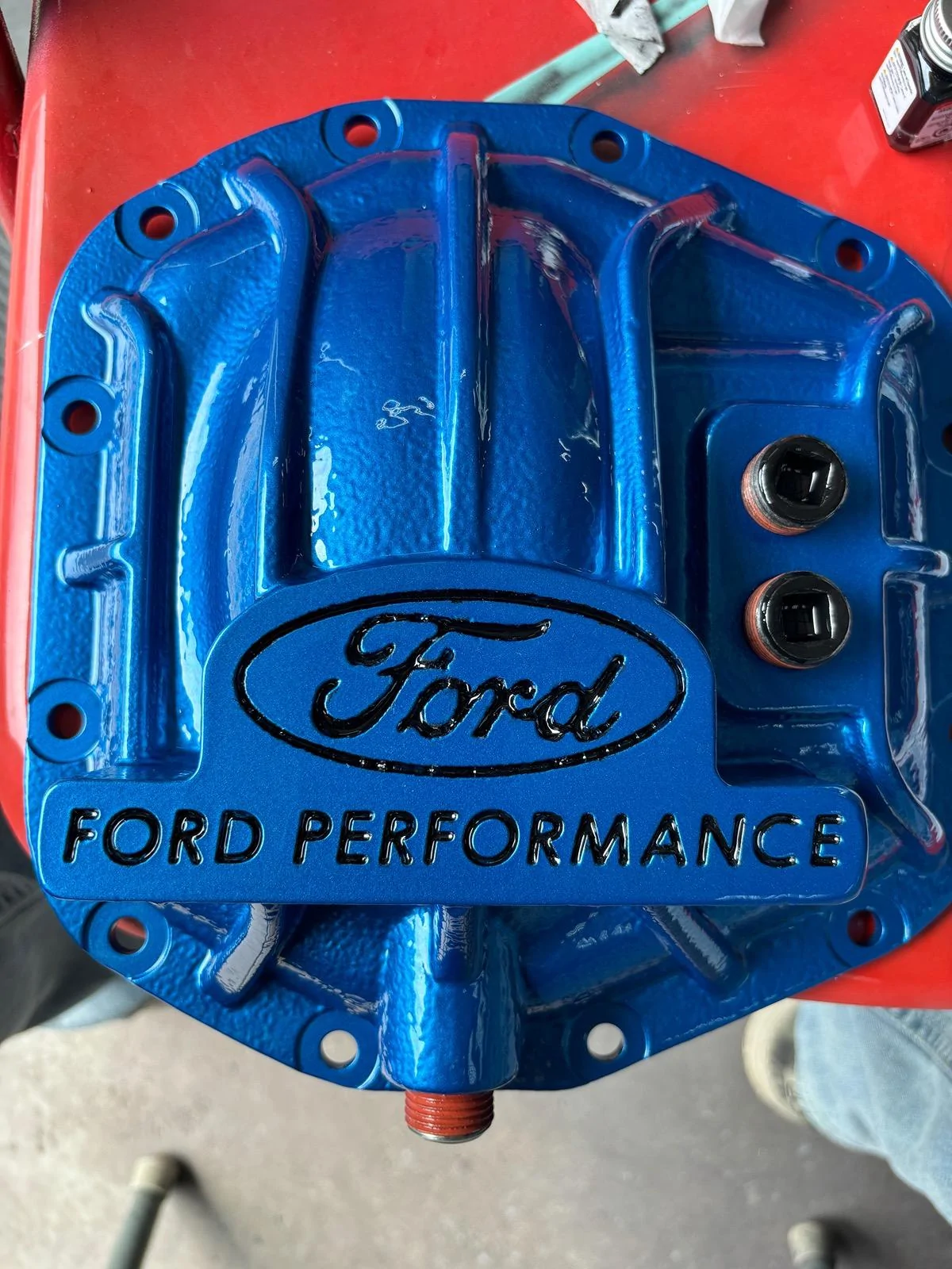

Very informative thread! I am hoping for some clarification, as there seemed to be a lot of opinions. I have the FP rear diff cover, and would like to re-use the OE gasket to avoid using gasket goop on the FP fiber one. Has anyone been able to re-use the OEM bolts or the new FP bolts with this combination? Want to make sure I have everything readily available once I go and pull it off.
After reading through the thread, I've started wondering if I should get a cheaper oil to run through to clean it for a few miles & "rinse" the gears before I put in my more pricey Amsoil. Thoughts? My Bronco has 25k and this will be the first diff oil change. I have no issue spending a few bucks on oil if this is a smart decision, especially since the oil change will be much easier with this cover.
Can't wait to see this baby under there!
CarbonSteel gives his advice on the gasket and bolts earlier in this thread, and there was just a discussion on this topic in this other thread, where he linked his suggested replacement bolts. Other owners have had success using the original bolts, so it just comes down to whose advice you want to follow...

The paint job your diff cover looks great!
https://www.bronco6g.com/forum/thre...tial-cover-installed-impressions.94273/page-8
Thank you! That thread/page does show many used the OE gasket & FP bolts successfully. Thank you! This thread had so much information my mind was spinning a bit. I must have missed that info in that thread. Will also consider the 25mm bolts as well.. Just wanted to know if I *NEEDED* to order more pieces.
Thanks a friend/forum member did a wonderful job. It's factory matched Velocity Blue :)
Edit: this was helpful. Not much of an expense for the knowledge the bite will be good enough for the threads. Just went ahead and ordered.

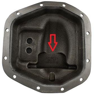

Would not the giant interior pocket on the FP cover, where the logo and drain is located, cause a lot of turbulence which then could lead to aeration of the fluid? Just seems to be a bad design IMHO.
You have to remember that you have two gears turning at 90° under high shearing forces. The oil can do nothing but aerate and generate foam. Most high-performance gear oils have anti-foaming agents added to reduce this situation.
Take a look at the axle linked below and note how aerated the oil is as well as the viscous coupling that is formed with the oil and this is with a "normal" contoured cover. There is a pattern that is more or less universally created in all axles and thus the pocket in the FP cover will not contribute to increasing that aeration in any shape or form.
Rear Axle Operating With Clear Cover
Definitely will increase drag on the fluid with the sharp corners and pocket. That's been tested and proven by Banks.
LOL...Banks created his own testing methods and his own data with NO third party validation. Banks did nothing but create a massive sales pitch for his new axle cover. I would love to see the drag numbers which are created that are measurable and verifiable AND actually mean something.
Using those methodologies, I can prove anything...
