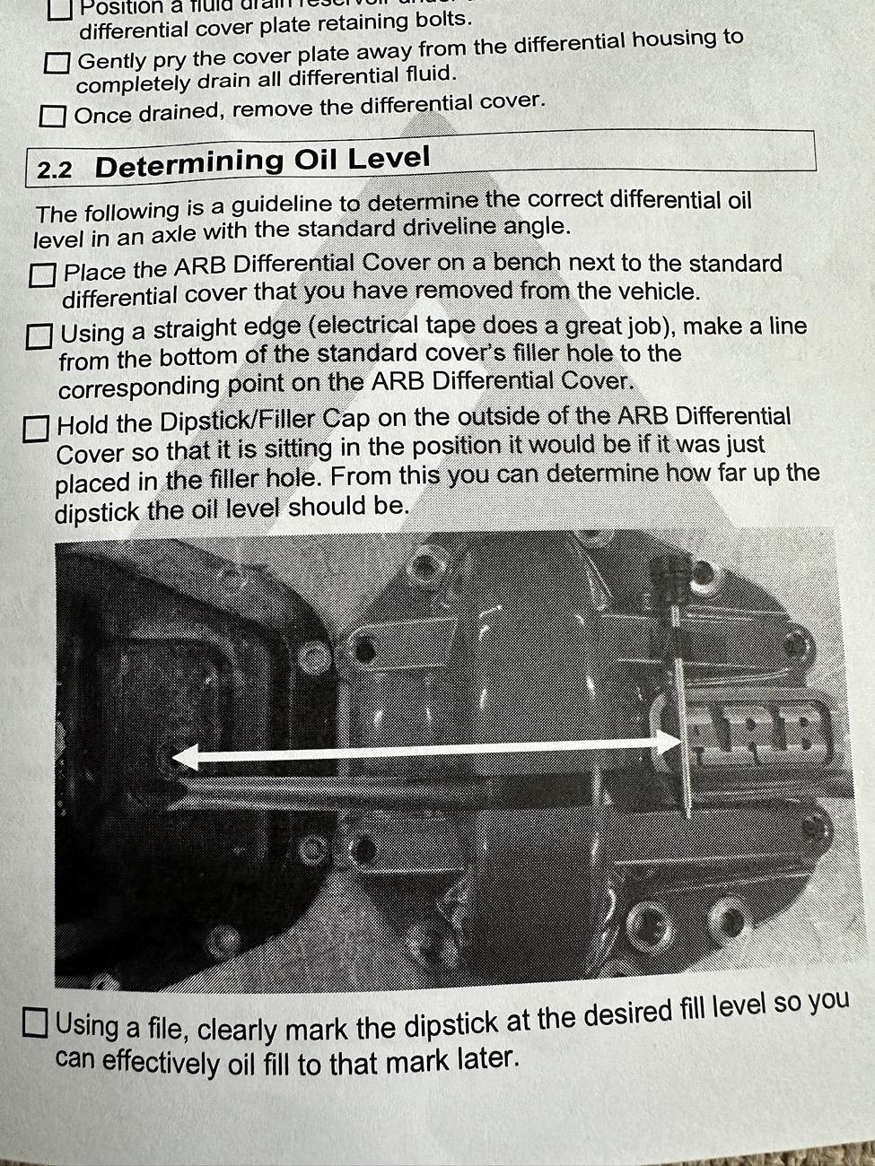

I took today to complete front differential, transfer case, and rear differential fluid change at 4700 miles. As others have reported, I too found the rear differential in need of fresh lubricant. Replaced transfer case fluid with Motorcraft Mercon LV and both differentials with Valvoline synthetic 75W-90 fluid in flex packs. Additionally, I replaced the rear differential cover with the ARB unit ($177 shipped from Extreme Terrain) allowing for ease of future fluid changes. Love the magnetic dipstick and ease of filling the diff with fresh fluid using the flex packs.. Also the magnet on the drain plug is a beast!
I put the ARB on also, to get some more strength in the axle line.
As for fill level, are you using the dipstick for reference? To me I’m trying to set a mark that is top of the axle, but I’m curious what you think.

Yes, the cover will definitely provide added strength and I'm using the dipstick after first scribing a line on the dipstick that corresponds to the appropriate stock fluid level. I followed the guideline in the ARB installation sheet to align both covers first.
After installation and filling the differential, I used approximately 1.9 quarts of fluid. Your measurement may be slightly different but in my case the scribed line on the dipstick is 3 3/16” from base of the dipstick knob and 1” from the dipstick tip keeping in mind that when checking the fluid level you DO NOT screw the dipstick back in but rather place it in the opening to a point where the threads just touch... this per the install sheet.

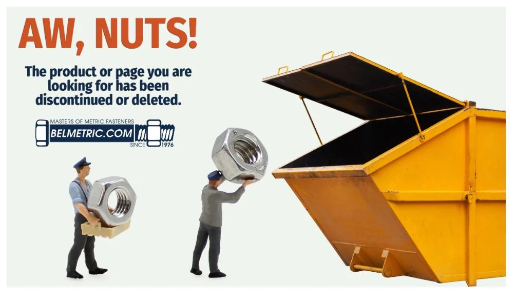

The whole list. It’s weird. The stud link works - but only has zinc or black. All other links say “Aw Nuts”. Clever. Haha.

Updated the first page to make it easier to find, updated all links, and tagged you in it...
