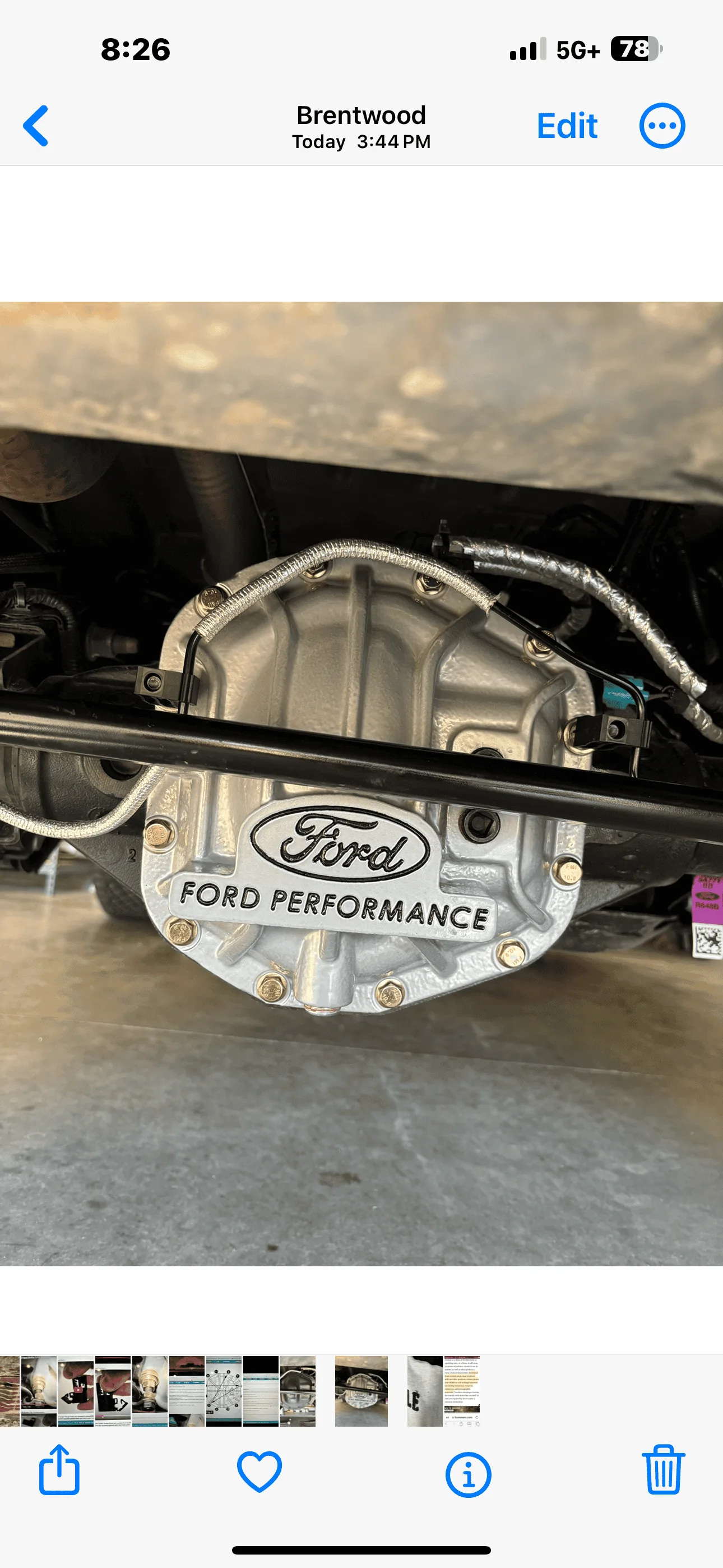

I changed the fluids in all 3 yesterday. CarbonSteel was an excellent resource and help. I really appreciate you CarbonSteel and the contributions you have made to the thread and forum at large. Everything went textbook because of the detailed write ups and videos. I was able to easily remove and reuse the plastic brake clips because of the detailed explanations. My fluid looked okay. The rear differential fluid was the darkest. There was no magnet on the drain plug to the transfer case. I am not sure if that is normal or a mistake during my build. This is something anyone can do if they have the right tools and a few hours. Read and watch all the videos you can first. It will save you time and money in the long run.

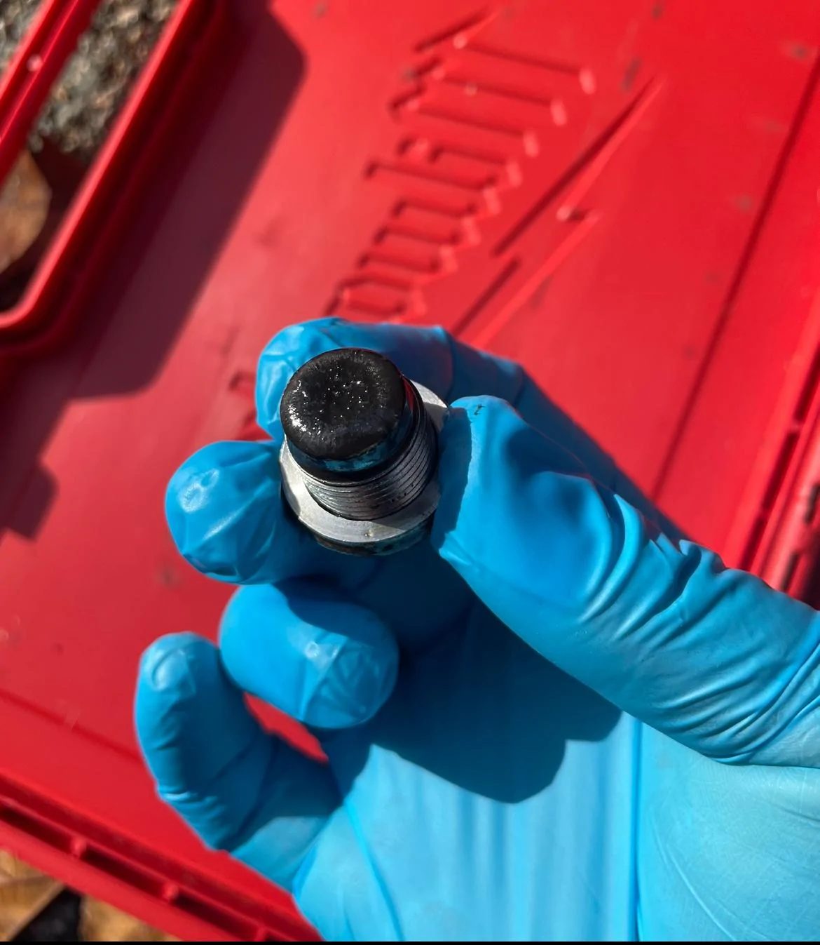

Please beware...my transfer case drain plug did not have a magnet. The drain plug was identical to the fill plug. CarbonSteel has confirmed the drain plug should have a magnet. This is another reason to drain your fluids early. I will now order a drain plug with a magnet and change the fluid again.

They must’ve changed the plug at some point. The majority of the ones I’ve seen, do not come with a magnetic plug. Mine didn’t have one either. Like yours, the fill and drain were identical.

Perhaps it’s just a difference between 4A and Part-Time?
Mine had a magnet. June 2021 build, part-time 4x4.

I considered that also. But @CarbonSteel has a Wildtrak just like me, so we both have the advanced transfer case. Yet his had a magnet and mine did not 🤷‍♂️
I am not sure if that is by design? Maybe it has to do with supply constraints? I will call my dealership tomorrow to inquire. I have not been able to find the OEM drain plug anywhere online.

I looked through the ford parts catalog and I cannot find the advanced transfer case drain or fill plug anywhere in the diagrams. So it’s hard to say if something was changed.
The only one I can find is for the part time transfer case which is completely different.

Are you just going to leave it as is or try to get a plug with a magnet? I like the idea of a magnet taking out what metal it can collect.
