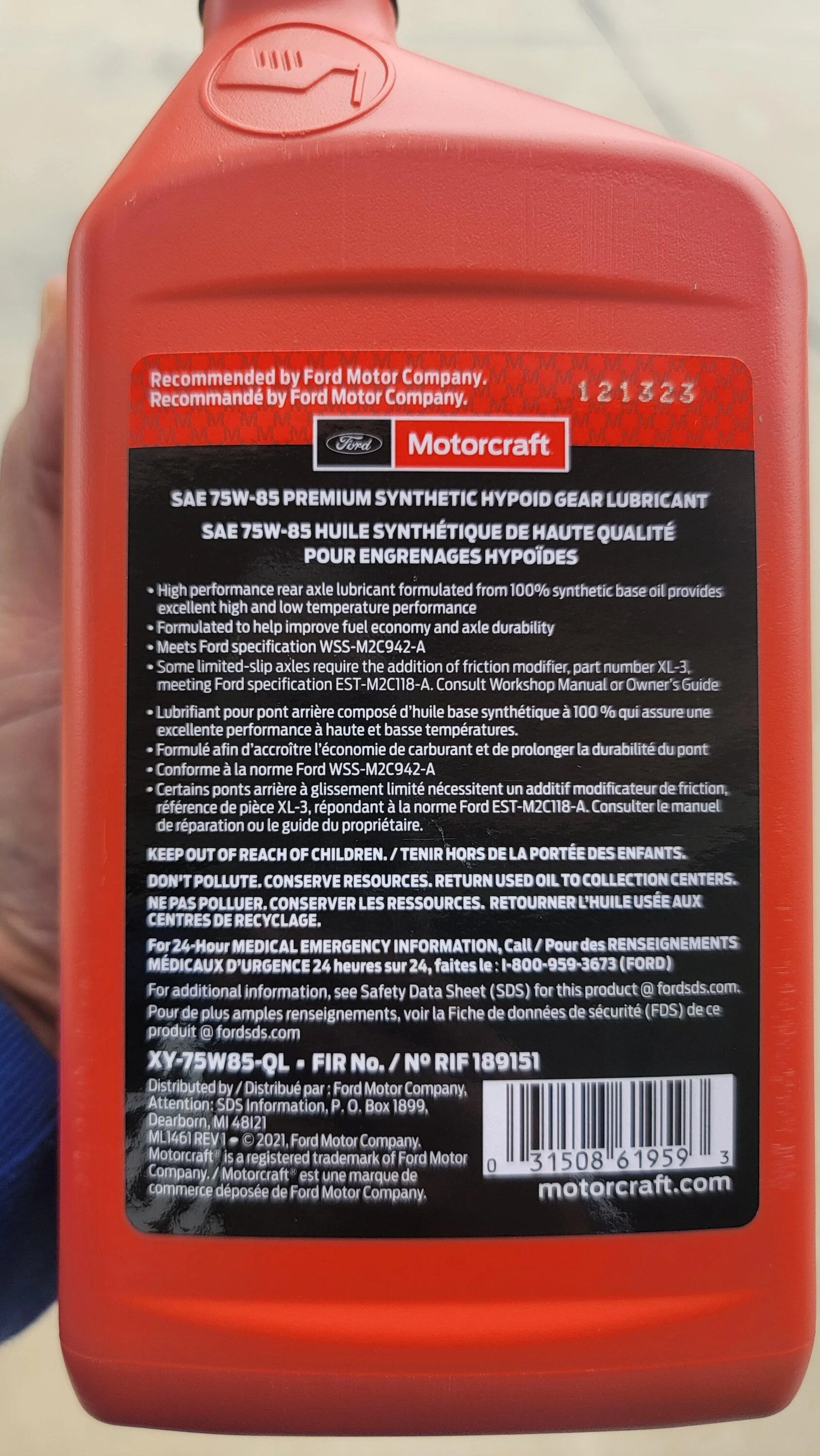

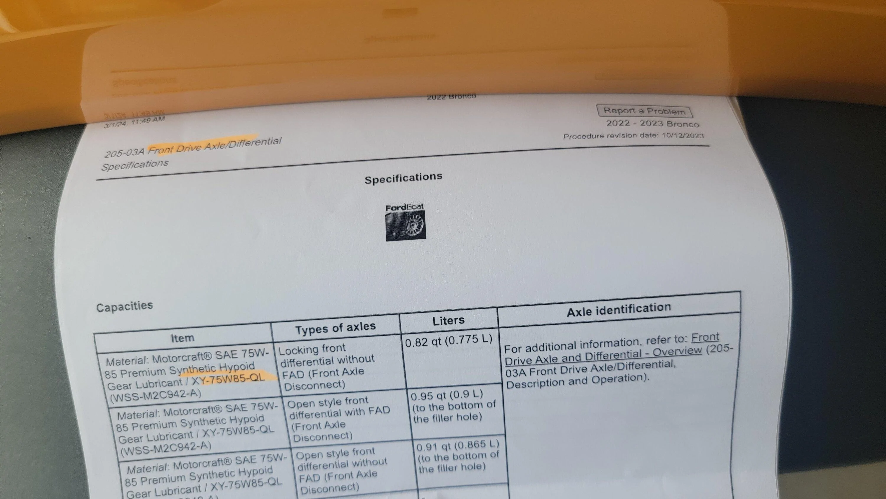

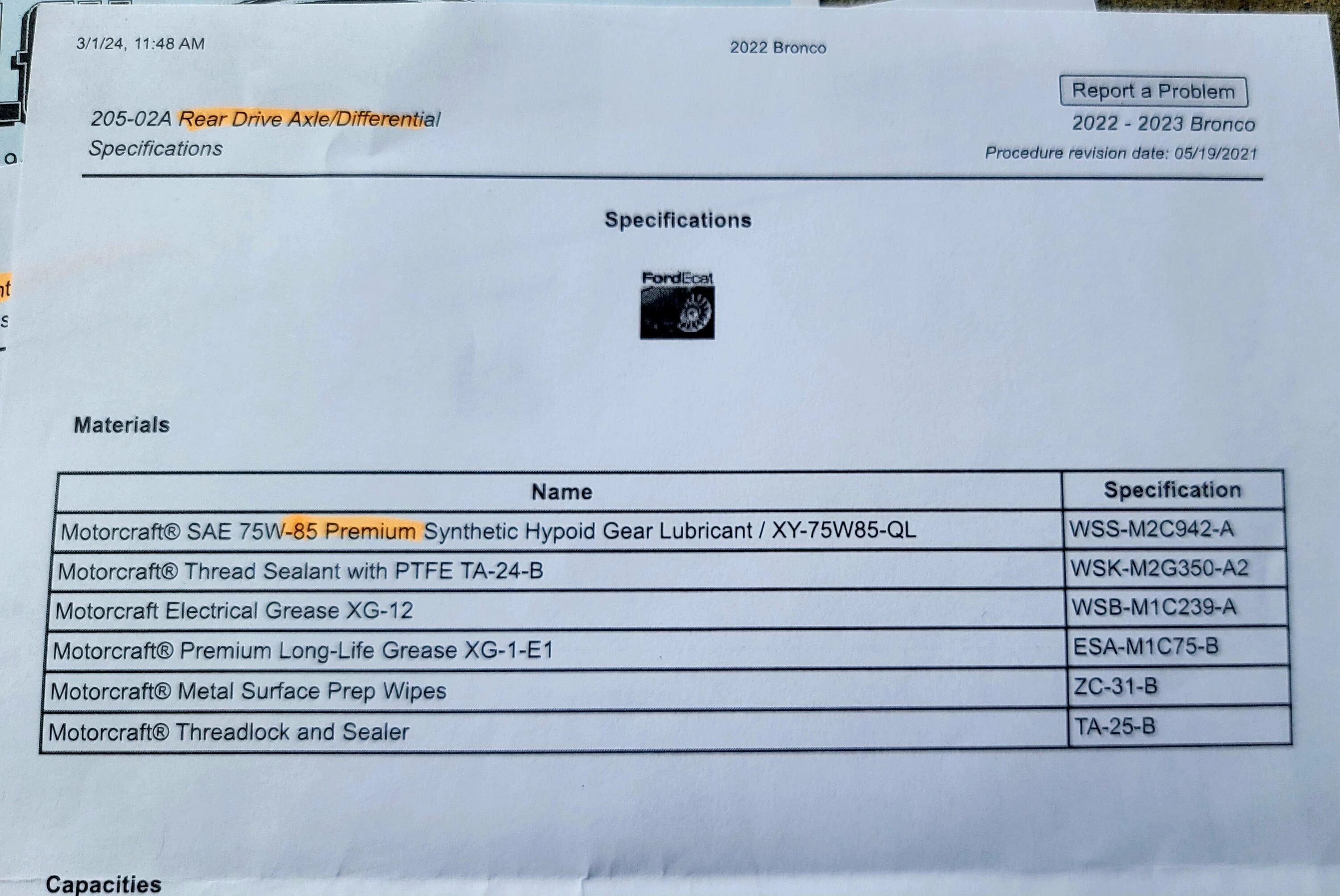

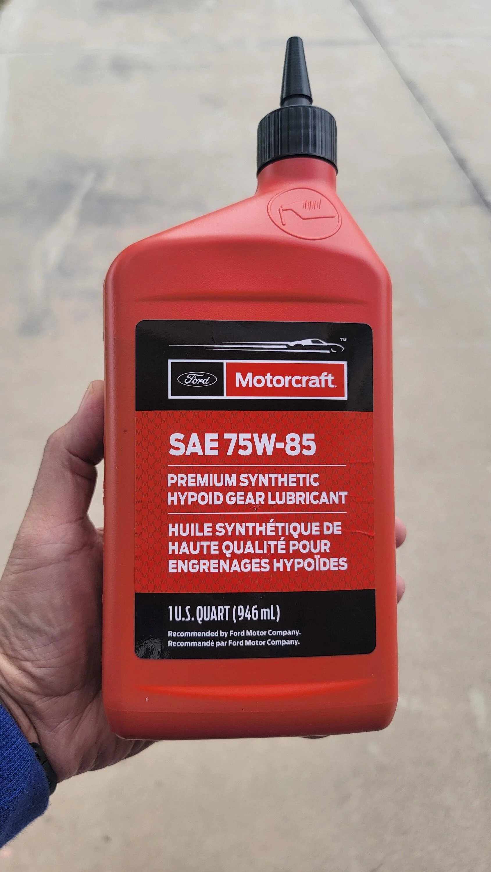

Hello Bronco brothers,
So today I stopped by a Ford dealer to purchase front and rear diff oil, I was giving the parts guy the number for both oils, he asked for the VIN# then he told me that according to his computer data and my VIN that the front and rear oil are the same. Asked him for a print out of such data. I guess Ford has made updates... it was pricy.
He seemed confuse as to why I wanted to change the oil so soon, at 15k Miles.
Ford Bronco Change Driveline Fluids Early! 1000005736
Ford Bronco Change Driveline Fluids Early! 1000005737
Would love to see a VOA of the oil to see a number data points...
