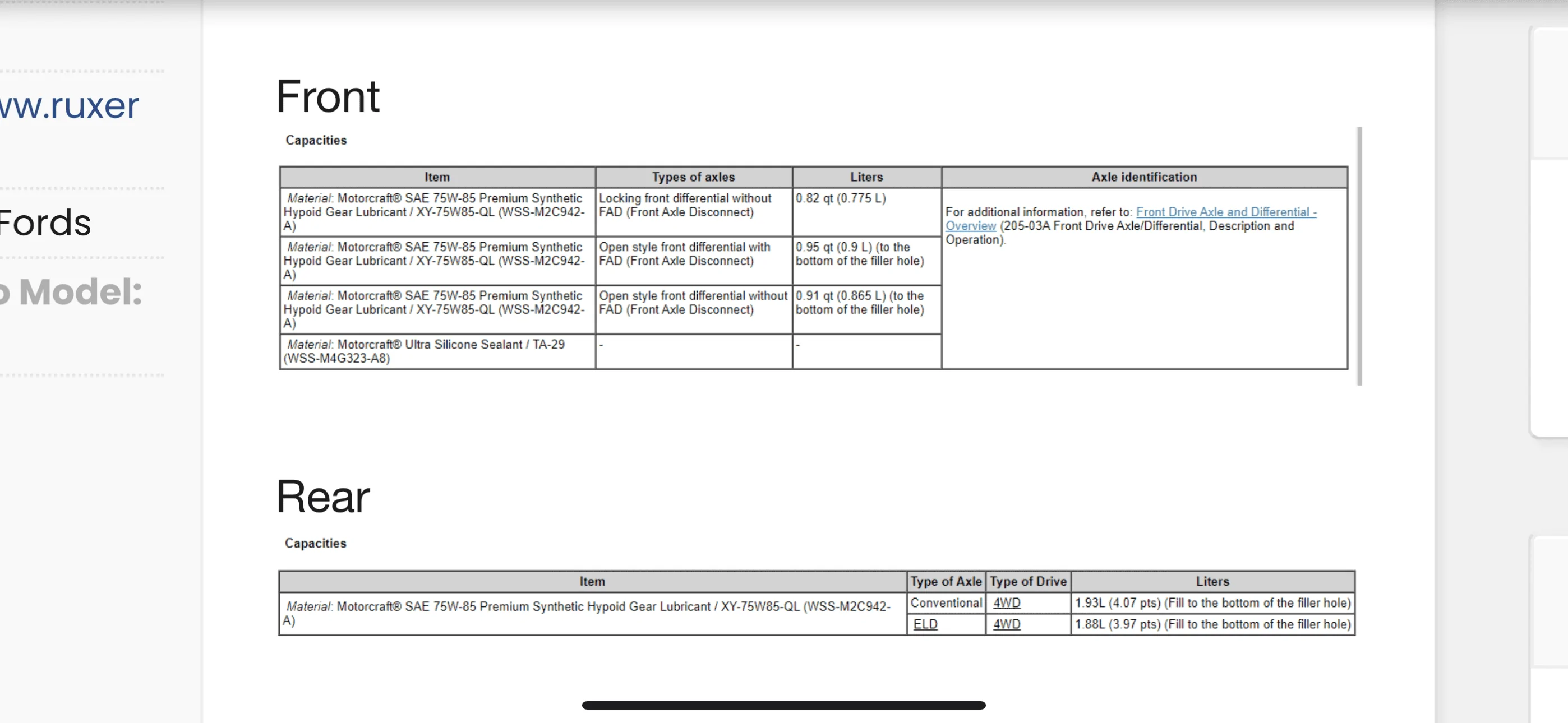

If you are sticking with OEM gear oil, please note that there is a discrepancy and change between the 2023 and 2024 owners manual as it relates to the front differential gear oil.
In the 2023 owner manual, there were two different oils recommended, one for the front and a different for the rear.
In the 2024 owners manual, the recommended gear oil is the same for both the front and rear.

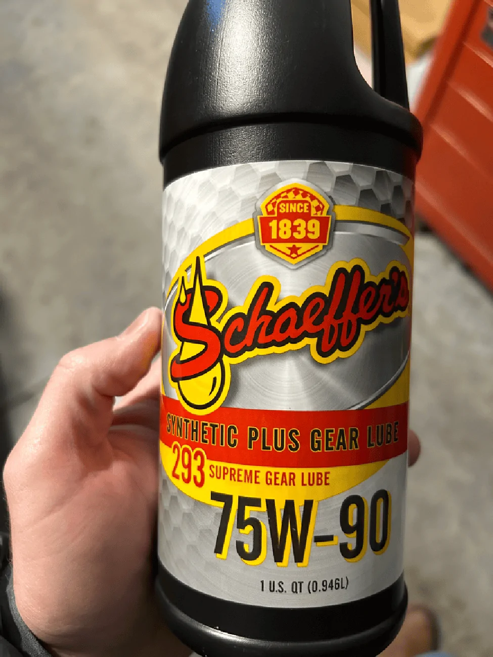

I'm starting to pull together my list for my driveline fluids.
I fall in the severe use category. I am located in cold/snow country and my Bronco on a normal winter will spend 2-3 months regularly in 4H. I tow 3000 lbs frequently- around 2000-3000 miles per year. I use 4L frequently (probably weekly) during the summer to save on the clutch when pulling my boat up steep and slippery boat landings.
I did an initial fluid change on the manual transmission just after break in at about 2000 miles and was glad I did (due to the amount of metal that drained from the Manual transmission). I have 21,000 miles on BG Synchro Shift II and it has been an excellent fluid even in the cold weather. It's a very smooth shifting lube regardless of temperature, and I will be using it again on this swap.
I'll likely use Mercon LV or Pennzoil Platinum LV in the transfer case.
Given my use case in these Dana 44 Advantek differentials, what is everyone's thoughts on viscosity? Given my towing, I am thinking that heavier weight would give me an increased buffer of protection. But, also knowing that I live in an area that can easily see -20F during the winter, I am a bit skittish about 75w140 up here. I am thinking that a 75W110 premium synthetic would be the ideal compromise? Thoughts?

I wouldn't over think it, syn 75w90 will be fine..
