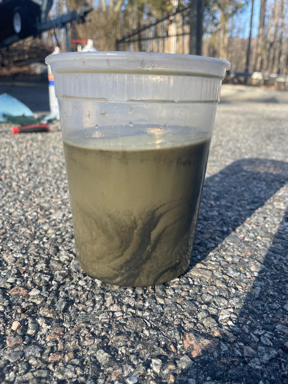

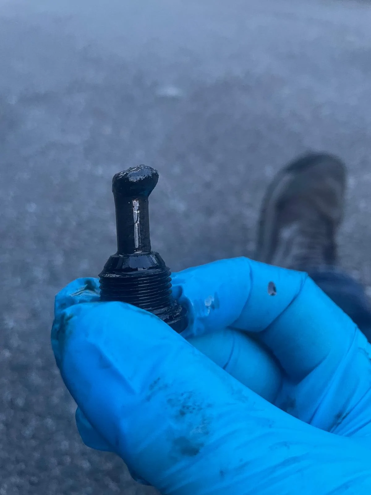

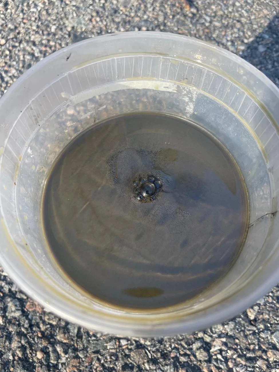

Really wish I got to to the front diff before 33k, but - whatcha gonna do? I’ll likely upgrade to 4.7 or 5.13 eventually anyhow.
Very metallic. Replaced it with Amsoil 75W110. I did the rear at 23k and I don’t remember it being nearly this bad. I’m gonna dump the rear as well (10k interval) and see how it looks.
Ouch. That is pretty bad, but the good news is that you changed it. That is more than many do...what with that lifetime fill and all...

And to think that some folks are still skeptical......
They are likely remembering the "good old days" where you could change the axle fluid at 100K miles and call it good for another 100K.
The Dana Advantek axles generate more wear metals and for a longer period time than any other axle I have ever owned or maintained.
The D44 under my retired Wrangler produced more iron in 26K miles than the Ford F-150 FX4 9.75" axle did in 160K and 45% of those miles were towing heavy (8000-9000 pounds).
Dana = 2163 and Ford = 697.
The photo is 100% indicative of that...

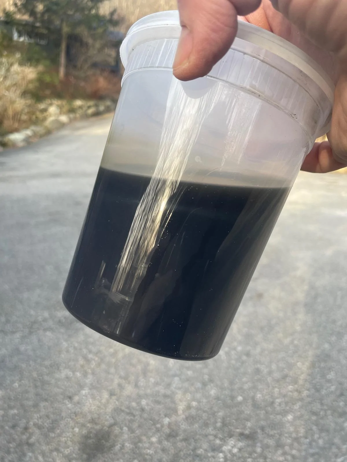

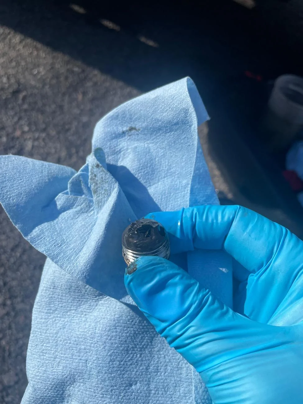

At 33k with 10k and 10 months (Motorcraft 75W-85) and the ARB cover.
Pretty damn dark fluid - looks like motor oil. Lots of metal on the magnets and wiped out even more from the drain hole that collected after the drain. Refilled with Amsoil 75W-140.
