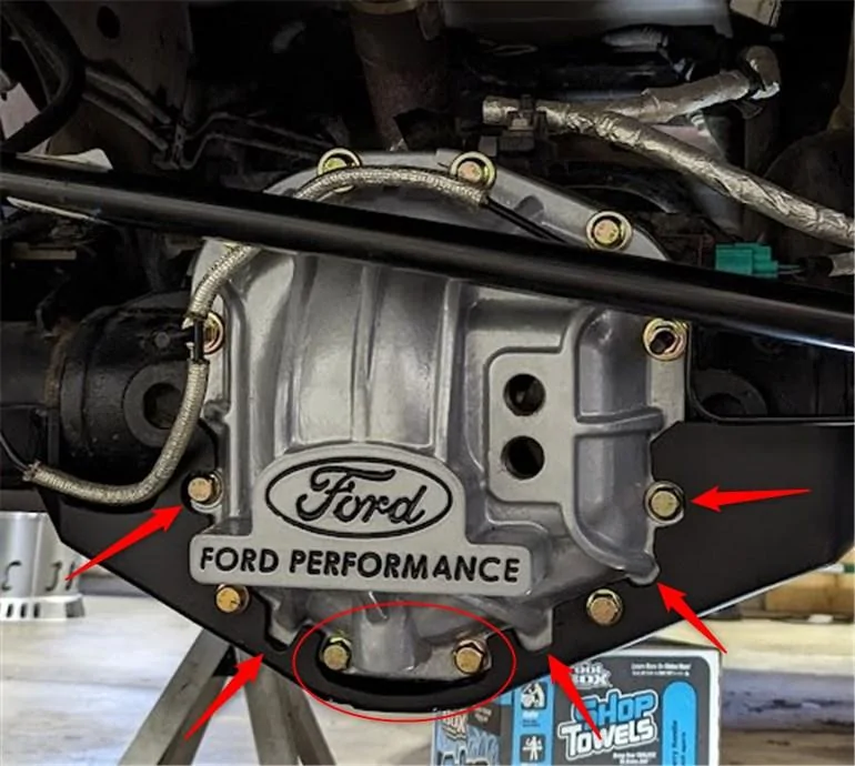

There is enough room to access the drain without cutting into the plate.
Here are all the areas that needed modification. The upper side holes should have been made a little bigger but once I got it up there, I wasn't going to bring it back down. All the ribs of the diff cover needed clearance on the skid plate. The area I have circled could have been much smaller but it turned out fine.
I was initially concerned about removing too much material and weakening it but as you know, it is a very strong and robust weldment. I have no concerns now.
Thx, very helpful. I will uninstall the skid plate and make the mods before I install the performance cover.

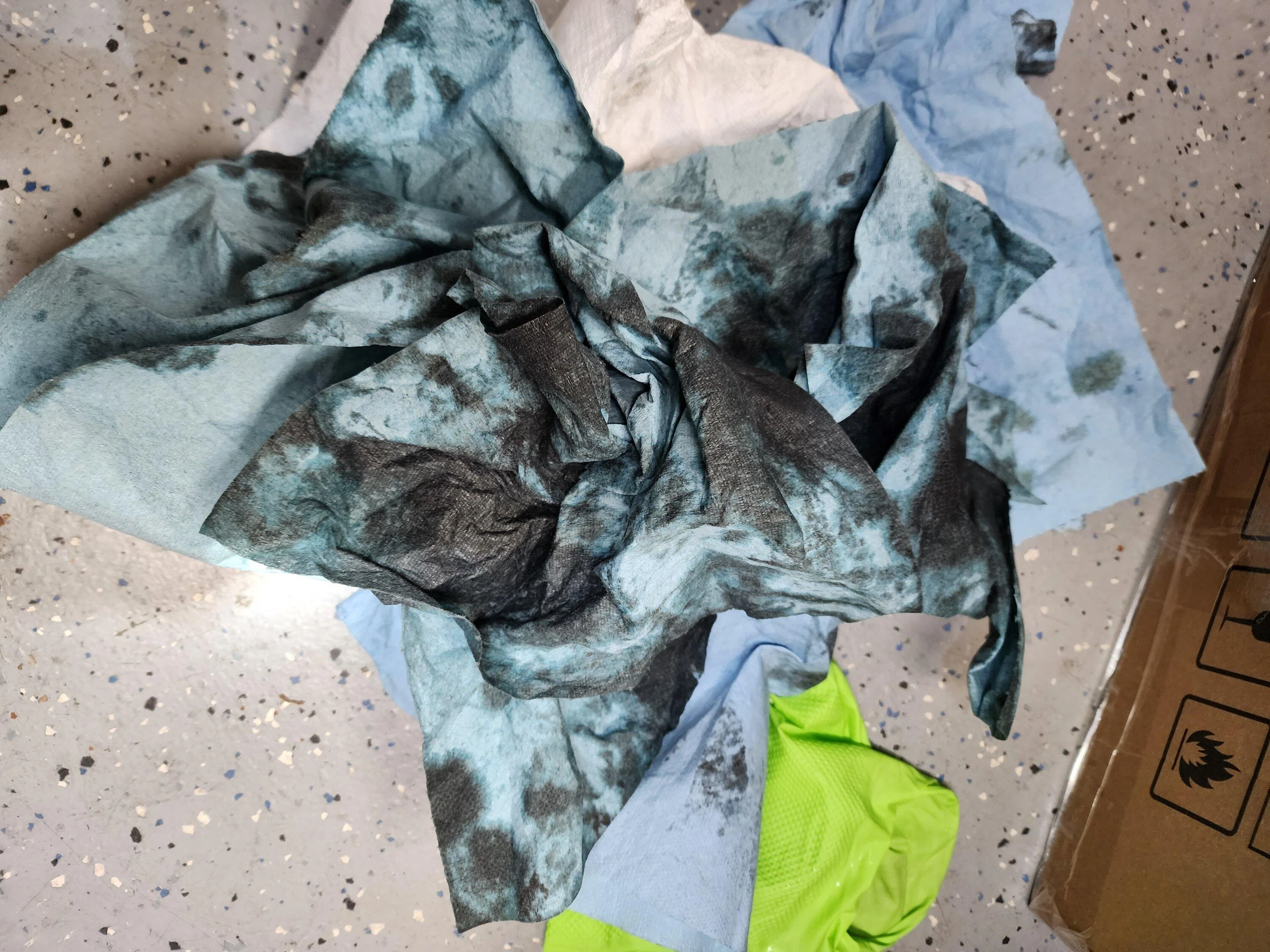

Video 4 - Inspection and Cavity Discussion -
Scott towel showing metal from cavity:
