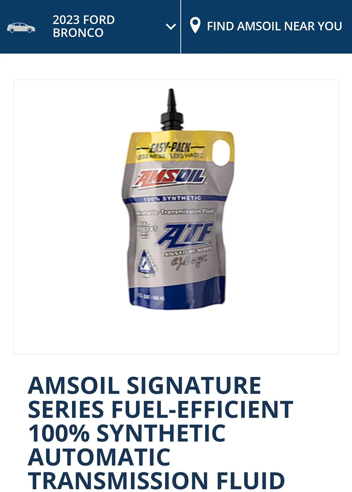

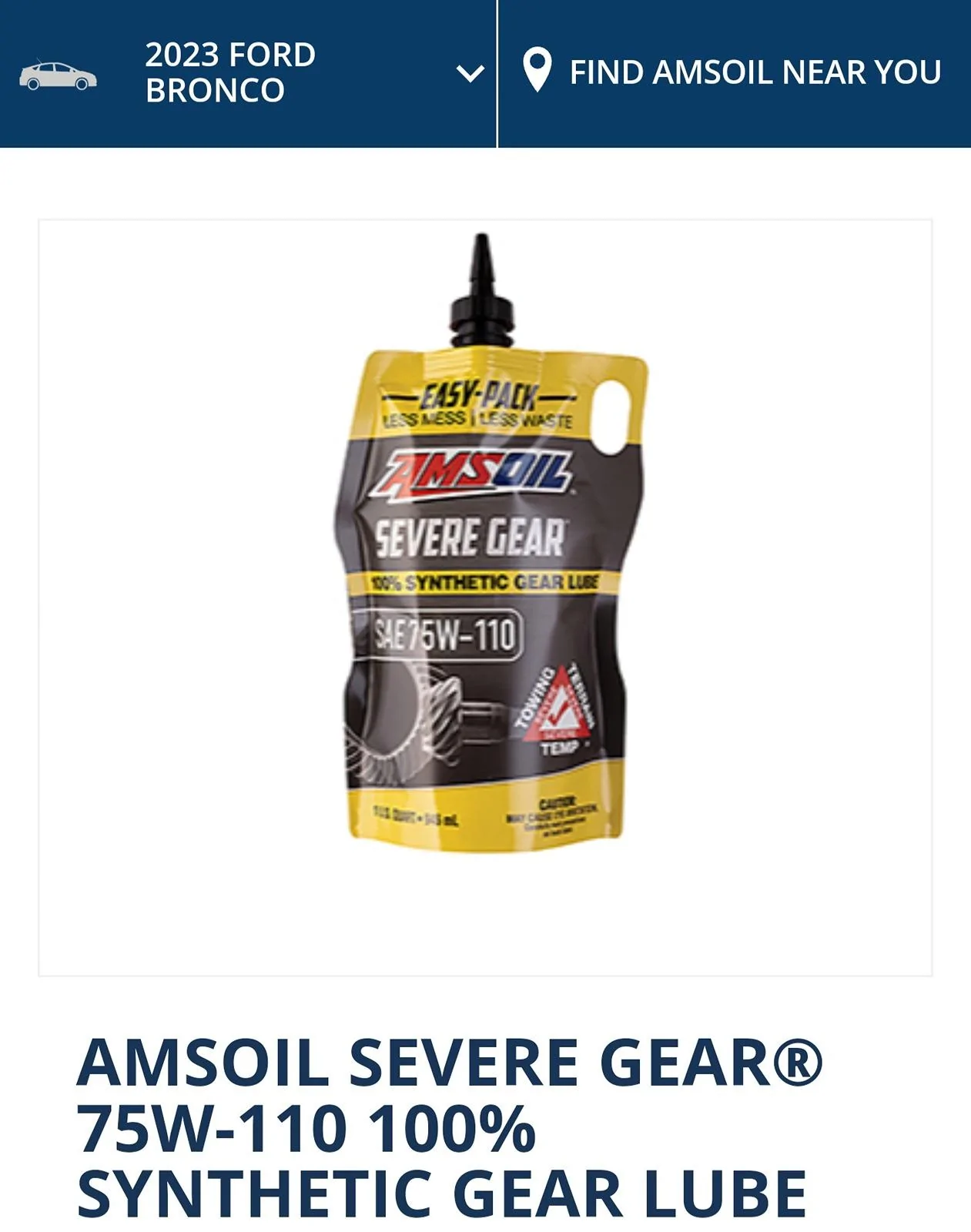

I changed the oil in the front/rear differential and replaced the fluid in the transfer case. Went with all Amsoil products. The quart easy bags are the way to go. No mess at all. Used 75w-110 in front and back and amsoil signature series ATF in the transfer case. My bronco is a 23 outerbanks sasquatch and I noticed that I didn't have a magnet on the drain plug for the transfer case. I installed the Ford Performance differential cover on the rear, so I just used the fill plug in the old differential cover and put it in the transfer case drain hole. Thanks to carbonsteel for all the great info. This has turned out to be one of the best Maintenance related threads on B6G.
