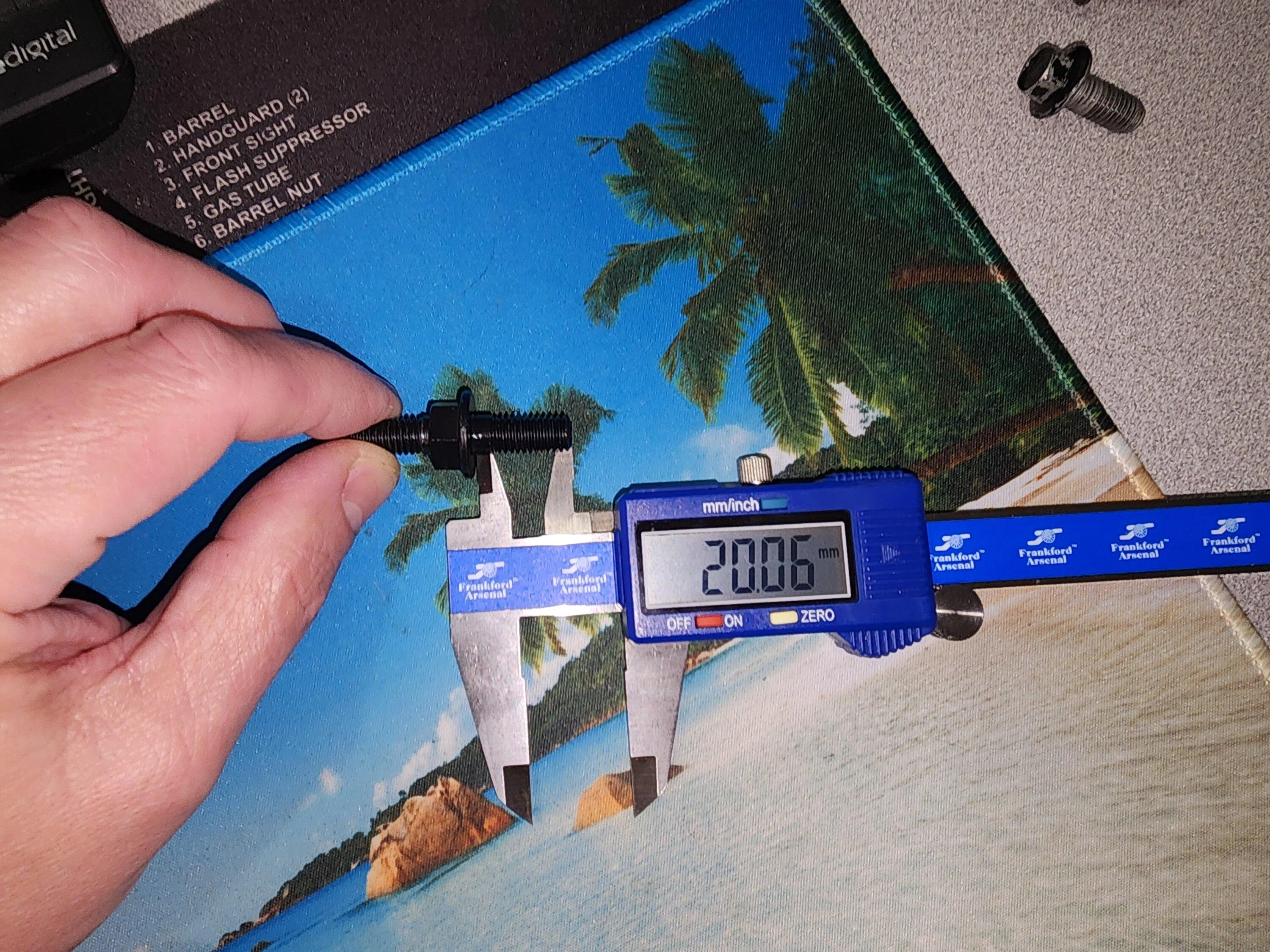

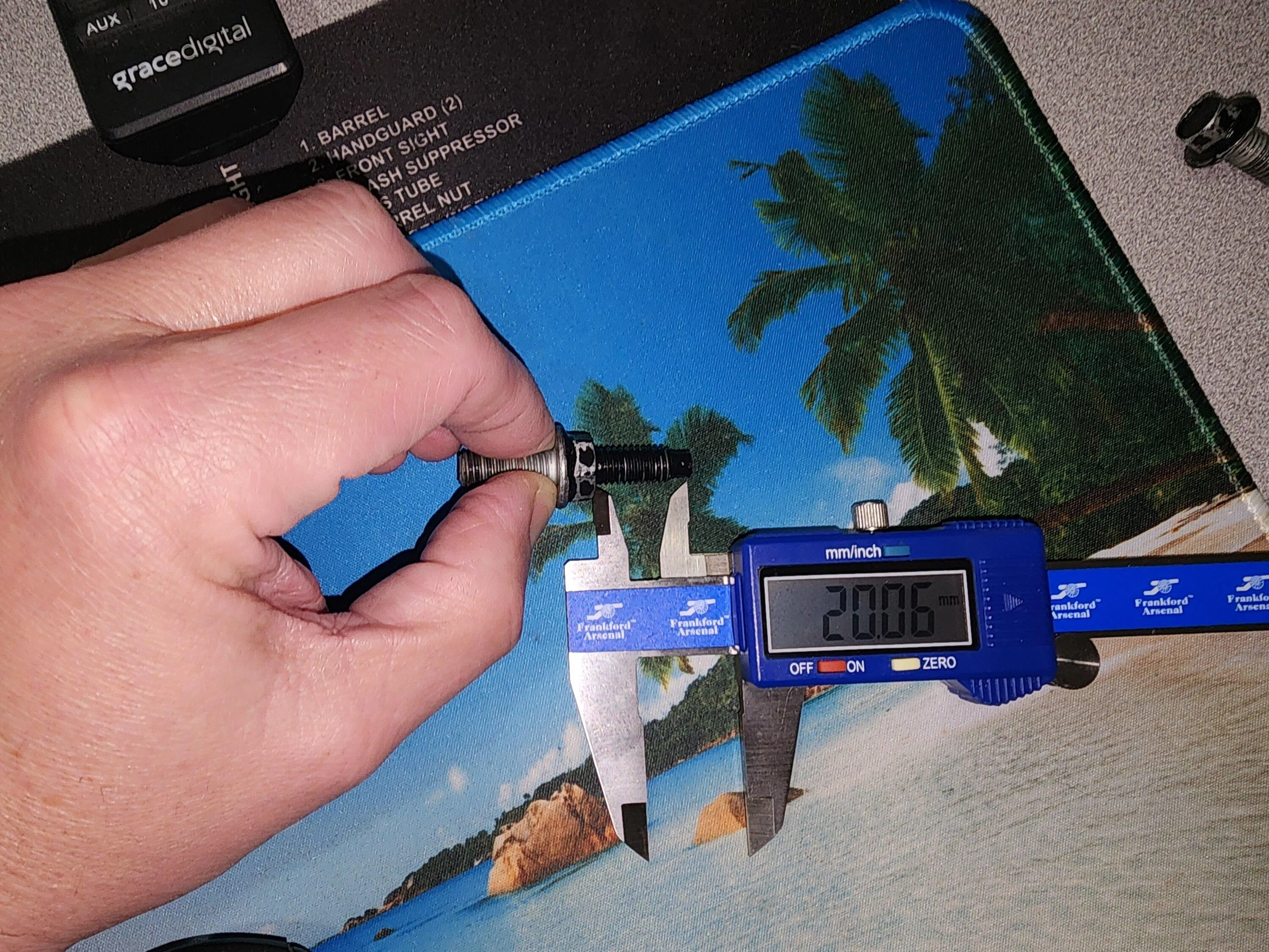

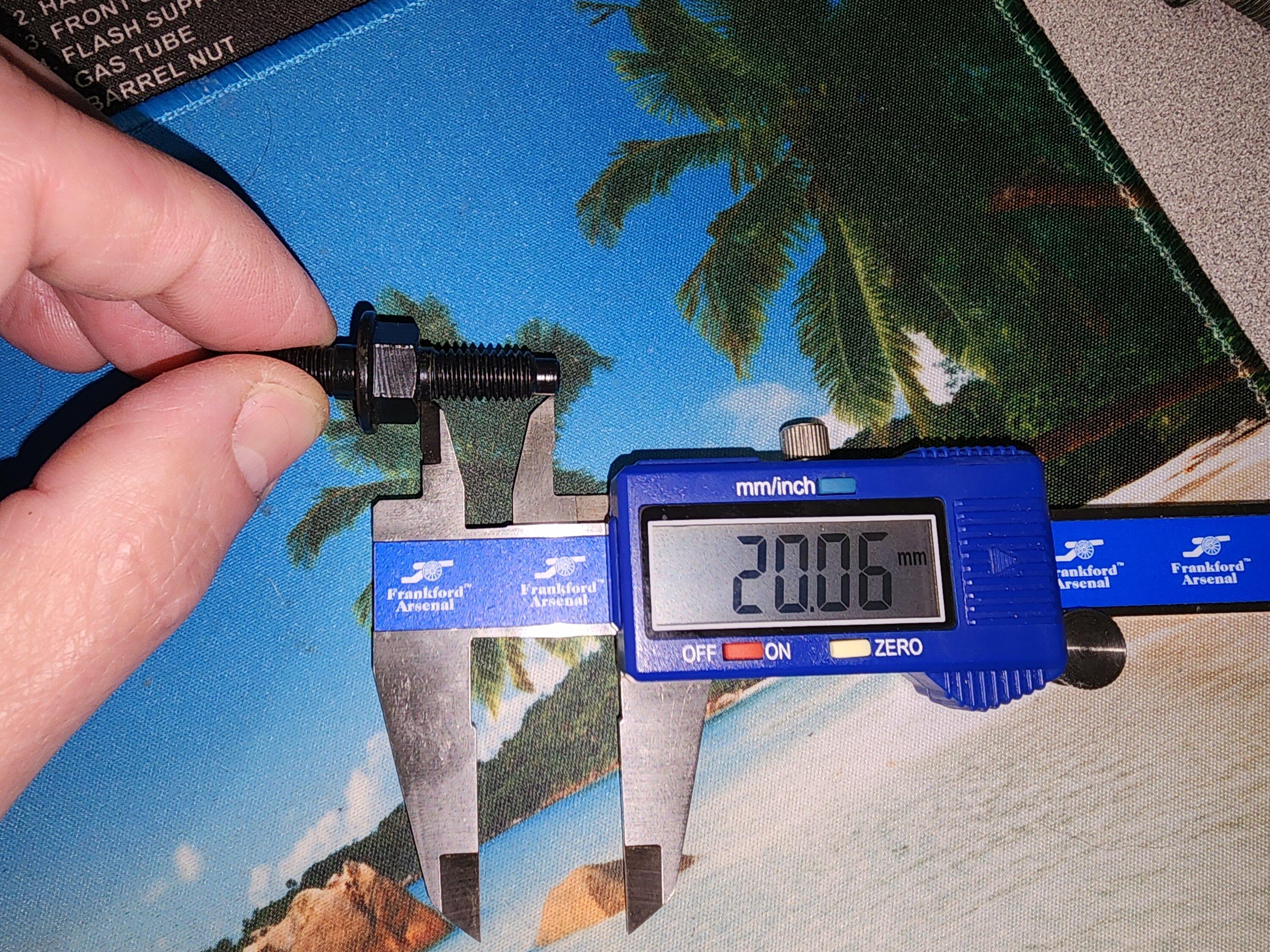

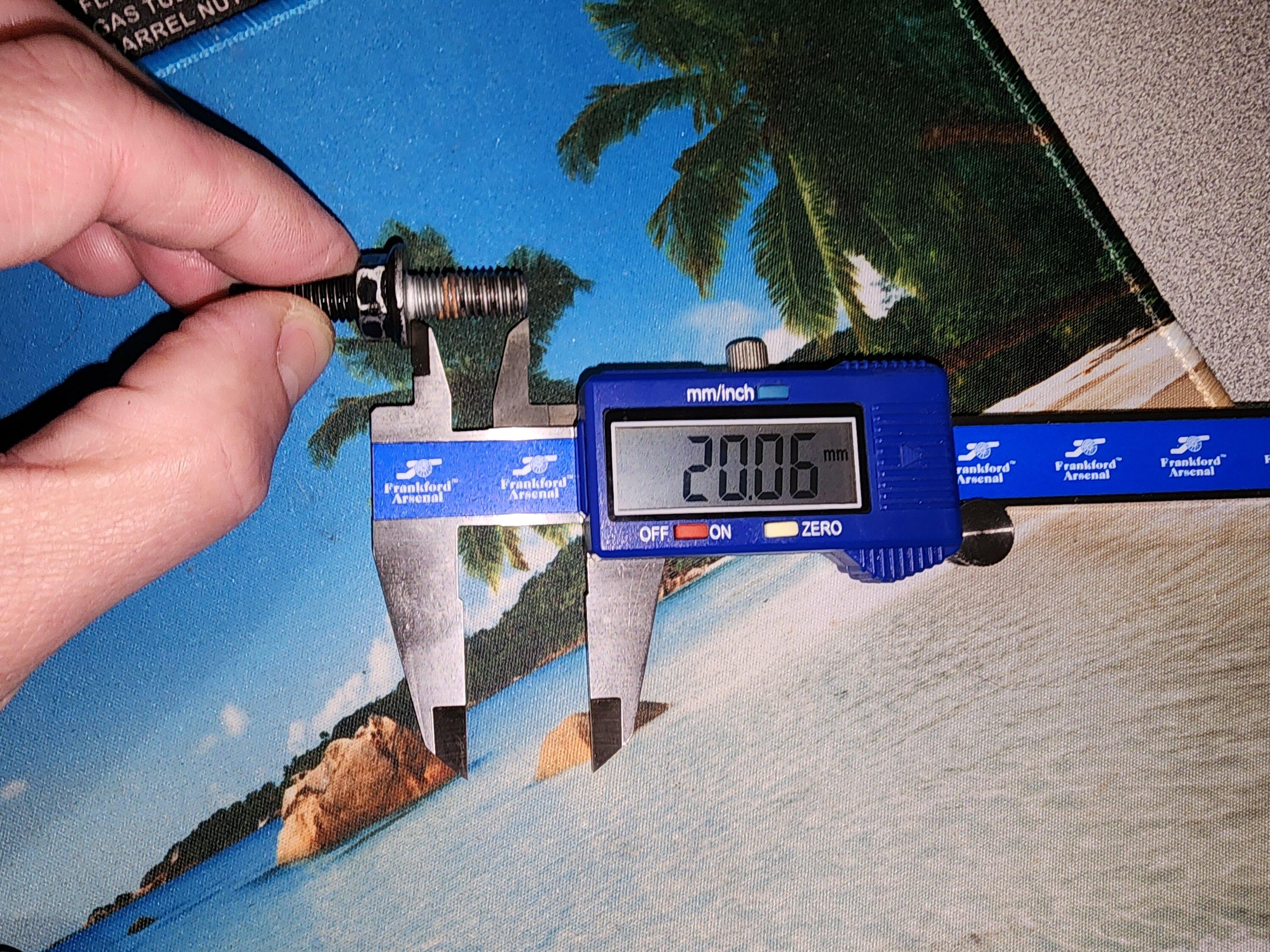

Original bolts and studs from the OEM cover or from the Ford Performance Cover? Note the threaded bosses in the rear axle housing are all 23MM deep. Whatever you decide to do, be sure that you have at least 16MM of thread engagement.
OEM Bolt:
Ford Bronco Change Driveline Fluids Early! OEM Bolt
OEM Stud Clip Side:
Ford Bronco Change Driveline Fluids Early! OEM Stud Clip Sid
OEM Stud Cover Side:
Ford Bronco Change Driveline Fluids Early! OEM Stud Cover Side
FP Bolt:
Ford Bronco Change Driveline Fluids Early! FP Bolt
FP Stud Clip Side:
Ford Bronco Change Driveline Fluids Early! FP Stud Clip Side
FP Stud Cover Side:
Ford Bronco Change Driveline Fluids Early! FP Stud Cover Sid

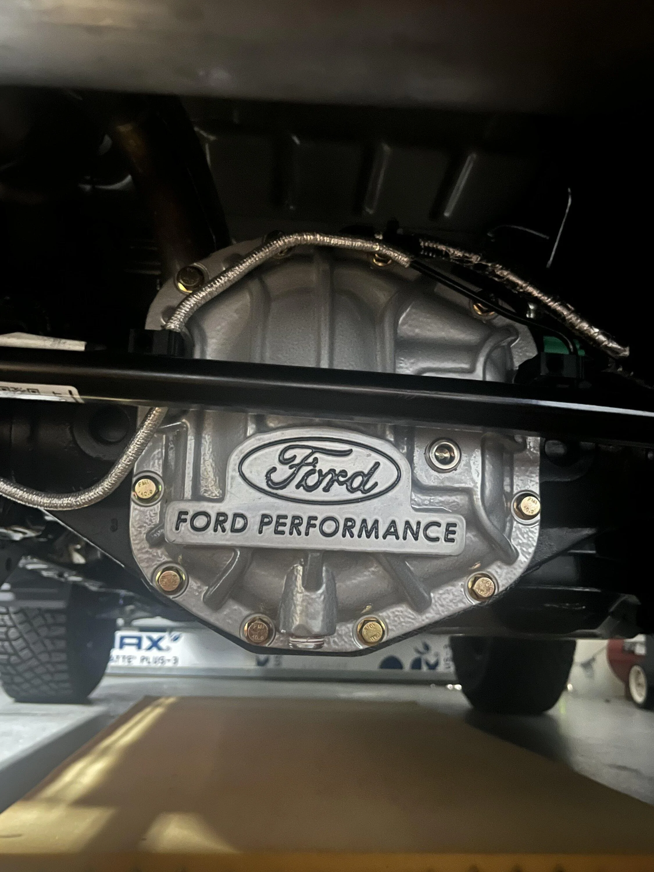

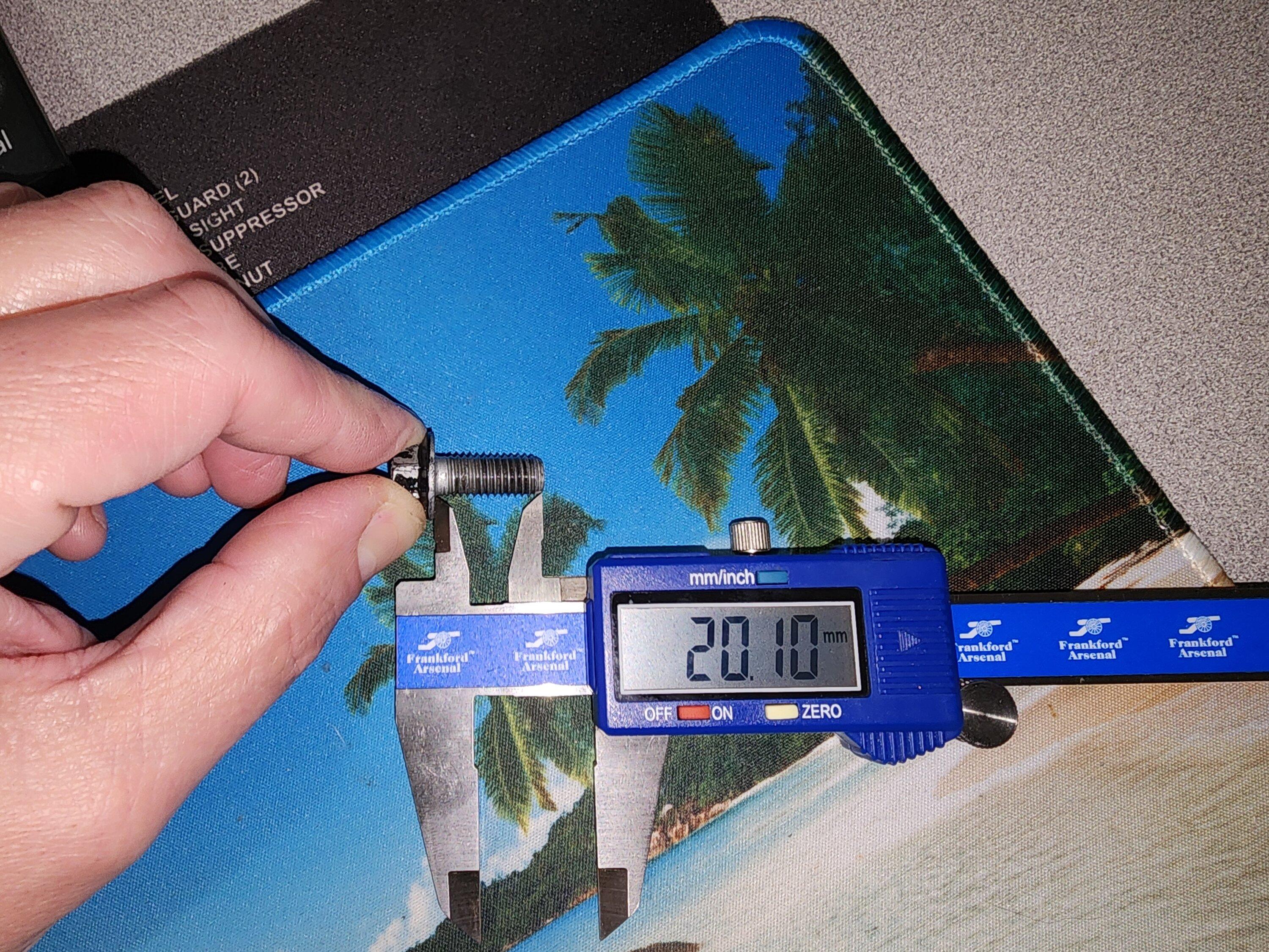

As "CarbonSteel" posted ,Belmetric hardware. I did find that the plastic clips removed very easy and not damaged . That said I did reuse them . Works well. Long term I did order the 75mm studs and locking nuts in case .Now complete diff and transfer case fluids changed at 2500 miles. Mercon LV and Amsoil products were used. I want to thank "CarbonSteel" for his in depth article on this topic. Well done!

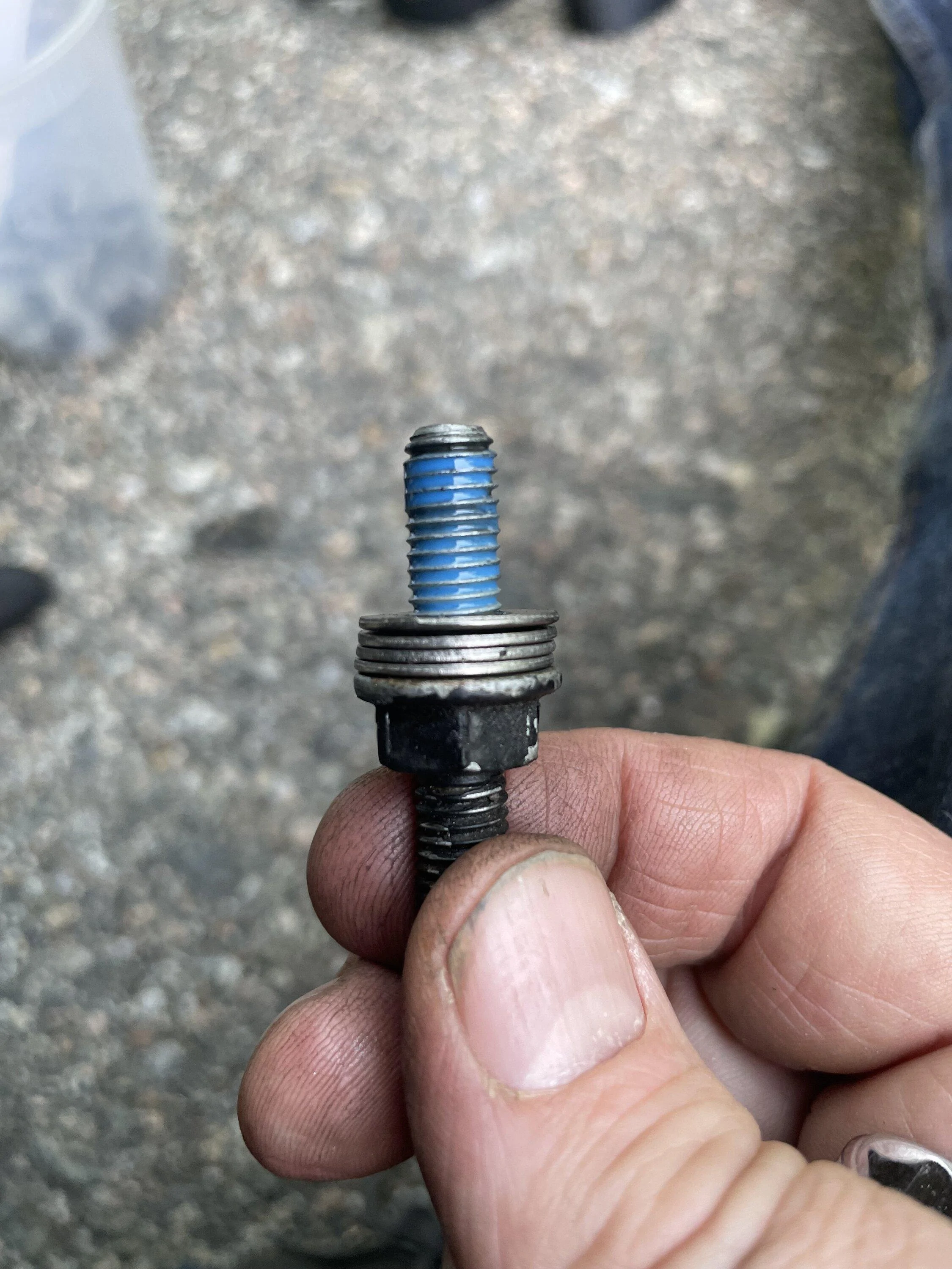

That has me wondering if this was enough…
That appears to be about 16MM (length with no washers would be about 20MM), but it is not accounting for the thickness of the cover or the gasket. You may have 5-7MM of engagement--maybe...
IMO, w/ the thread locker you'll be fine if you can get 6-8 full turns. On mine I just ground off the raised shoulder a bit until it would fit in the recess.
EDIT: I have the ARB, not FP
At 22 lb-ft or less, you **may** be ok, but anything more than that, you would be asking to strip the threaded boss.
I am doubtful that with the Ford Performance cover and the OEM gasket that you would have 6-8 turns of engagement on the stud shown with the washers.
That is about 16MM of thread, and you are going to lose another 8-9MM for the cover and gasket. The gasket does not compress much because it has steel inside it to prevent over torquing.
Proceed with caution...
