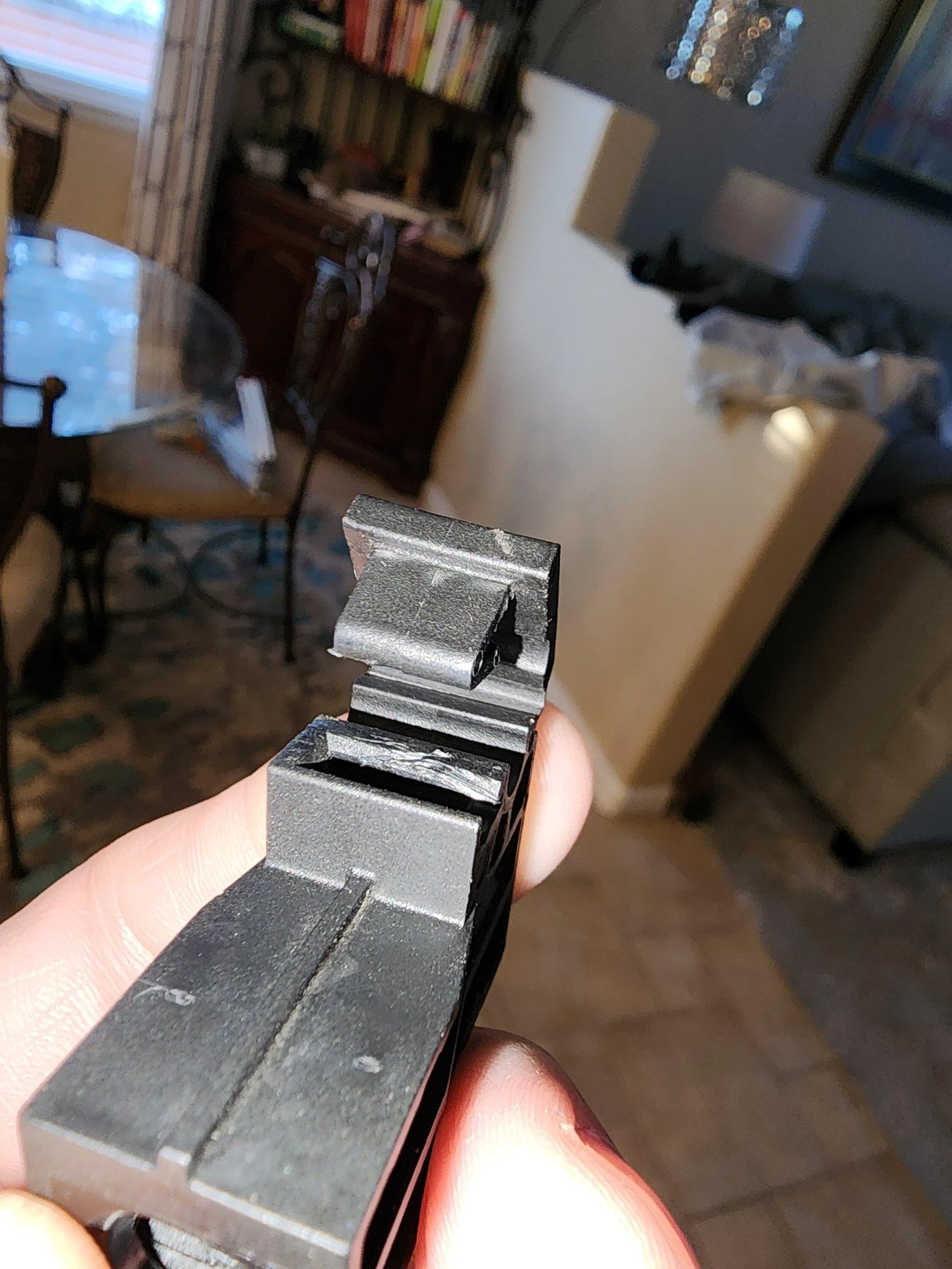

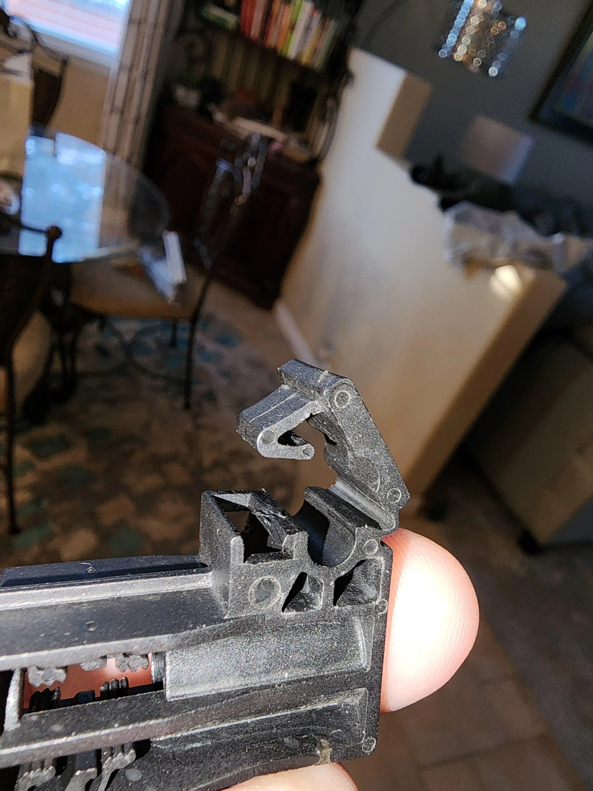

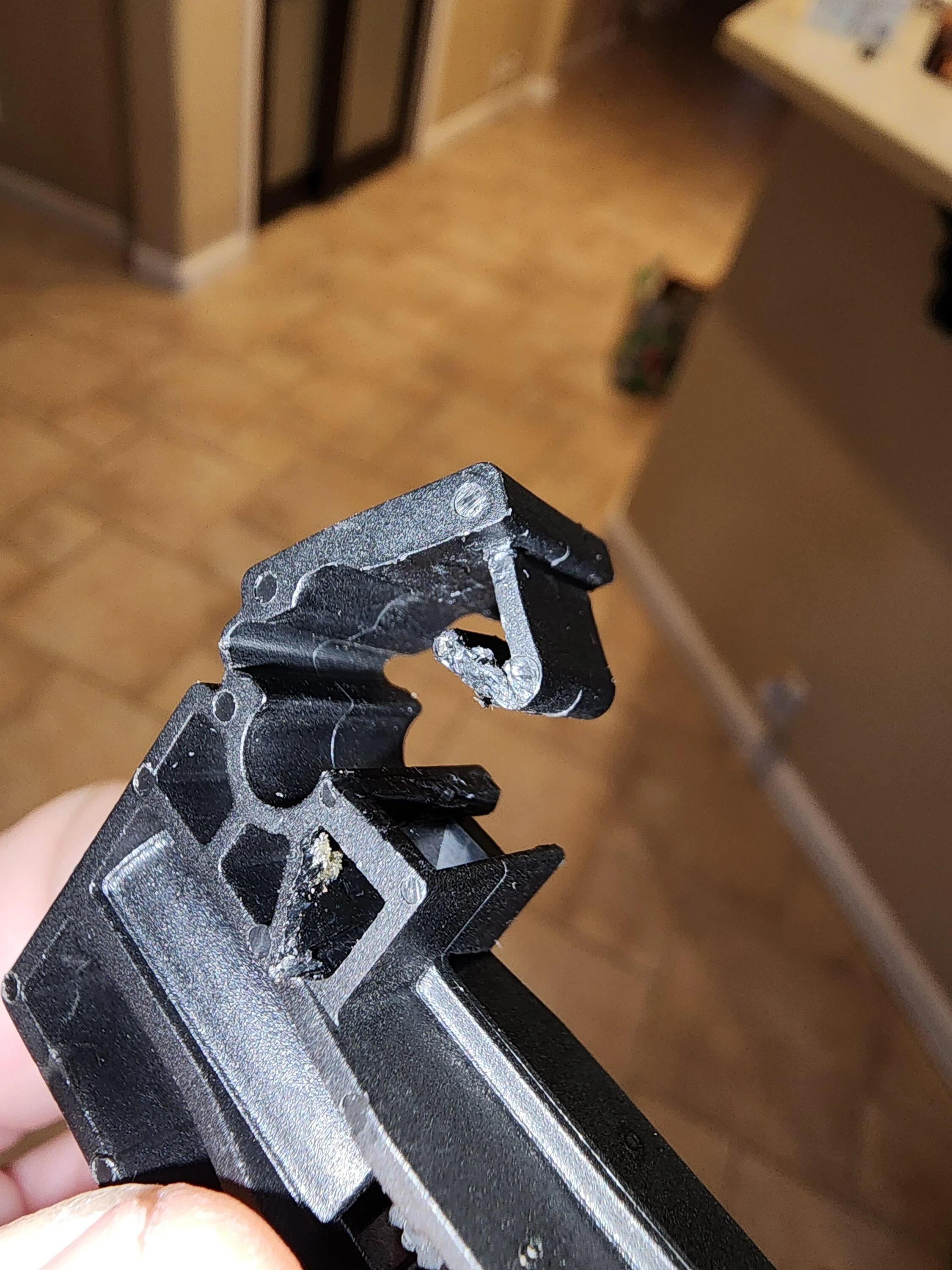

Use a very small flat blade to open the lock. Here are a few close-ups that may help:

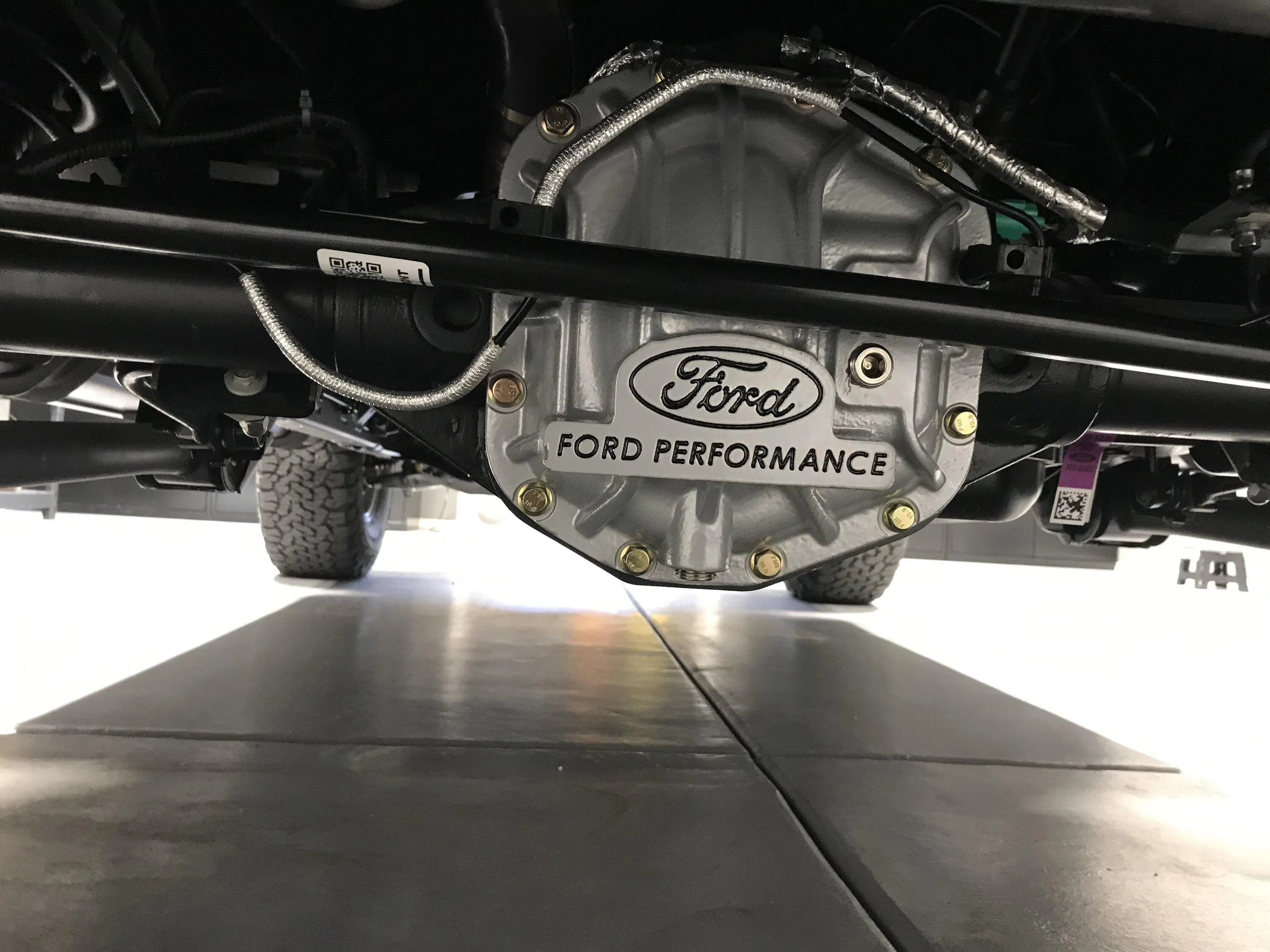

and @MadMan4BamaNATL remember they are not available as a separate part, you have to buy the entire left side brake line to get them ($75ish)...thanks Ford!
It's the main reason I chose not to re-use them on the Ford Performance cover, but installed longer studs and used the rubber lined stainless clamps.

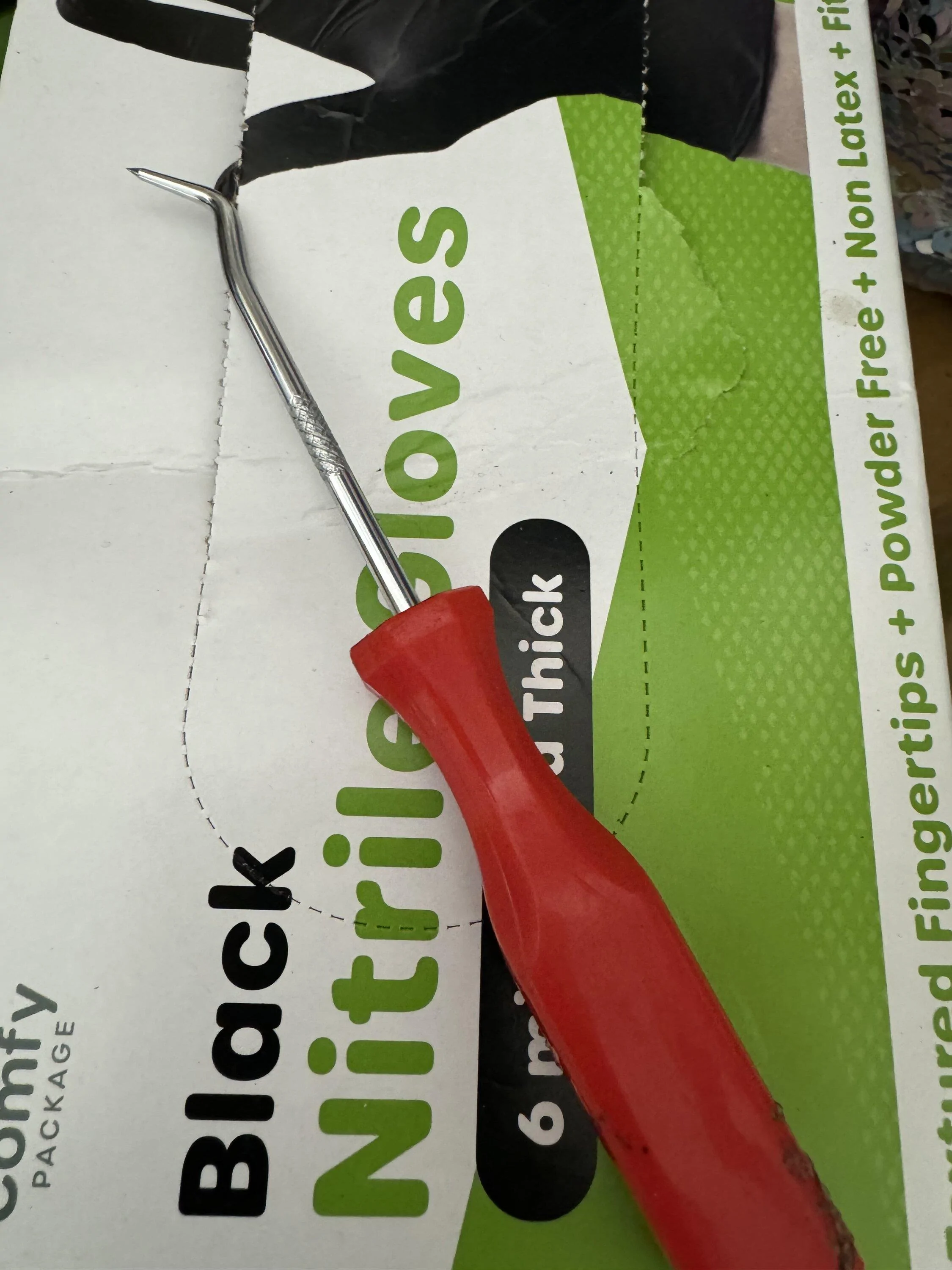

So went outside and spent a minute looking at the clips super easy to unclip use a sharp pic tool and press it through the hole and depress
Clip with it and use a plastic pry tool to move the clip from the tab side and voila it’s off. Takes 5 seconds, pic of the pick tool I used a
straight one will also work.
