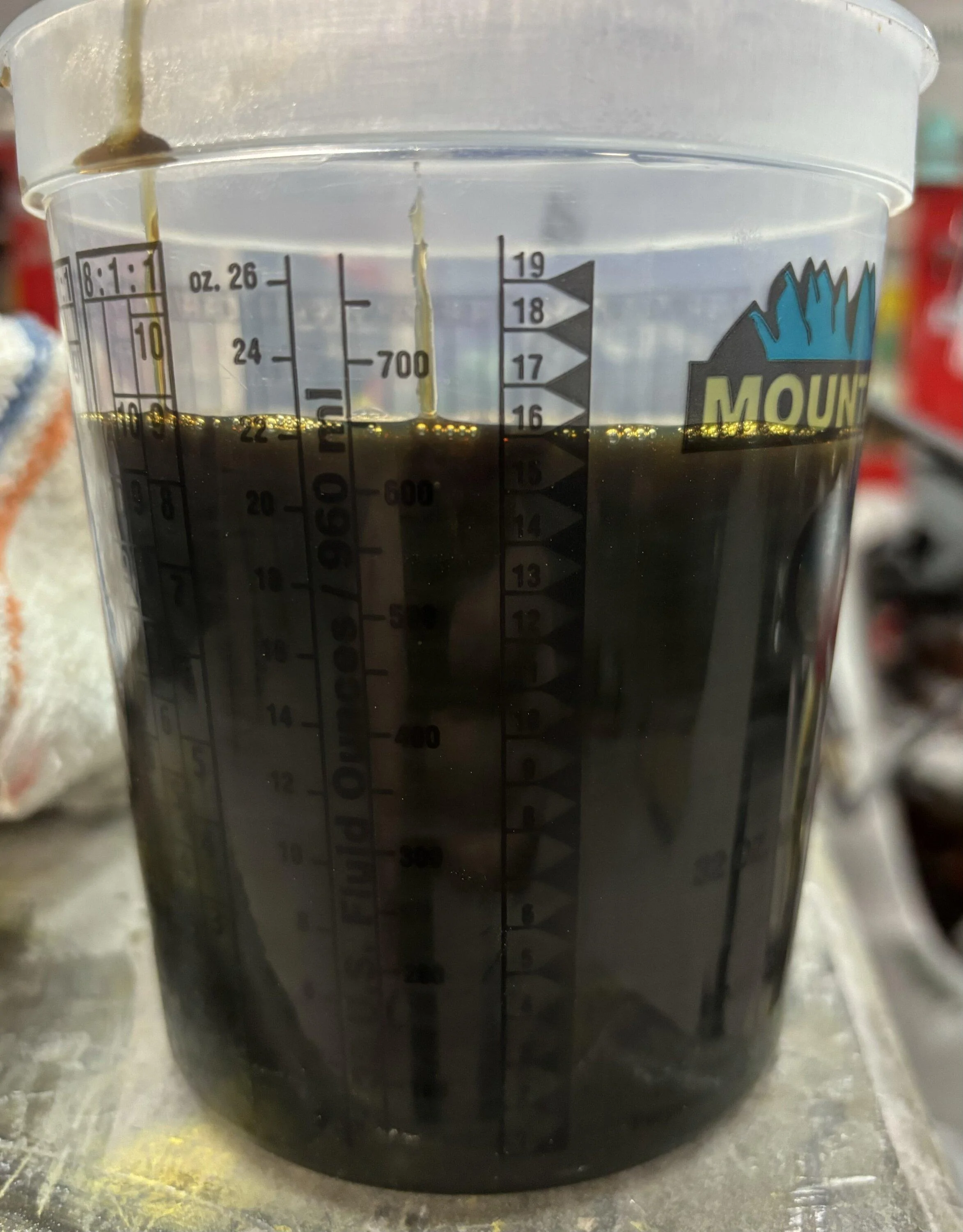

Front diff finally done.
22 whole ounces out (only!!), fresh new 75-90 in.
Will do a heavier weight change this summer.
