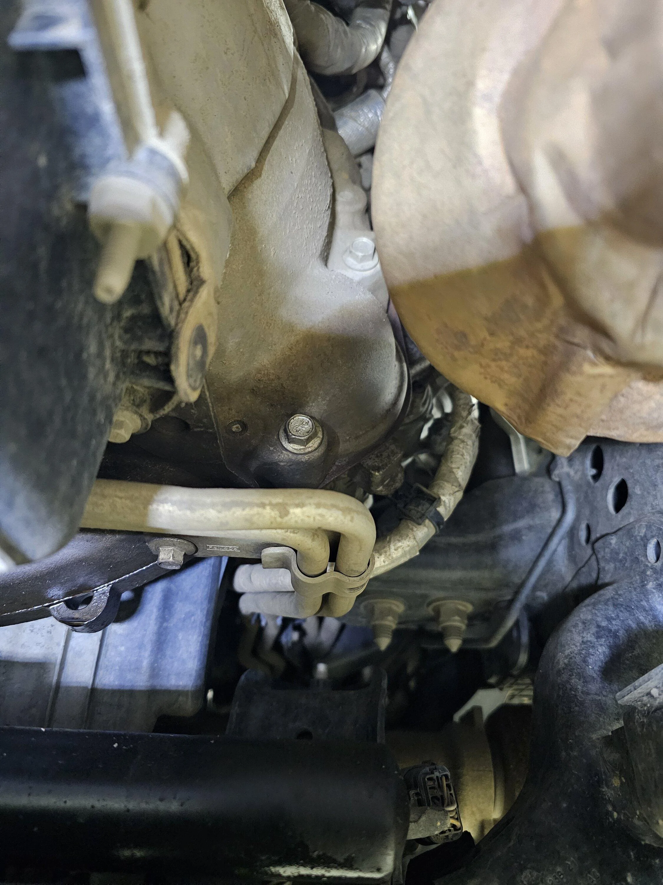

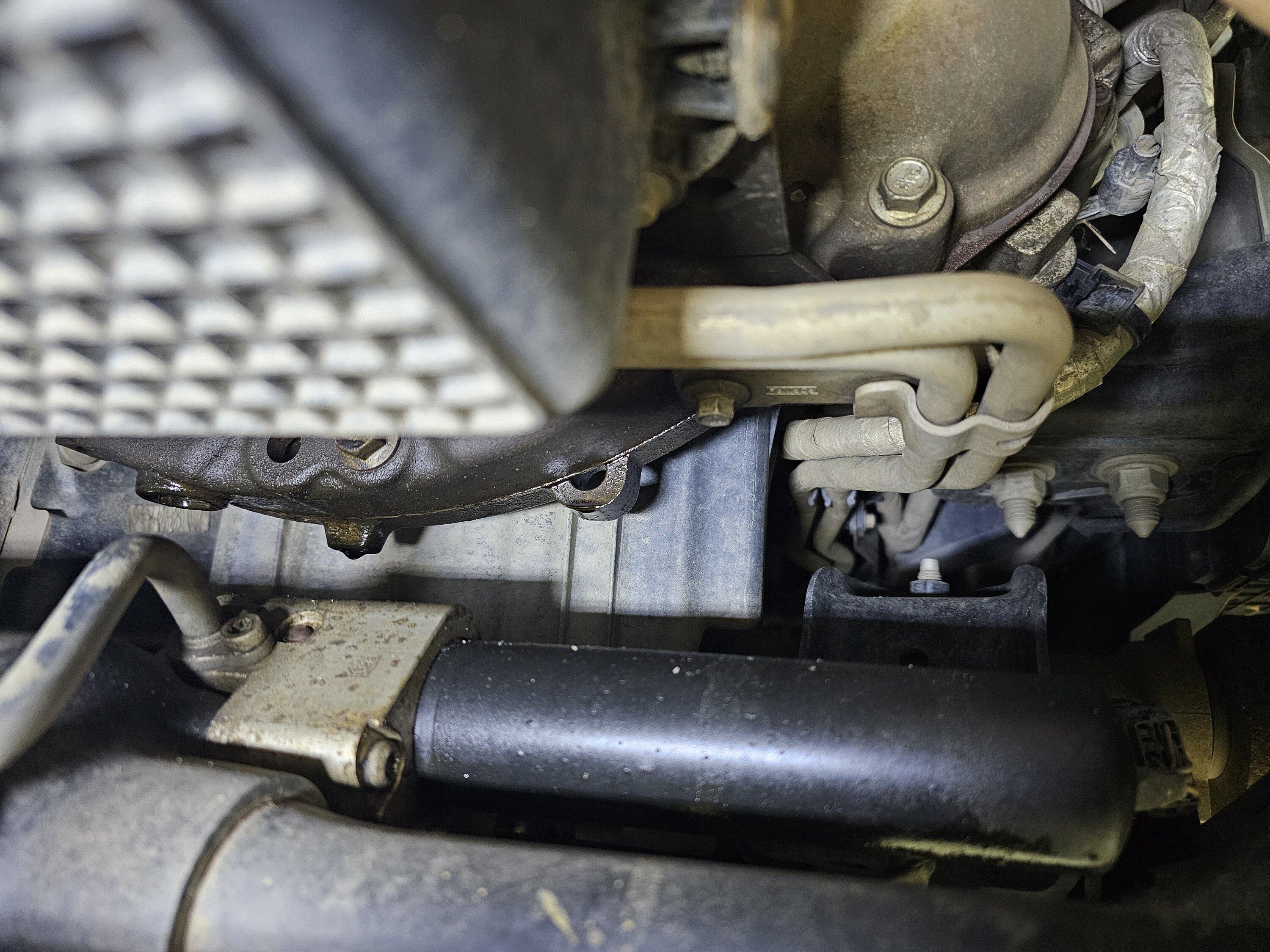

So, i have all my oil's, the new ford performance diff cover. Put on my lift. Raise her up, and just start looking around underneath and.......look what i found… Fix or Repard Daily ( FORD)
Well. I guess i bring her off the lift and to the dealer.
At least i found this before i started putting on all the new goodies.

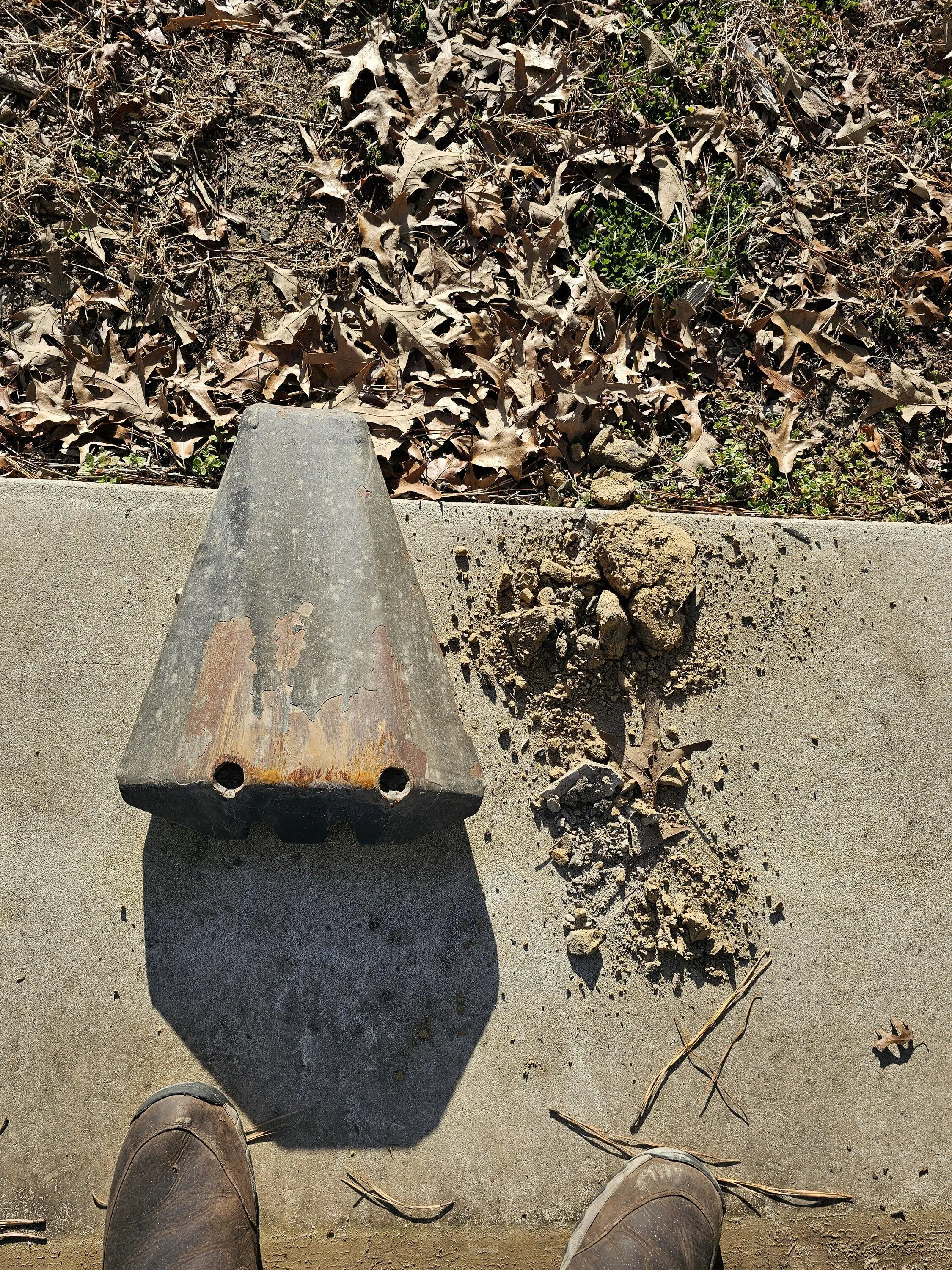

Went and changed the transfer case and rear diff today. Transfer case was easy except i under estimated the velocity of the fluid exiting the drain hole, got me pretty good.
I have the NV diff skid, took it off seamed heavy,
Ford Bronco Change Driveline Fluids Early! 1000025341
Guess i didn't get all the dirt out last time!!
Both fluids looked good but there was definitely the metal paste in the rear diff.

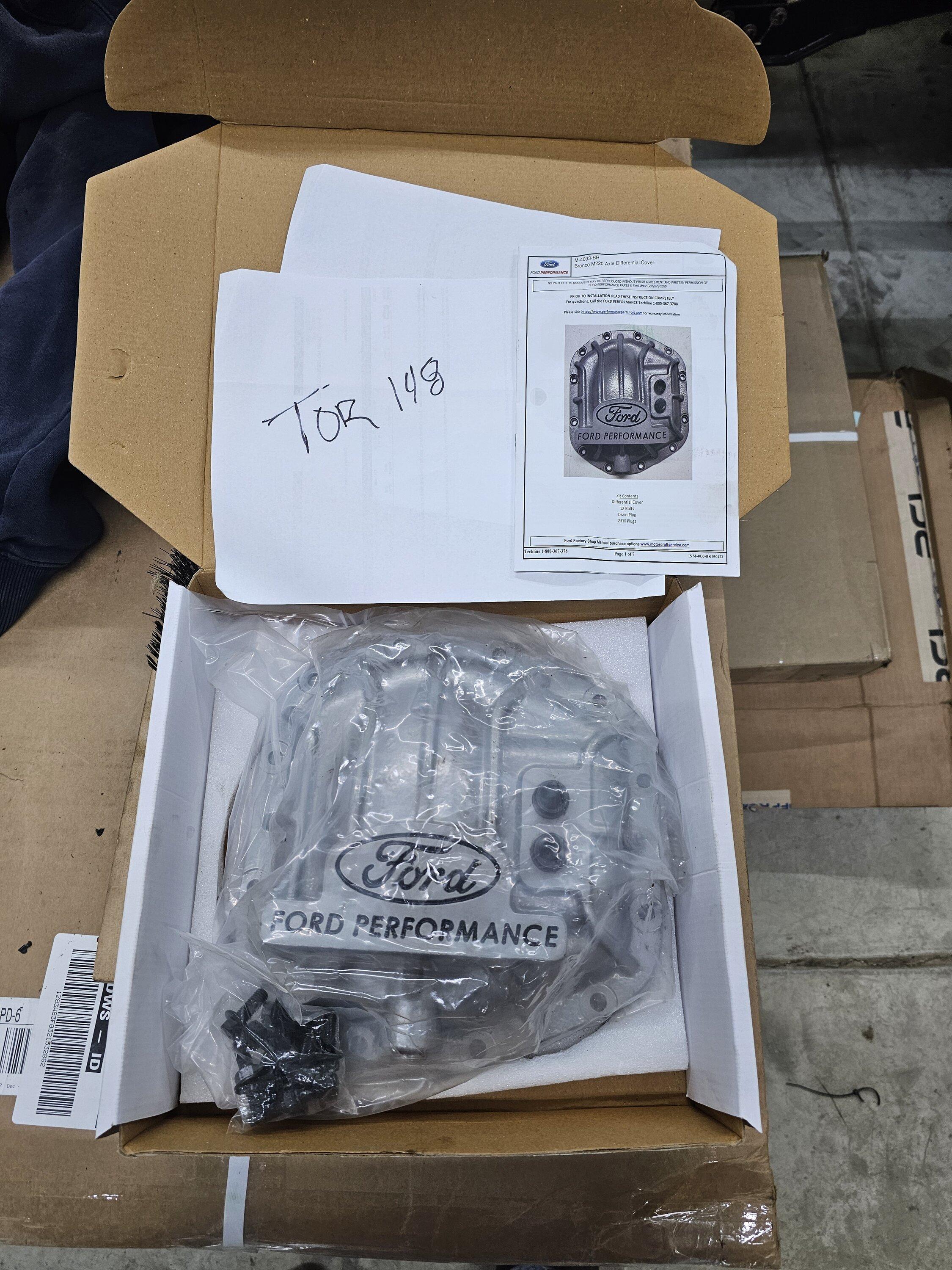

Put the Ford Performace cover on. Went to put the NV diff skid back on and......Nope!!
Damn thing wont go on woth the upgraded diff cover😞
I would have to remove too much material from the skid to make it work with the cover, and the skid is much more important to me then the convenience of the drain plug

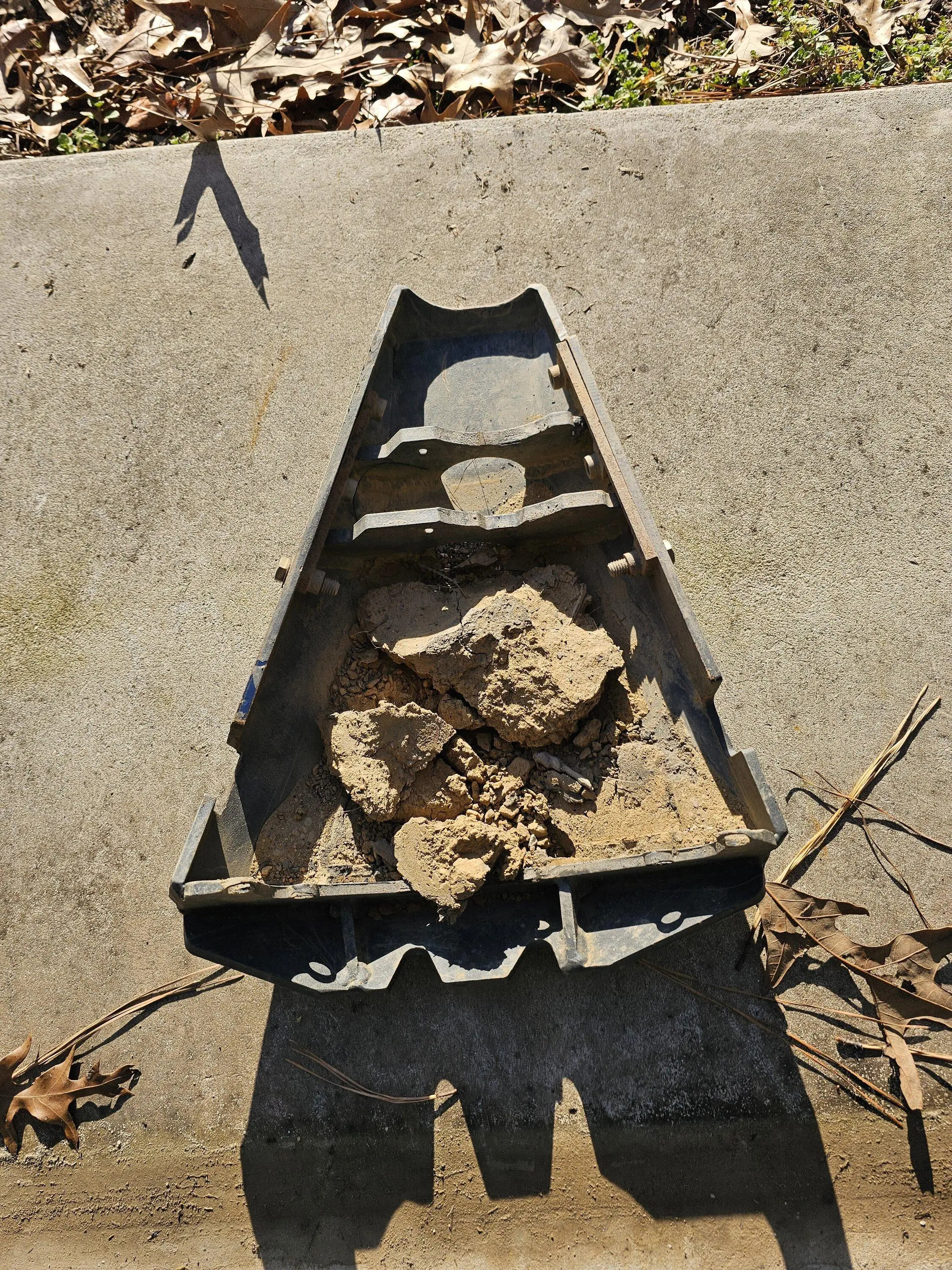

As you can tell, the skid gets used!!
Ford Bronco Change Driveline Fluids Early! 1000025342
So, anyone looking for a diff cover that was put in place for about 5 minutes!!! I have one for sale!
Ford Bronco Change Driveline Fluids Early! 1000025343

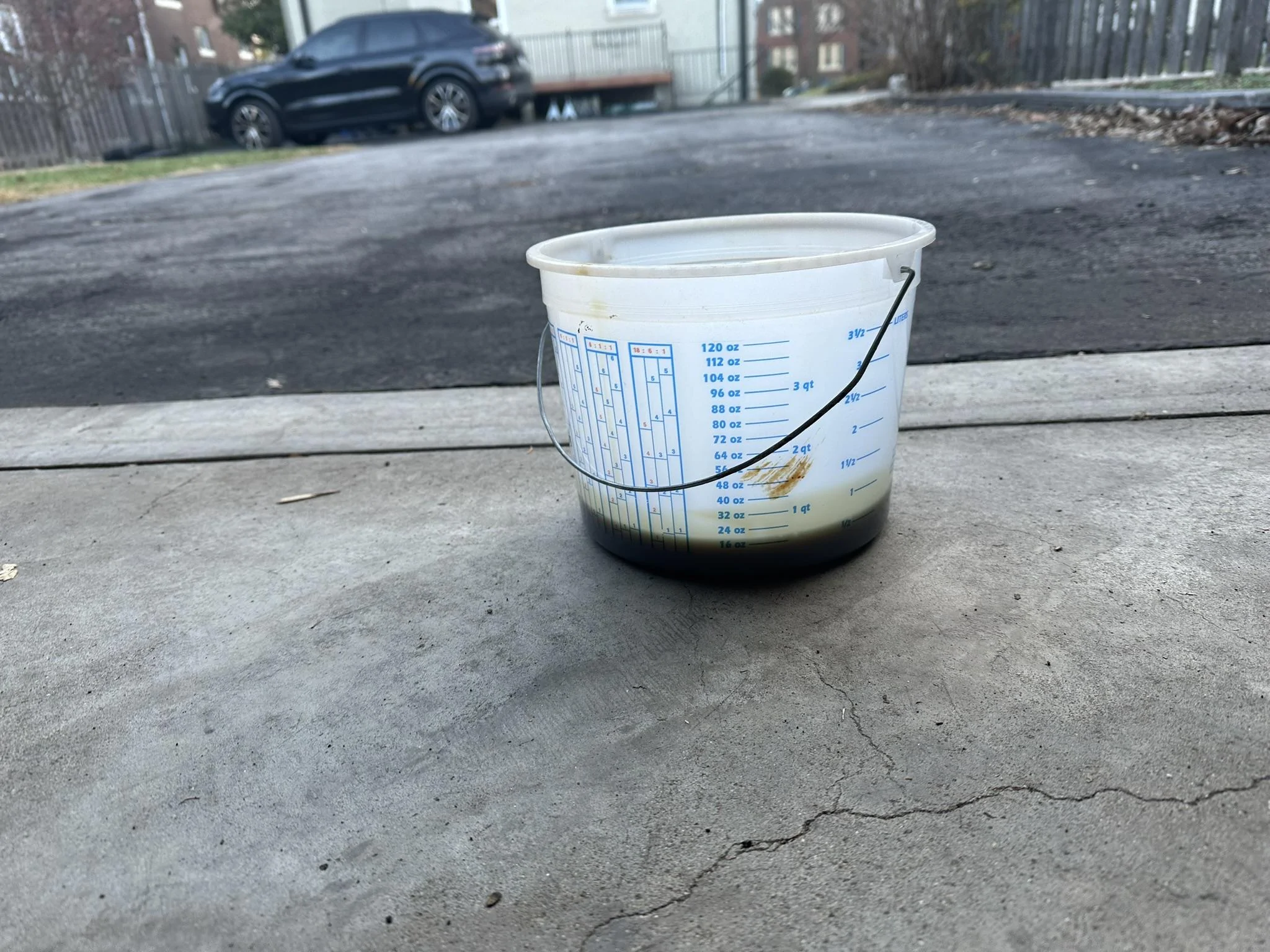

Changed the front diff fluid yesterday. Will do transfer case and rear diff sometime this week. Badlands Sas 2.7 ~14,000 miles, and drained 16oz from the front. So, low factory fill definitely a thing.

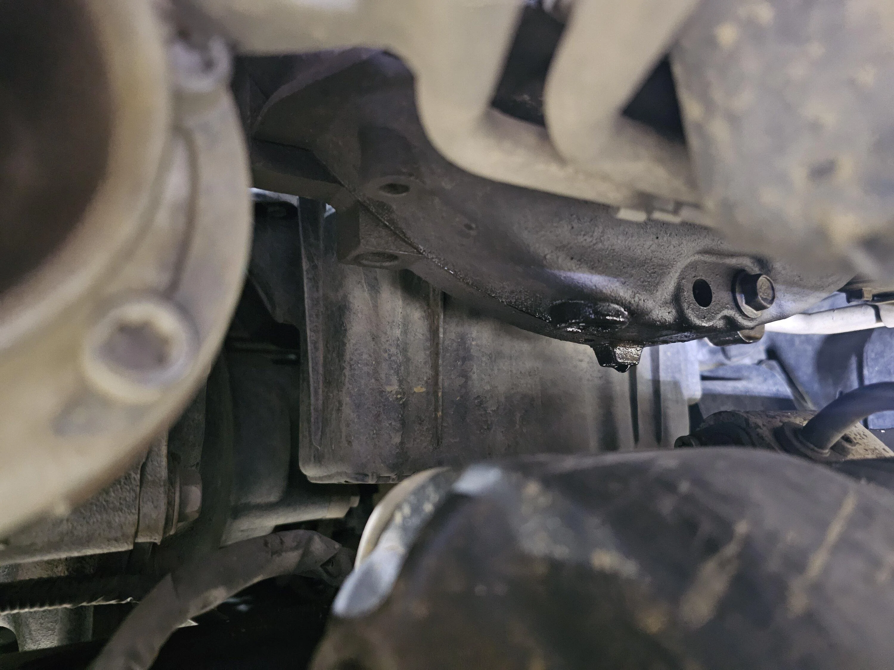

Just got the call from the dealer. Rear main seal is leaking. Need to order parts but they are giving it back and going to schedule in January when the get the parts and after the holidays. Hoping the thrust bearing is not shot and causing this. They said they will see when they tear it apart. Said it will be a two day job
