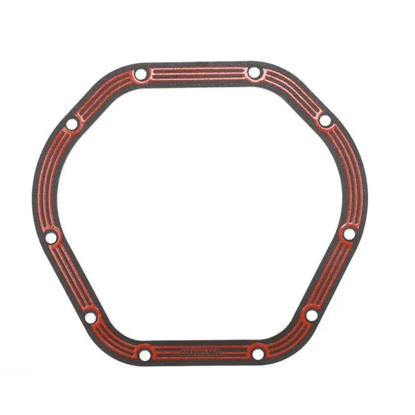

The OEM gasket is reusable. I have not decided if I'll re-use it or use the fiber gasket (which will need RTV sealer used with it).
I have not been able to find a fiber gasket to replace the one that comes with the cover, so at some point, I'll have to use the OEM.
I hope to install mine tomorrow afternoon and will report back.
If and when I need to replace the OEM gasket, I will use the Lube Locker brand.
Just make sure you get one for a Dana 44 Advantek that has 12 bolt holes. That one is for the old Dana 44 with 10.
With that said, the D44 locker axle under the Bronco is the same as the one under the Rubicon and I reused that gasket at least 10 times with no leaks. Just don't over torque and they are good to go.

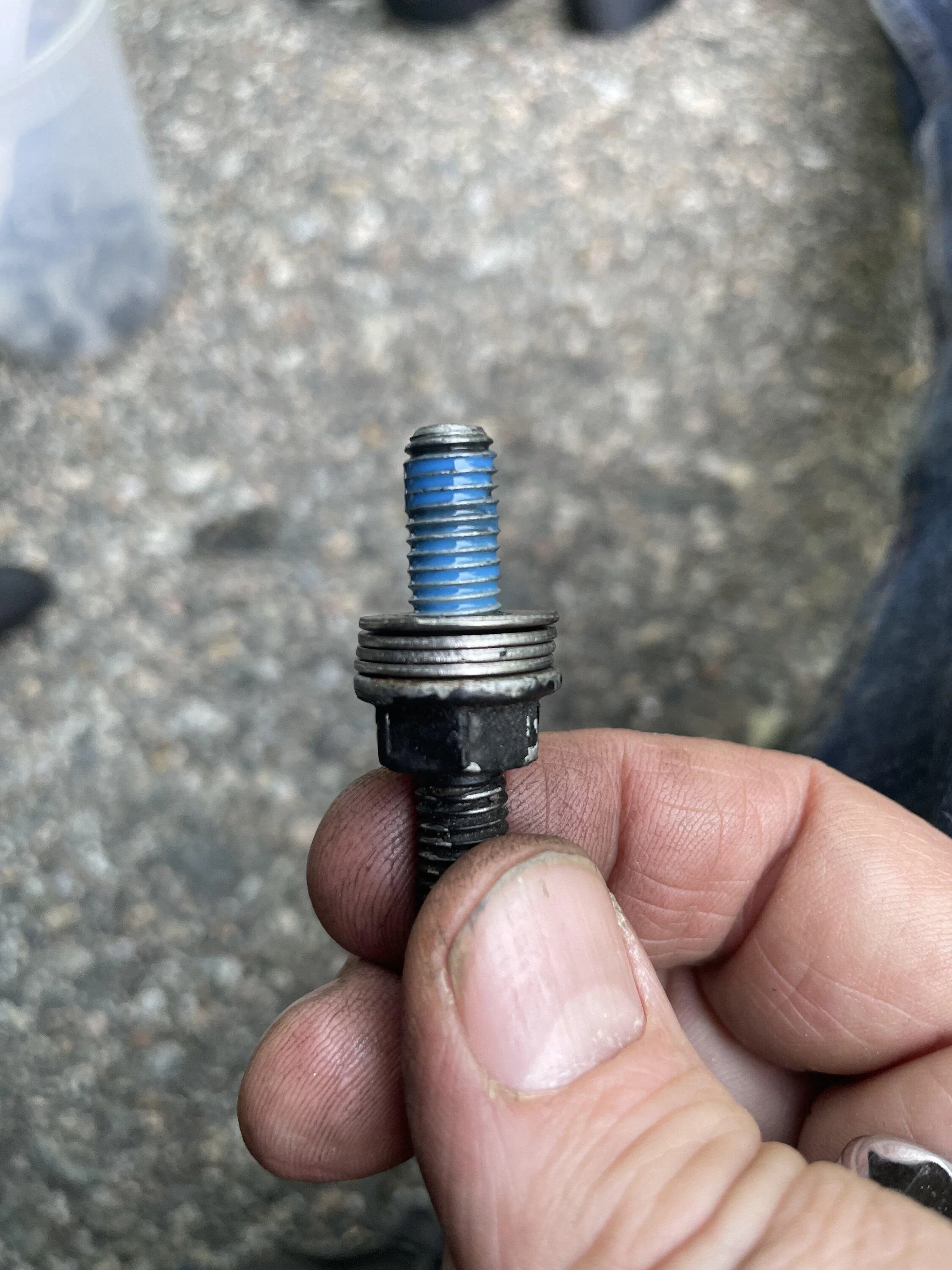

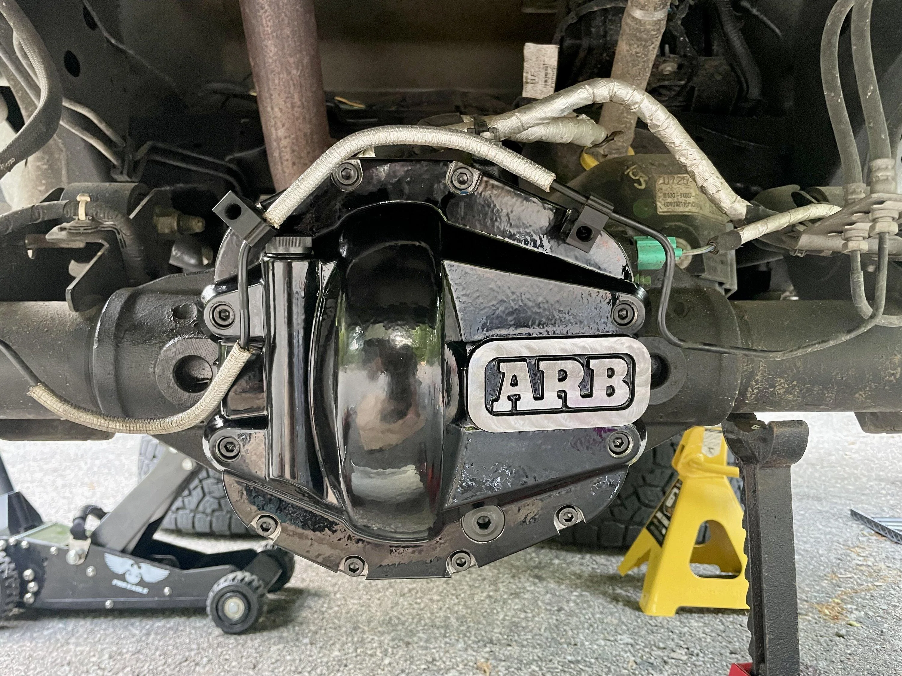

I’m sure there are better (re: more professional) solutions for the two stud bolts. But, this worked for me.
That ARB looks like a nice cover!
I see the drain plug at bottom and fill plug at Top left but was wondering how to check fluid level with fill plug that high up?
