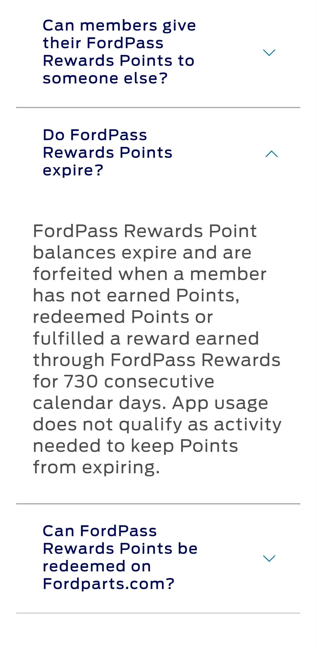

Uh…how often do they “expire”? I was sorta saving up for a set of wheels…
Guess I’m going heavier for my next drain & fill. I put that rear locker to work often.
From Ford website
