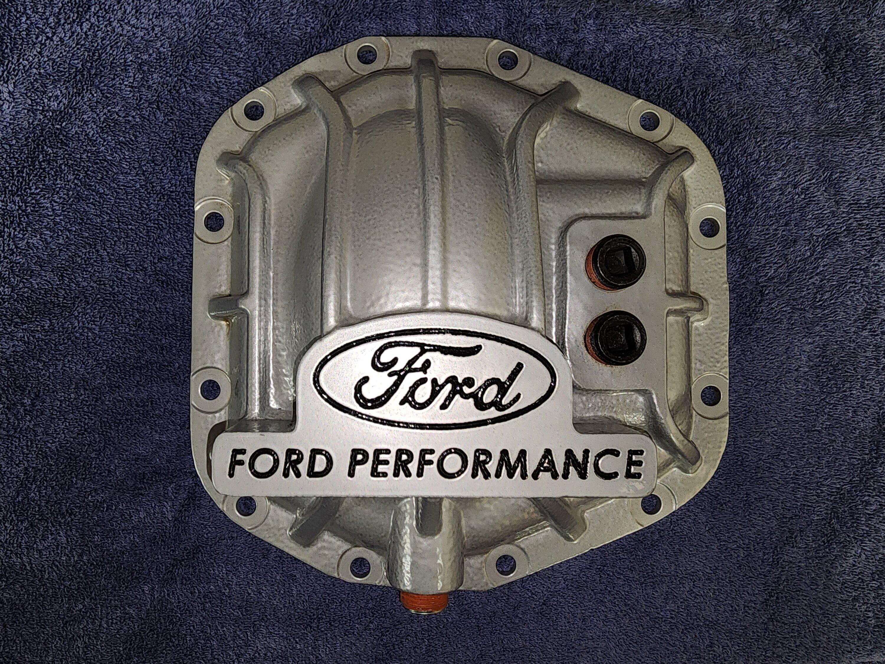

Ordered this to install on the next fluid change. I went with it because I wanted a drain plug versus having to pull the cover every time (though I will pull it to inspect occasionally).
Do you have a link? I can only find it at one third party site and it is 200.
Model number?

Is the drain plug on the Ford Performance cover magnetic?

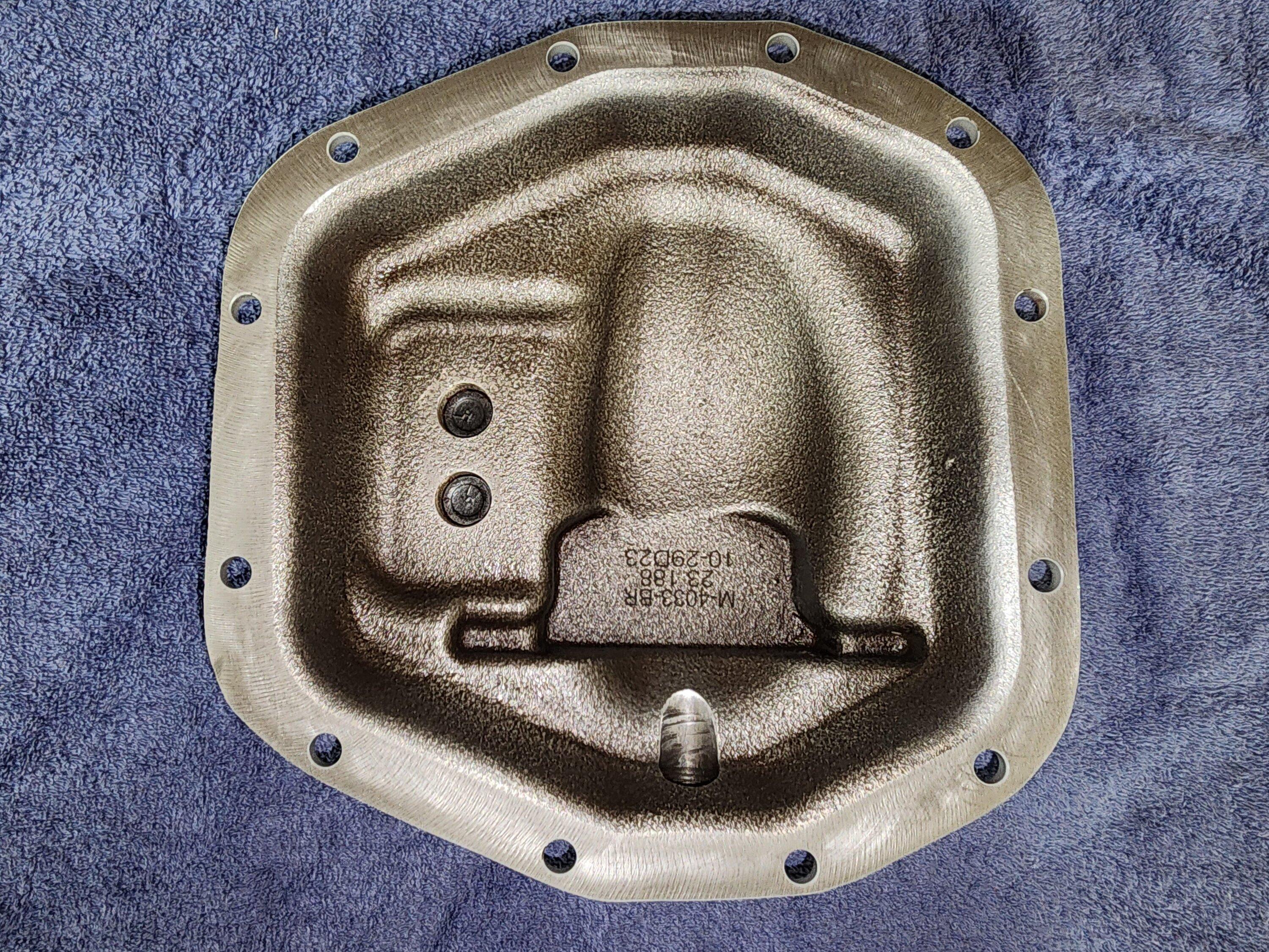

Yes; it is. Knowing how much metal these Dana 44 Advanteks shed for up to 25K miles or so, I will probably grab two more for the inspection and fill plugs.
