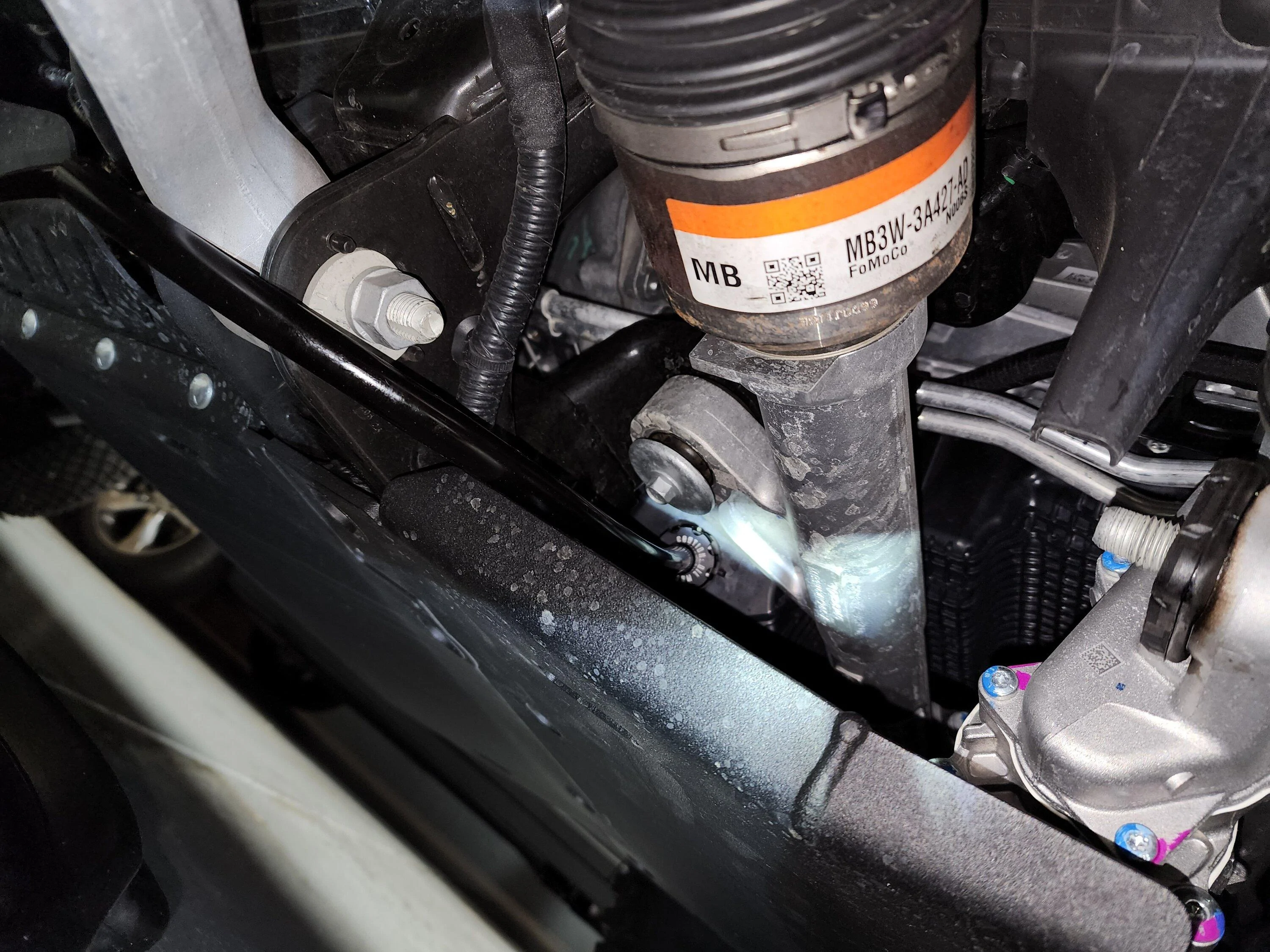

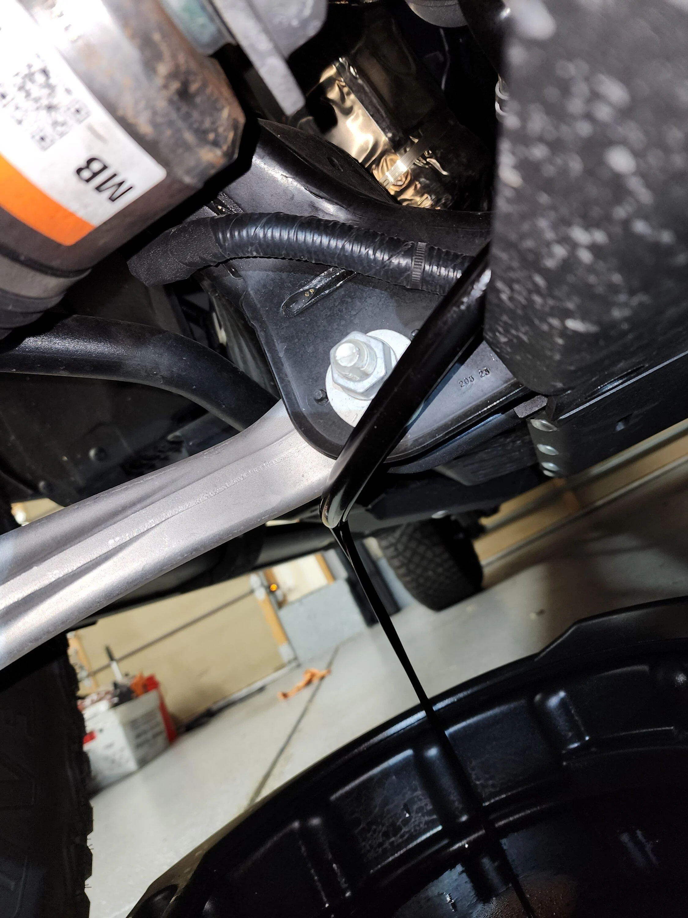

So, i have all my oil's, the new ford performance diff cover. Put on my lift. Raise her up, and just start looking around underneath and.......look what i found
Ford Bronco Change Driveline Fluids Early! 1000025188
Ford Bronco Change Driveline Fluids Early! 1000025189
Ford Bronco Change Driveline Fluids Early! 1000025190
Well. I guess i bring her off the lift and to the dealer.
At least i found this before i started putting on all the new goodies.
That looks like a rear main seal leak...
We shall see, hopefully its that simple. Been reading a bunch of threads and, well you know!
It does make me a little miffed that i just had a 'full service' oil change 2 months ago and only 610 miles ago and they never saw/said anything.
