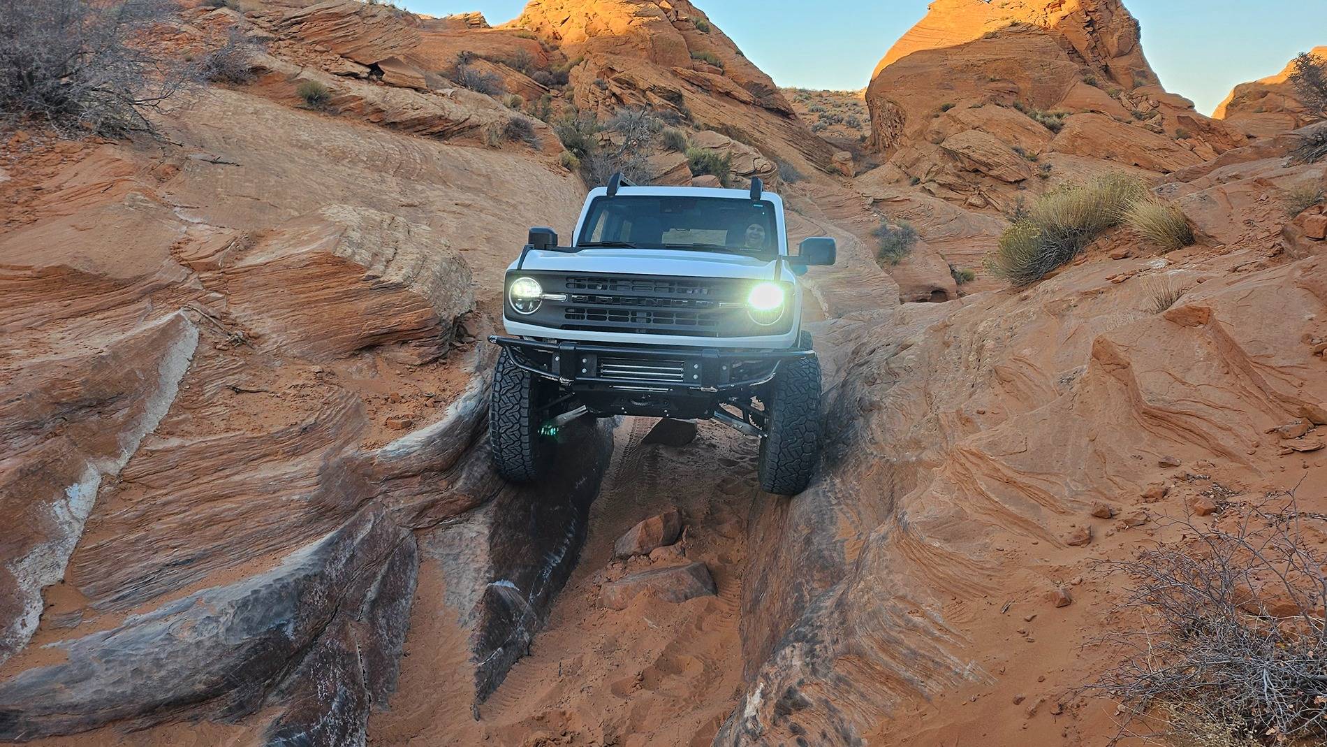

I did talk with Quinn about the replacement end caps vs entire rack housing. He said there were no known failures of the Hoss 3.0 with upgraded end caps. He couldn't confirm if the housing was even needed. As in... is the housing breaking due to end bushing deflection? Cause of catastrophic failure is difficult to isolate.
We have the 74weld housing on our Raptor. But debating direction on our 2dr. Both have the same 37x11.5R17 tires.
Anyhow. It seems that possibly the best overall option for cost and strength (for the money) is the Hoss 3.0 with 74weld end caps. At that point it's a simple swap if the housing or rack internals fail.
Upgraded Tie Rods are essential for 37s. Something like Icon or Apex with standard ball joint. 37 or larger are too much for stock tie rods (especially rock crawling).
Would also be interested to hear if anyone has knowledge of a Hoss 3.0 rack failing with 74weld end caps.
