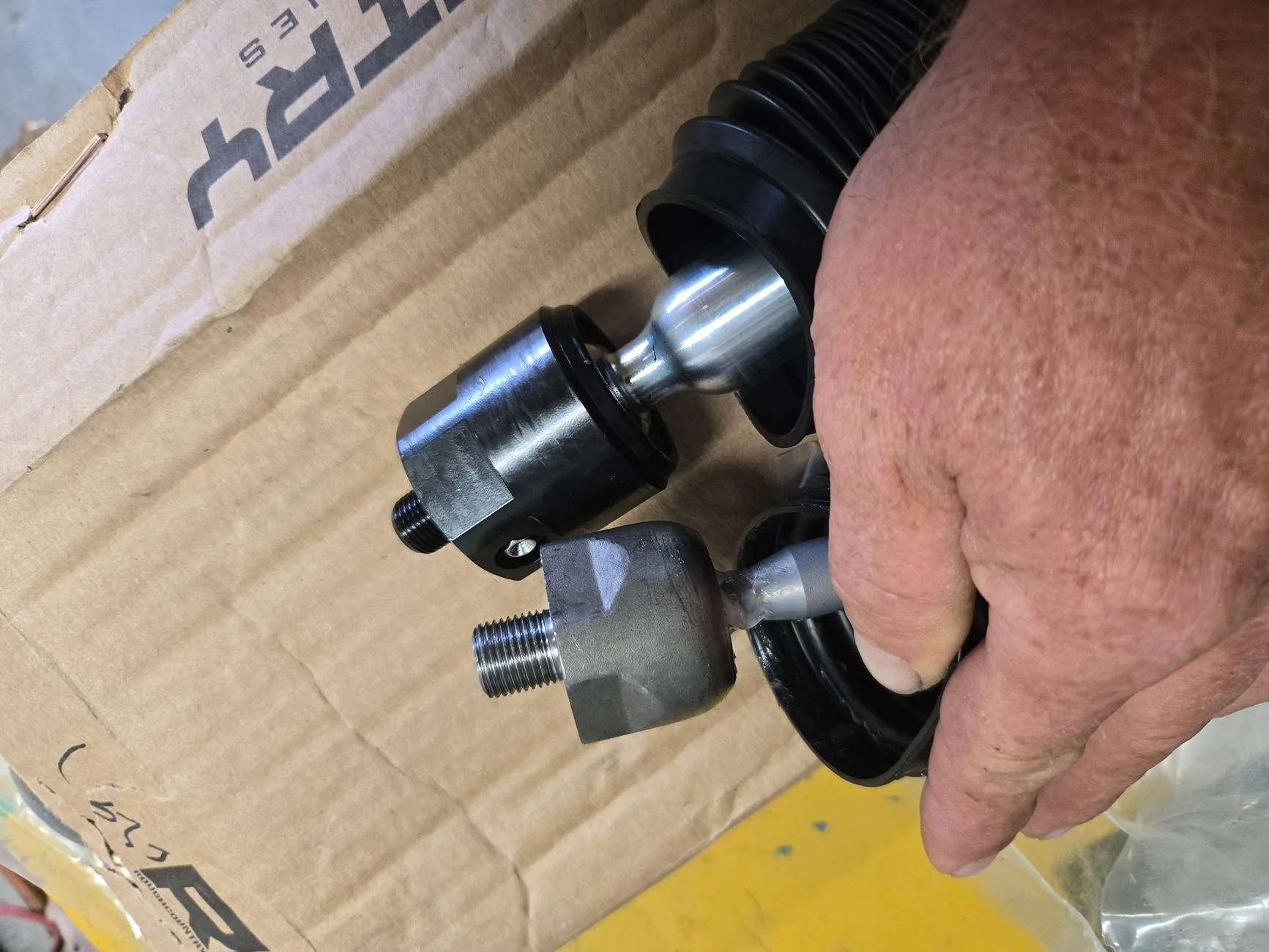

Once youve upgraded to the 74WELD stage 3 , the new weakest point would be the small short threads in the ends of the rack bar itself. Pretty certain those would fail before the pinion gears. You can see there is already a fuse....the smallest machined point right before the ball. On the Rough cuntries (TOP) this necked down area is nearly doubled there size of original 2.0 tie rods
Merry Christmas.
Do you think this threaded joint can fail in bending or tension (I doubt compression)? Would the rack bar (female thread) or the inner tie rod (male thread) fail. Has the failure of this joint happened in all stock scenarios or is the stock fuse always the outer tie rod?

I don't follow all the steering carnage on all the social media platforms. but in my 35 yrs of experience with other IFS vehicles tie rod and steering systems , I predict the threads to pull out on extension and the necked down area near the inner joint to fail under compression loads, BEFORE the rack bar buckled or broke.
