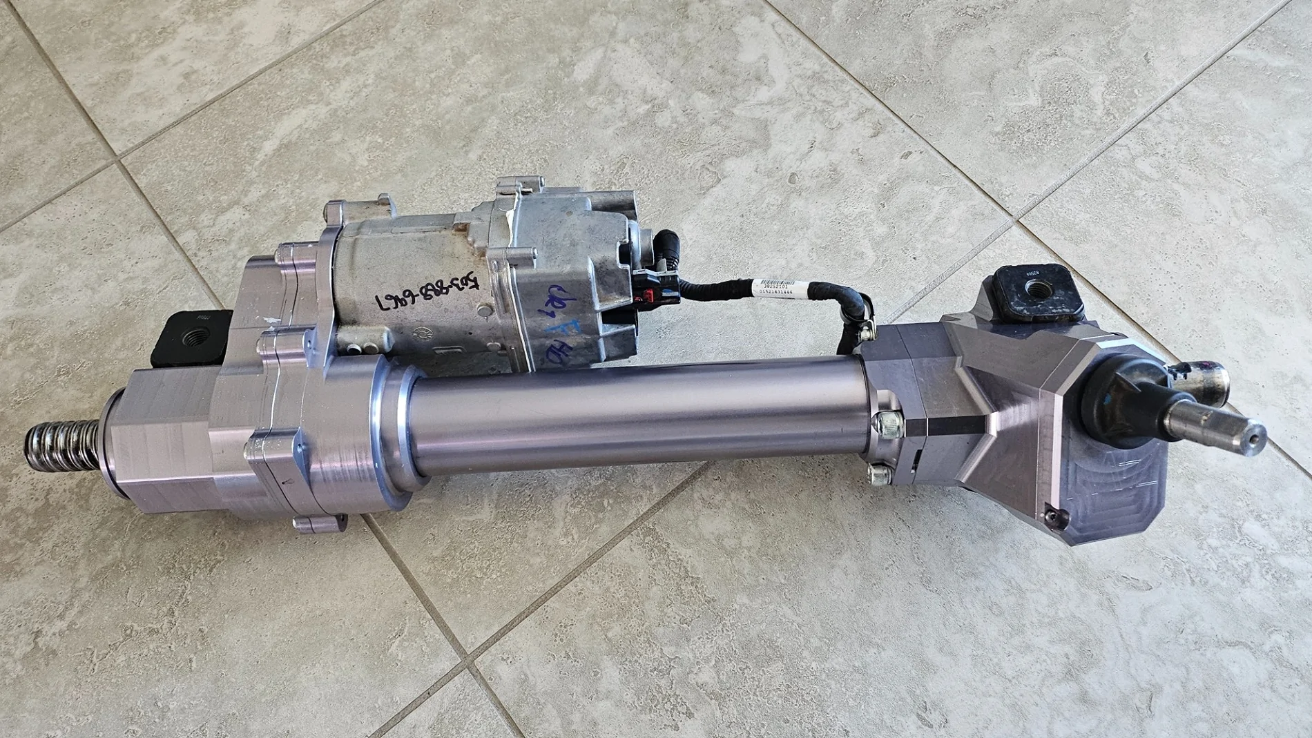

74weld received the rack on Monday. Verified the clunking. Put it in a new housing. Shipped out today (Wednesday). Huge props for them stepping up and quick turnaround. Will install this weekend and test. :)
What was the problem?

Ford Bronco 74WELD Steering Rack Clunking - Check Yours! 20260220_122254
Rack arrived with new housing. Different material color. Will install this weekend.
When i tore mine down to inspect, I found there is too much clearance between the pinion and rack-bar teeth. A at least some of the problem is coming from the upper pinion bushing
Itself.... So I had Quin send me a new cap and machineed in a bigger hole that actually accepts a sealed ball bearing. I installed this ball bearing, and it did help somewhat.However, mine still has a mild clunk. Mostly noticeable at lolo speeds.Once you're moving, it's hard to get the clunk to replicate the sound. Hopefully, they have moved the pinions hole CLOSER to the rack bar.

Rack is installed. There is a slight tap when sawing the wheel on center. However, if sawing the wheel slightly off center it is silent. I was concerned the sloppy previous housing would cause wear to the pinion / bar (which I did talk with Chad about). I'm guessing that is the noise at this point.
However, it it minor and acceptable assuming it stays the same. Guess time will tell...
Significantly better. Partial win.
