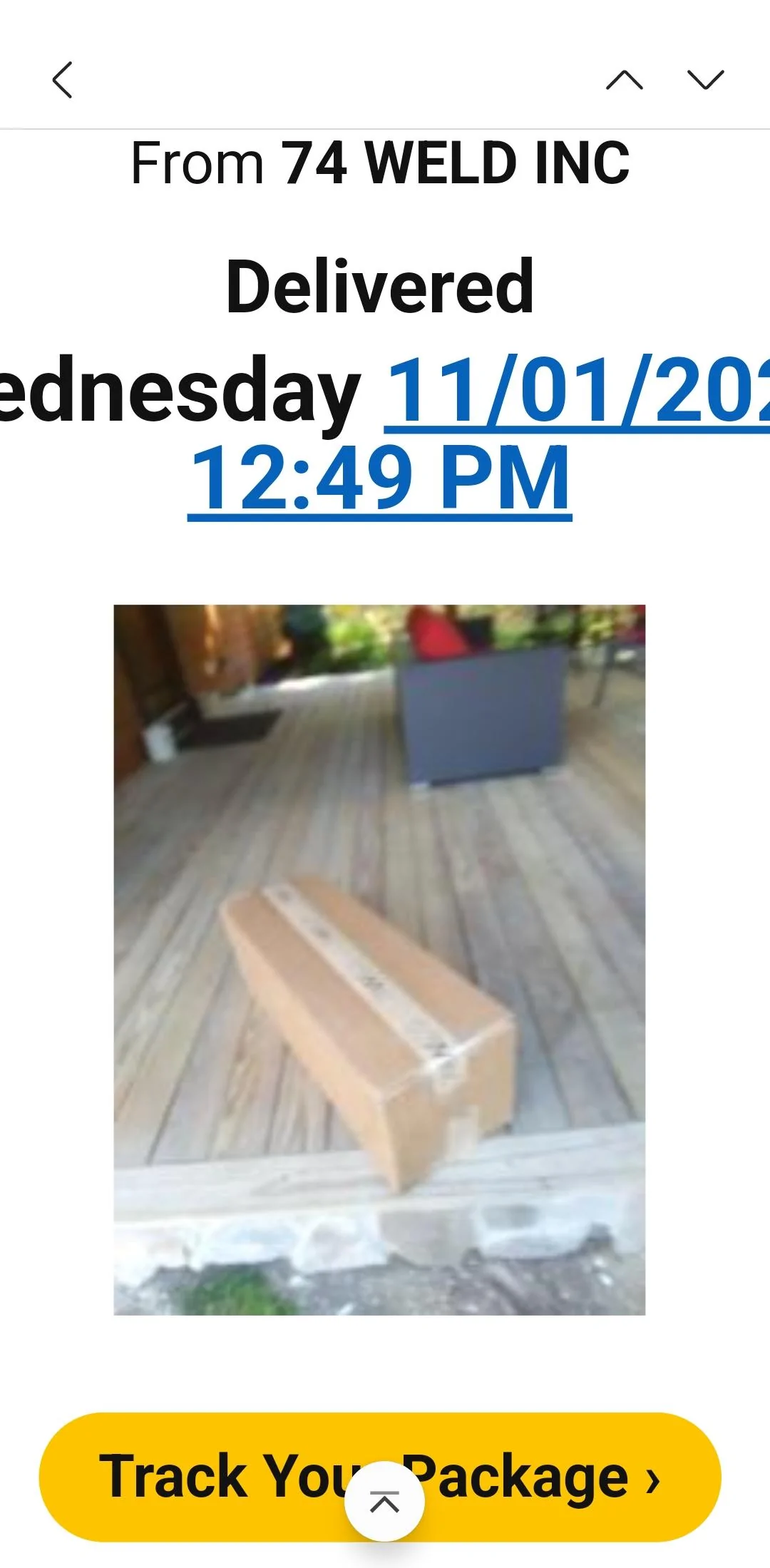

Great write up, thank you.
You guys want to take a road trip to NJ and help me install mine? I got a lift!!!
Ford Bronco Lessons learned from installing the HOSS 3.0/74Weld steering rack Screenshot_20231101_184343_Email
Mine is sitting on my porch, and I am away for an event. When i get back, its top of the list!!!
Congrats!
