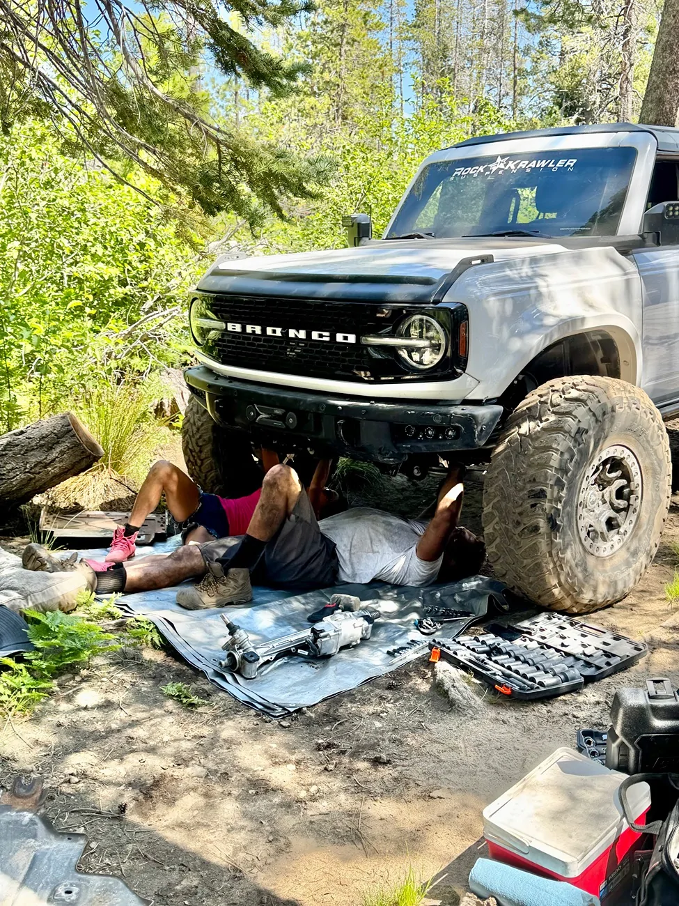

We pulled the 55weld steering rack on the trail after it threw some codes and started clicking when turning passenger. Never lost power steering but decided to do the swap in a location of our choosing (flat with grass) rather than wait for it to finish breaking on the trail. Put a factory Hoss 3.0 back in.
It is pleasant to no longer have the clunking.

But yeah-with it starting to randomly act up in the middle of the rubicon, we decided to swap it out when we got to the campsite. So technically still chanced it getting worse and fully breaking, then doing an actual trail swap within the couple more miles we drove it, and not a “grassy flat spot next to the trail” swap.
