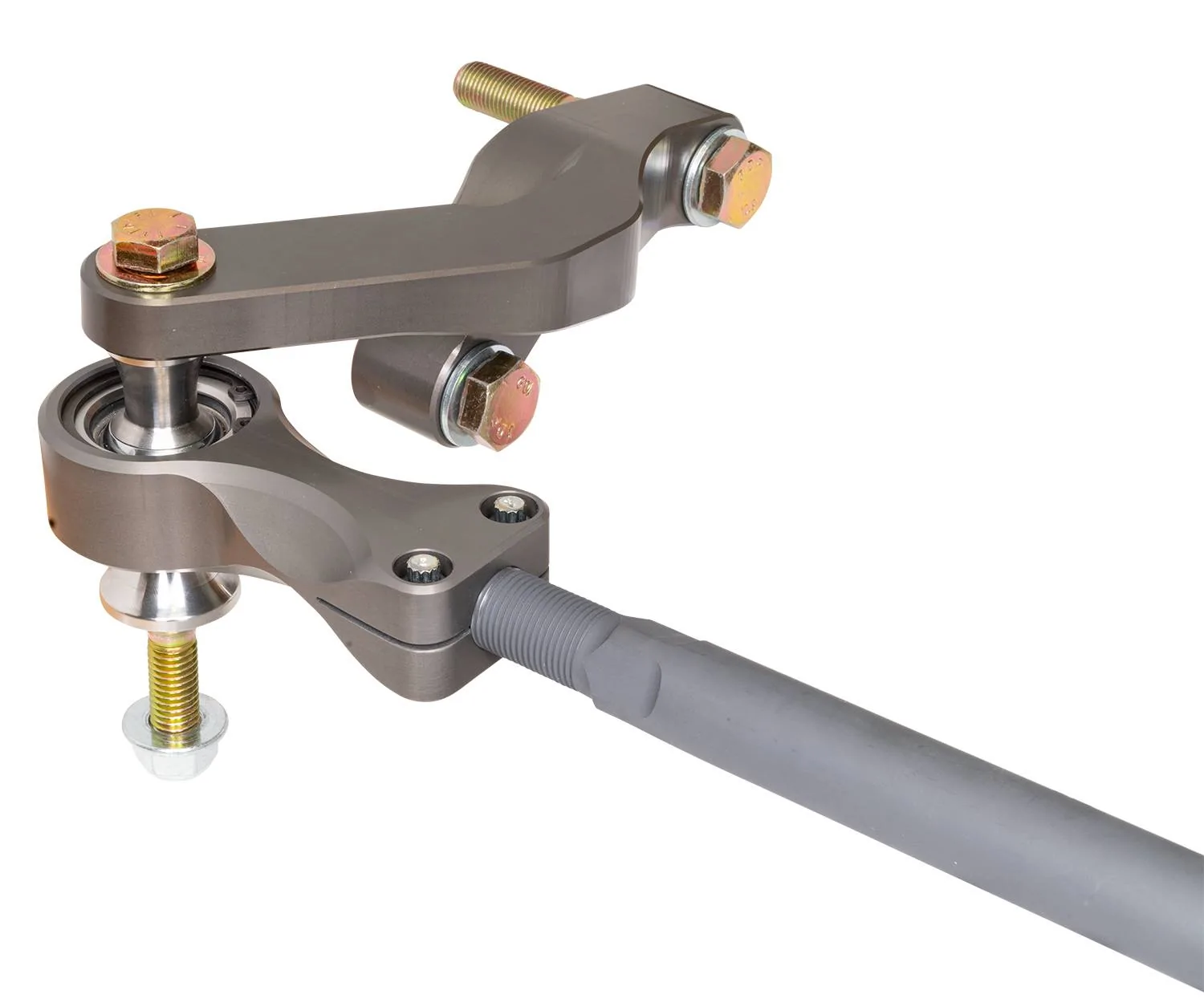

Also, FYI, the RPG Raptor tie rods are not double shear 😉. Here is the Carli Bronco (non Raptor) double shear system. A thing of beauty.
Ford Bronco 74 Weld Steering Rack (SAVE YOUR CASH) CS-BRS-21.6
*EDIT* - I see that with 74W portals there is a dual shear option for RPG tie rods. But again outside of this special case, Carli makes the only dual shear system and unfortunately, not for Raptor.

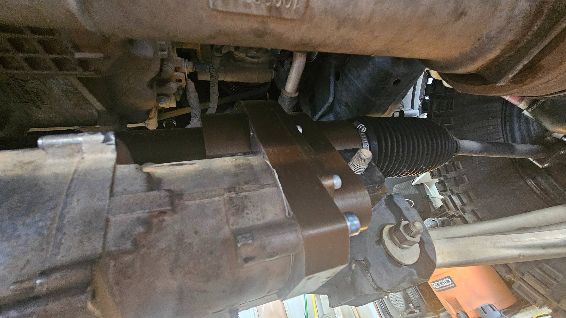

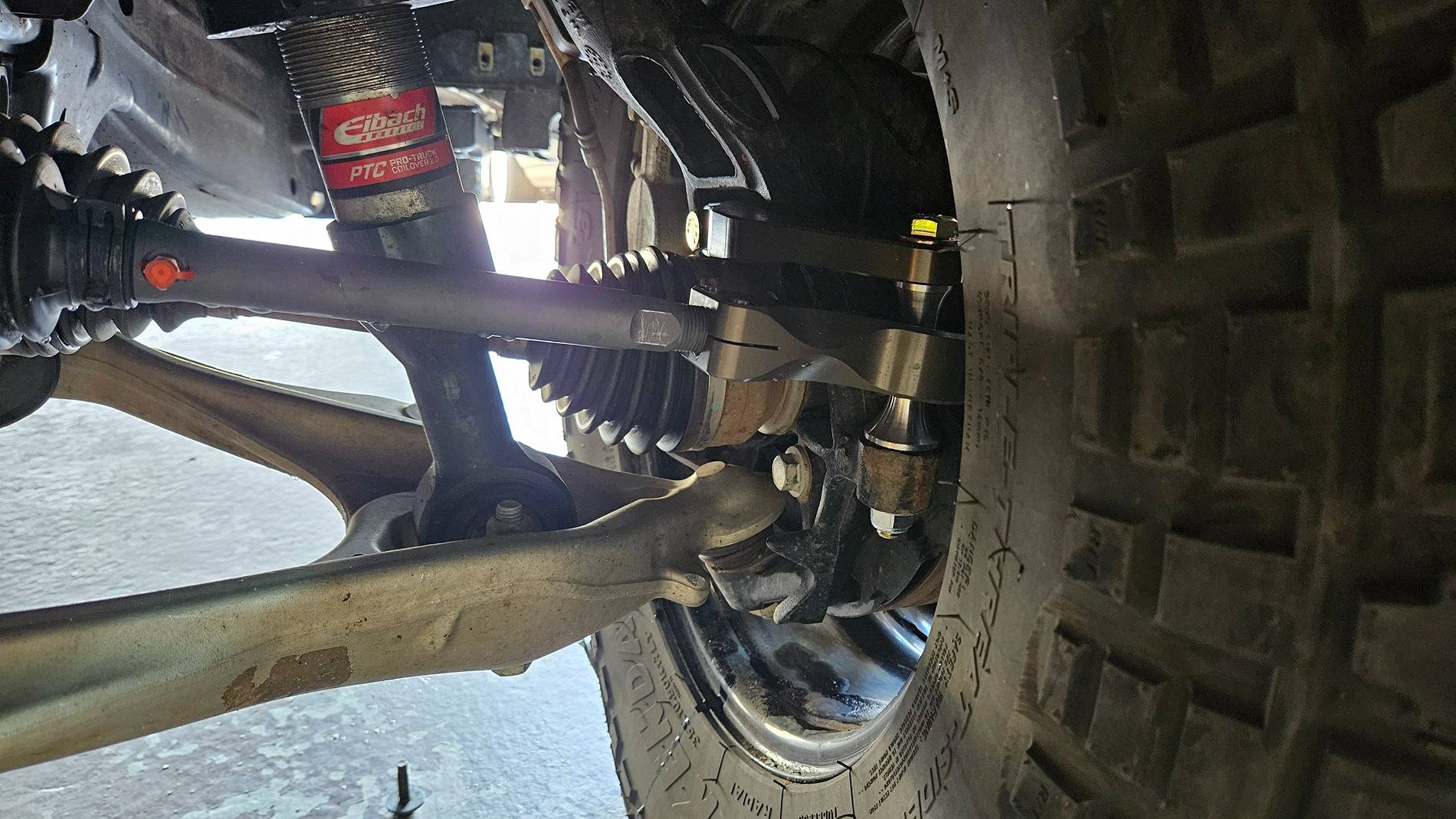

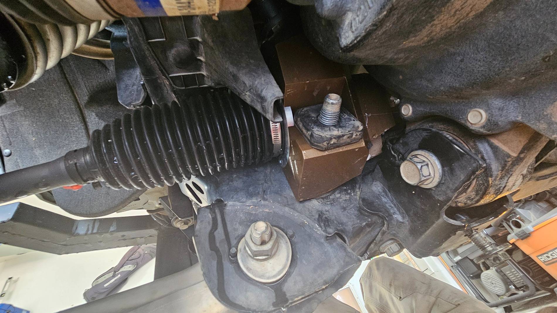

Glad I bought my Vasher Designs housing and Carli setup, user serviceable...
Ford Bronco 74 Weld Steering Rack (SAVE YOUR CASH) 20240428_130158
Ford Bronco 74 Weld Steering Rack (SAVE YOUR CASH) 20240428_130151
Ford Bronco 74 Weld Steering Rack (SAVE YOUR CASH) 20240428_130129
And so far, so good... 😉
