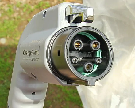

Rather than leave some switching equipment on the Bronco, I've considered playing with an SAE J1772 EV plug and putting the 120V (heaters) on the AC legs and 12V (tender) on the control legs.

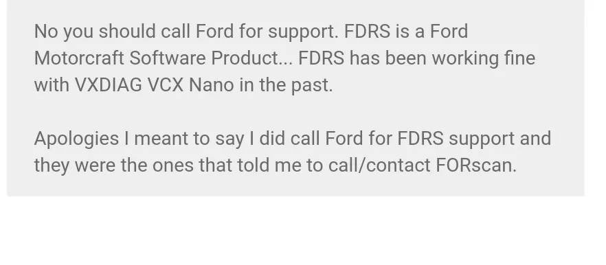

I know this isnt necessarily a FORscan topic but it kinda goes into it. I am using a VCX NANO I can connect to FORscan but I cannot connect to FDRS. FDRS does not allow me to select "different device" option. I was told to call FORscan or contact them in order to get the drivers specifically for the VCX NANO but that doesn't sound right either. Does anyone have any experience using the VCX NANO and FDRS or can help me figure out how to get this thing connected.

No you should call Ford for support. FDRS is a Ford Motorcraft Software Product... FDRS has been working fine with VXDIAG VCX Nano in the past.
My next suggestion would be to fully uninstall and reinstall FDRS, since you initially installed it without the VXDIAG VCX drivers missing.
Apologies I meant to say I did call Ford for FDRS support and they were the ones that told me to call/contact FORscan.

last statement shows the FAKE....he's fake. there's no way in he'll anyone at FDRS told him to call or contact the folks at forescan...
Turns out that he's just unlucky... So there's that. I must admit, it was strange how it all went down.
