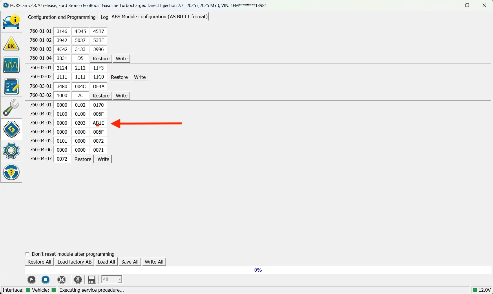

I did it by using Forscan and the spreadsheet from this forum... Thanks to those guys that compiled all of that! If you haven't used Forscan, I highly recommend reading/watching all the "How To's" and "Tutorial" so you know what to do and in what sequence (reading module, making back ups, communicating, writing, saving, exiting, cycling, etc)... BEFORE you are actually doing it. I even made a step by step list for myself.
Specifically, after first backing up the "ABS As Built module", I added Sport Mode by going into the ABS As Built module and on 760-04-03 changing only the second digit in the third box (red asterisk * below) to a "B" as shown below (don't worry about the rest of the numbers/letters)
Ford Bronco 2021+ Bronco ForScan Thread 1781967095316-a
looked like this in Forscan (below is after the change was made)
Ford Bronco 2021+ Bronco ForScan Thread As Built
Then saved/wrote/cycled and exited out. Then turned the Bronco off, and let it power down completely for a minute. Then started the Bronco, confirmed Sport mode was available and took it for a drive to confirm settings were actually changing and it was actually in Sport mode, which it was obvious it was. After that I turned it off and let it sit for a couple minutes, then turned the ignition on (not engine), and checked for any codes and cleared them (I don't remember if there actually was a code doing one this or not). I left it like this, with both Sport and Eco, for about a month, had no issues (other than the display being generic for Rock Crawl because I had 8 modes enabled).

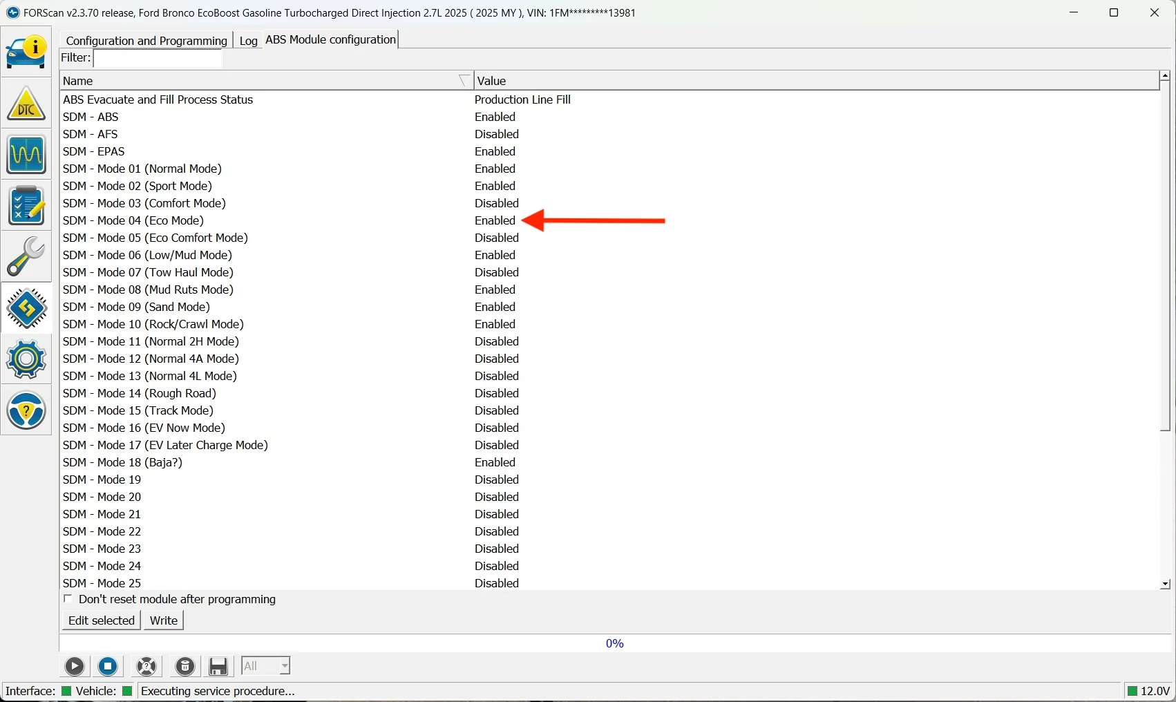

Then a month or so later, again using Forscan, I went in to disable Eco mode. Because I was unable to figure out or find the value to change to disabled Eco mode in the ABS As Built module, I went in to just the ABS module (the one that does not say "As Built"), that people refer to as "easy mode" to disable Eco mode. I found Eco mode in the list of modes (pick the right one!) and clicked on where it said "Enabled" and changed it to "Disabled", then again went thru the steps of writing/saving changes and exited out.
(below is before I changed Eco to Disabled)
Ford Bronco 2021+ Bronco ForScan Thread Easy
Go thru the tutorials, because I am probably not using the correct terminology, so you know how to get in to and communicate with the module(s), how to make and apply your changes, when to cycle the ignition, how to disconnect, etc... properly. It's simple, but I still wrote the sequence down, big enough I could read it, to have a cheat sheet just to be sure as I was actually doing it.

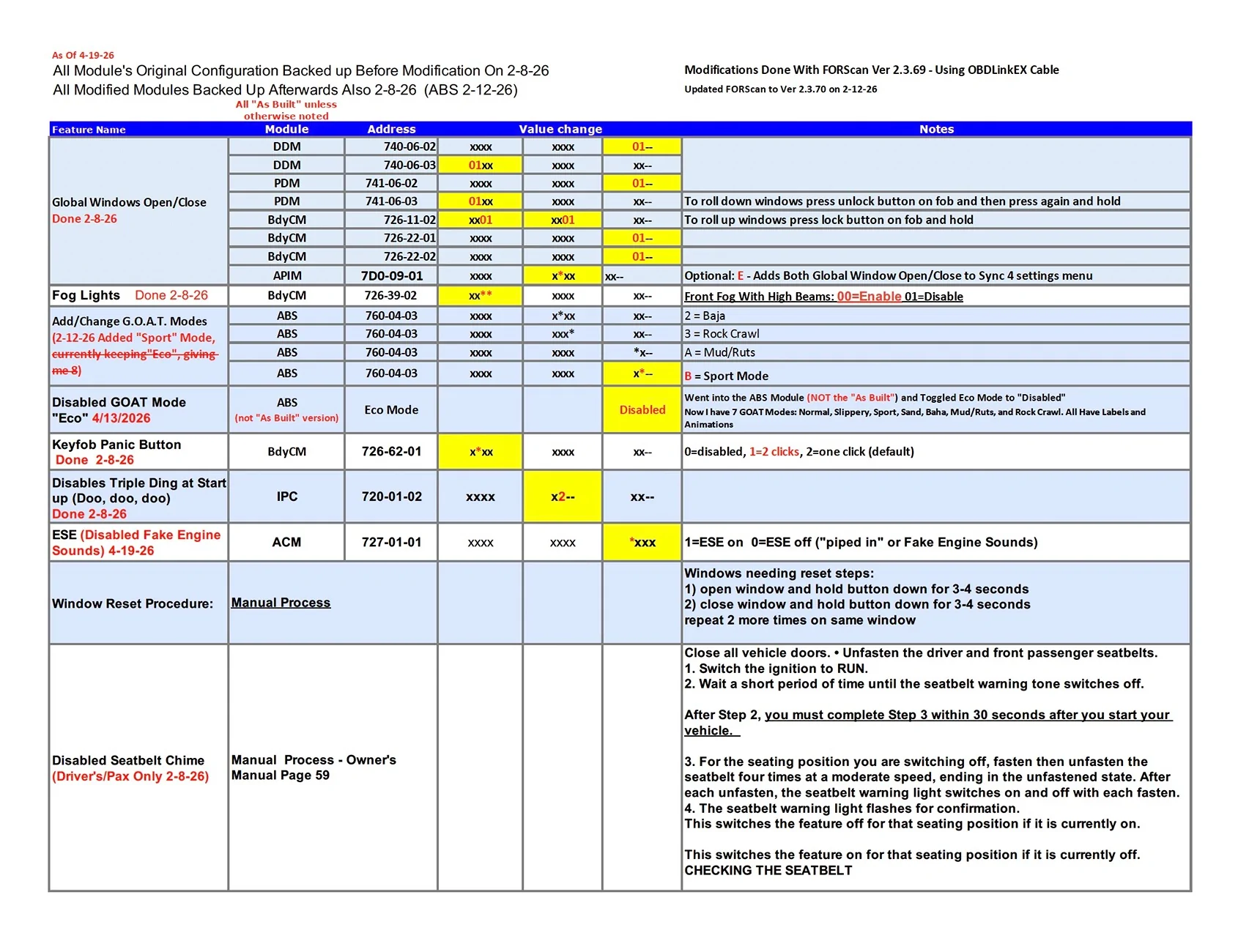

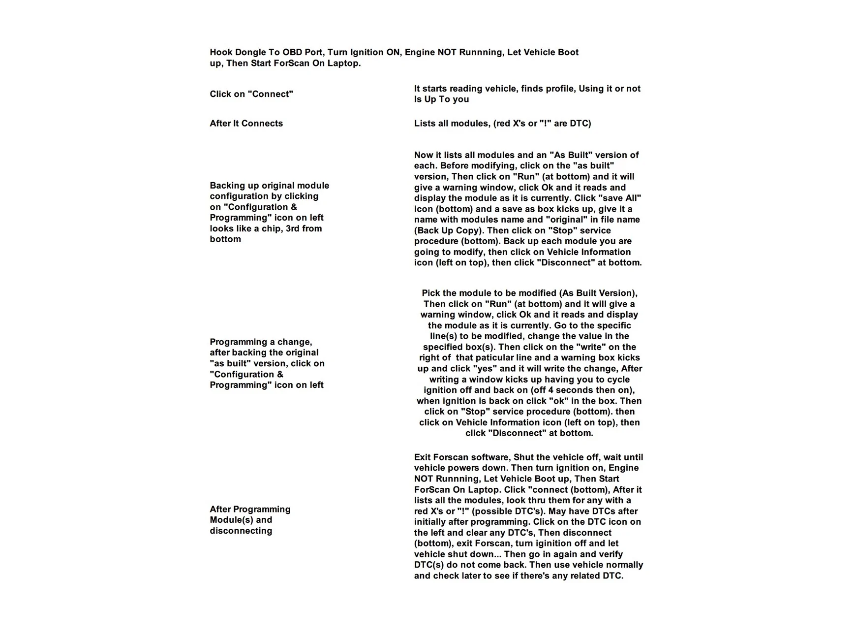

I also did several changes to other things... and after I get done with whatever I was doing I always turn the Bronco off and let it power down completely and set for a minute or two. Then turn the ignition on (not the engine) and check to see if it has kicked any codes, see what they are and clear them. Sometimes I would have codes at this point. Once I had "cleared" them, I would again turn the Bronco off and power down for a minute or two, then take it for a test spin testing whatever changes I had made. After that, and once everything was confirmed to be working as intended, I will check again to see if any codes are kicking up... and check again a week or so later just to be sure (OCD), and none have ever came back after they were initially cleared.
This is my "Cheat Sheet" and step by step for the changes I made to my '25 Badlands (if anyone sees inaccurate information, please let me know!)
Ford Bronco 2021+ Bronco ForScan Thread CheatSheet1
Ford Bronco 2021+ Bronco ForScan Thread CheatSheet2
Hope that answers your question....
