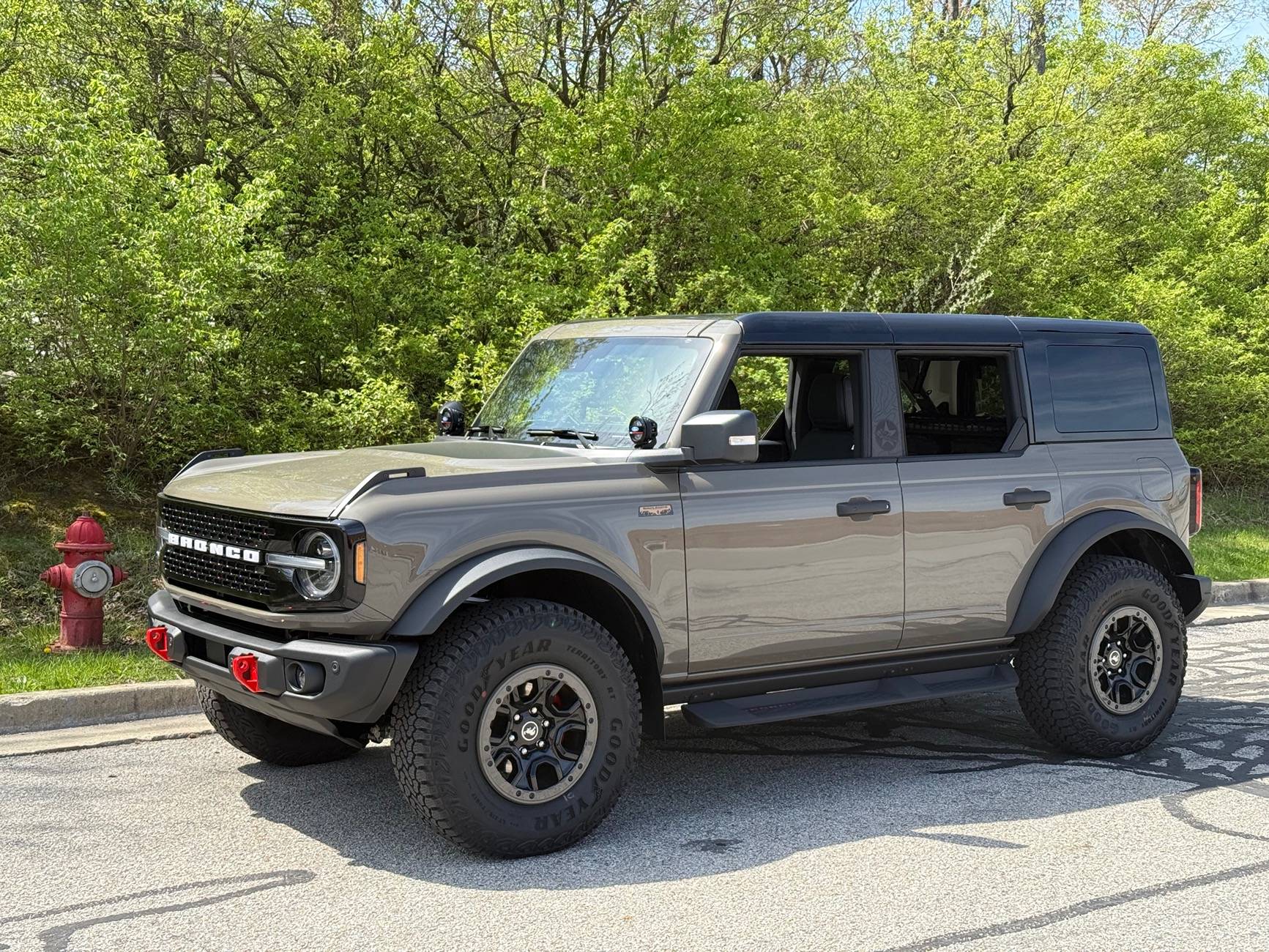

I would really like to add Sport Mode to my 2025 Badlands. Can't seem to find anyone capable, they say Forscan doesn't work on the 2025?
Thoughts?
