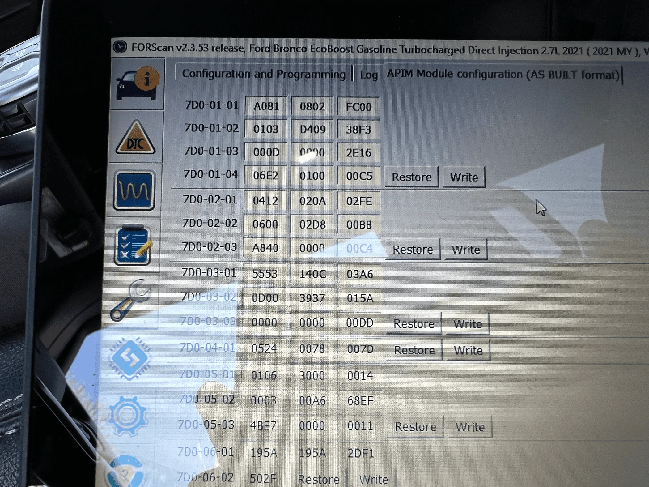

Can someone with ForScan look at their unmodified AsBuilt APIM for the original “Navigation in Motion” value? APIM Module 7D0-03-01. I am unable to find my original value. I changed the first two numbers to “57” to allow navigation searches during motion and I’m troubleshooting to see if this change (which is great!) caused my electronic “Owners Manual” to be deleted from SYNC “Features” screen.

Thanks! It appears that the value that you have in APIM module 7D0-03-01 is 5553 140C 03A6… I will verify that my Bronco is the same except that the second digit has been changed to a “7” on my module.
Thanks again, hope I can return the favor sometime.
Did changing it back return the owner manual?

Update…the change from 5753 back to 5553 worked for restoring my digital “Owners Manual” to my SYNC “Features” tab. It also restored Ford Assistant voice. Thanks again.
Yes, this change (or reversion) seems to solve the few issues that I had. My digital Owners Manual is back on the Features tab of the SYNC screen and my voice assistant is “back”. The ability to change destinations in Navigation while in motion is very handy, which is what the change to the APIM module allowed, but the features lost with that change don’t make it “worth it” to me.
Try 5653 and see if you get it all? 😜
