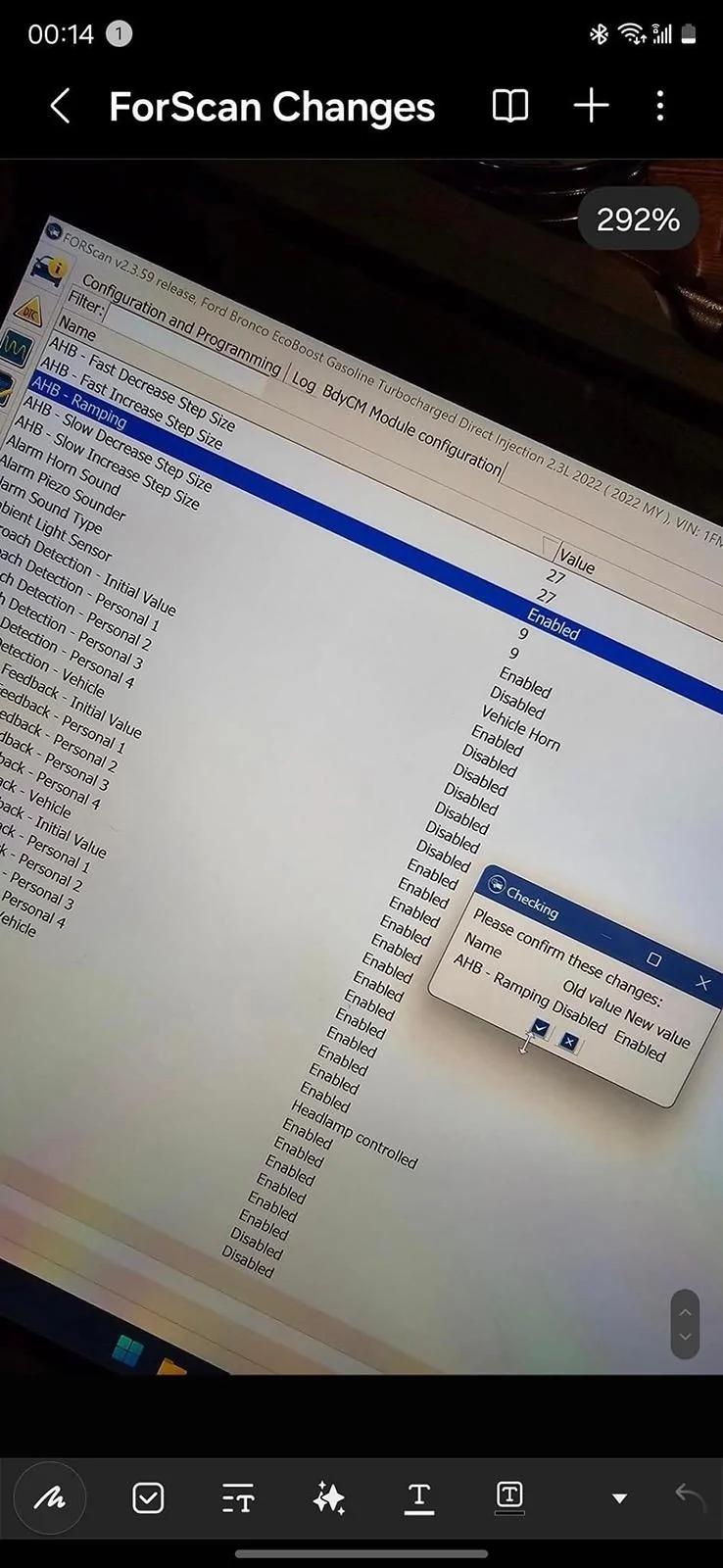

Saw this on FB. I guess some point in 2023 or so they made Auto High Beams fade on/off. My 2021 is very abrupt.
Interesting. My March '23 built Base would ramp on/off. It bugged me so I just turned the auto function off. My issue was I didn't notice the auto hi/low switching. So I often 'dimmed' my hi-beams when I was actually turning them on when traffic approached. Maybe I should just have more faith in the hi beam 'nanny'.
That’s an interesting outlook. Makes sense. Perhaps I’ll just leave it as is. I felt sometimes it’s on and off so much it’s like a strobe.
But, good to know you can disable it.
