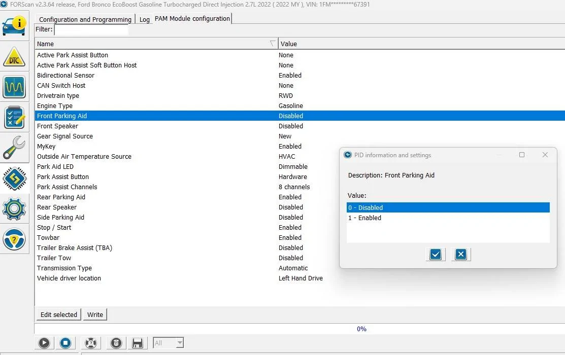

For those that have installed a bully bar or something similar and have to turn off the parking sensors every time you start your vehicle, there is a way around it that I found yesterday.
I went into the PAM (config) settings and found "Front parking aid". I simply clicked on it, changed it to "disabled", and followed the prompts from there. Now my rear sensors will still work while I don't have the constant annoying tone from the front ones when I forget to hit the button on startup!
