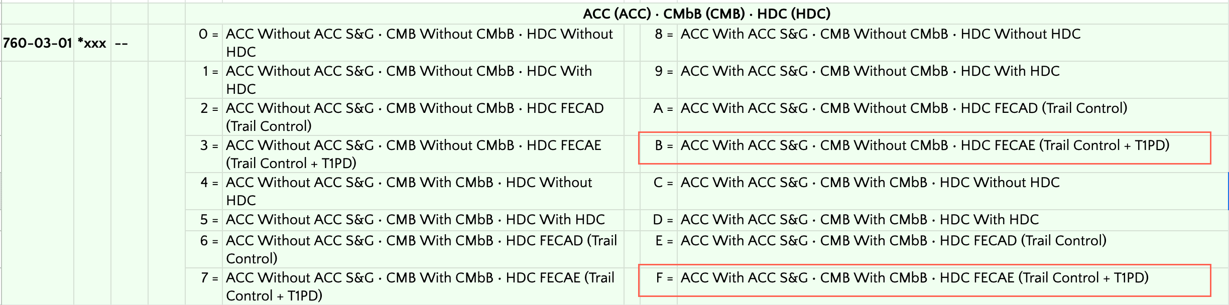

All - I'm working off this thread started by @MattInNash. I'd like to enable ACC with stop & go.
Here's the list of changes I've gathered so far.
ModuleDescriptionSettingValue
PCMPowertrain Control ModuleRelearn Central Programming-
BCMBody Control ModuleAdaptive Cruise ControlAdaptive Cruise Control, Stop and Go
APIMAccessory Protocol Interface ModuleIntelligent Adaptive CruiseEnabled
IPCInstrument Panel Control ModuleIntelligent Adaptive CruiseEnabled
IPMaImage Processing Module AAdaptive Cruise ControlEnabled
ABS???
I need help deciphering what to edit in the ABS module. Based on the Tremor/Raptor F-150 ABS module breakdown I believe I need to select one of the options in red below.
However I don't know what CMbB (CMB) and HDC (HDC) mean. Appreciate any insight. Cheers!
ABS???
HDC is hill descent control
CMbB is collision mitigation by braking
Just saying... LOL. ;)

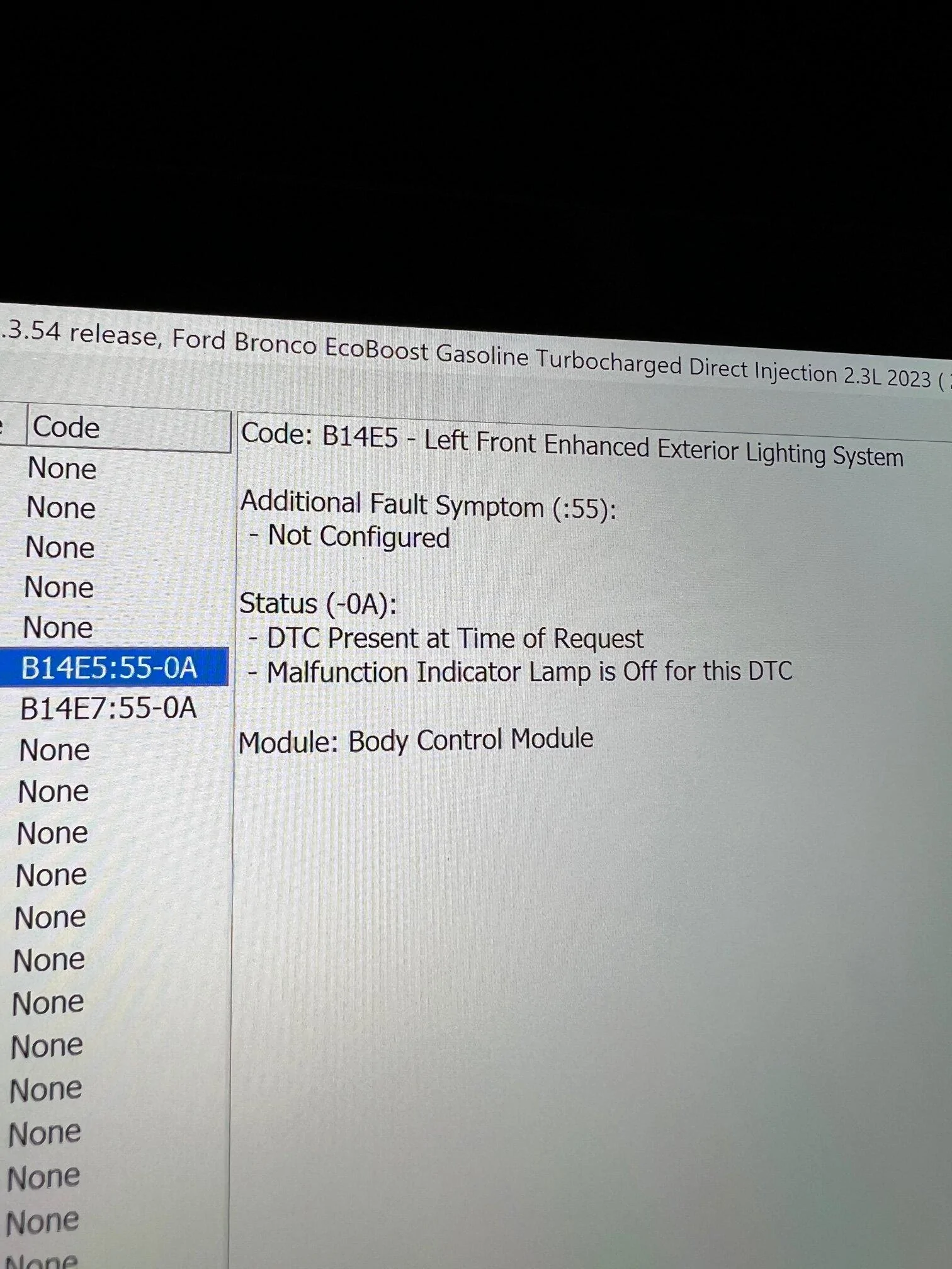

Newbie help needed! After swapping out my standard headlights for the signature headlights, I am getting 2 DTC error codes in Forscan. The first is B14E5:55-0A and B14E7:55-0A. These are for the left and right headlights and are basically stating that I have not configured these modules. Can someone who has the signature lighting tell me what their stock configuration is so that I can change mine and get rid of the error codes? Otherwise, the lights themselves do seem to be working properly with the exception of the ring leds not turning on when opening the door when the car is off ....it is just that the error codes keep popping up in Forscan. Community assistance would be greatly appreciated!
