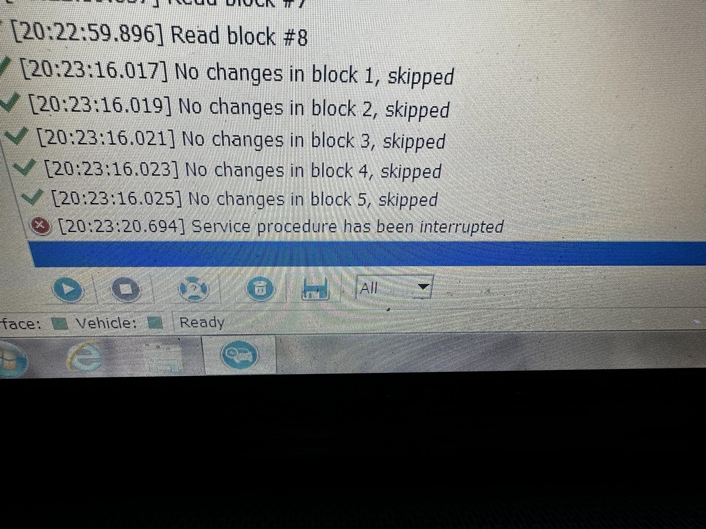

I also tried to do global windows and had an error on pcm and dcm modules where it said “service procedure has been interrupted.”
Ford Bronco 2021+ Bronco ForScan Thread AED722AA-D15E-4172-89BE-2C79B2CB4153
I tried multiple times and on multiple he easy click enable way as well as using the hexadecimal route and had the same results.

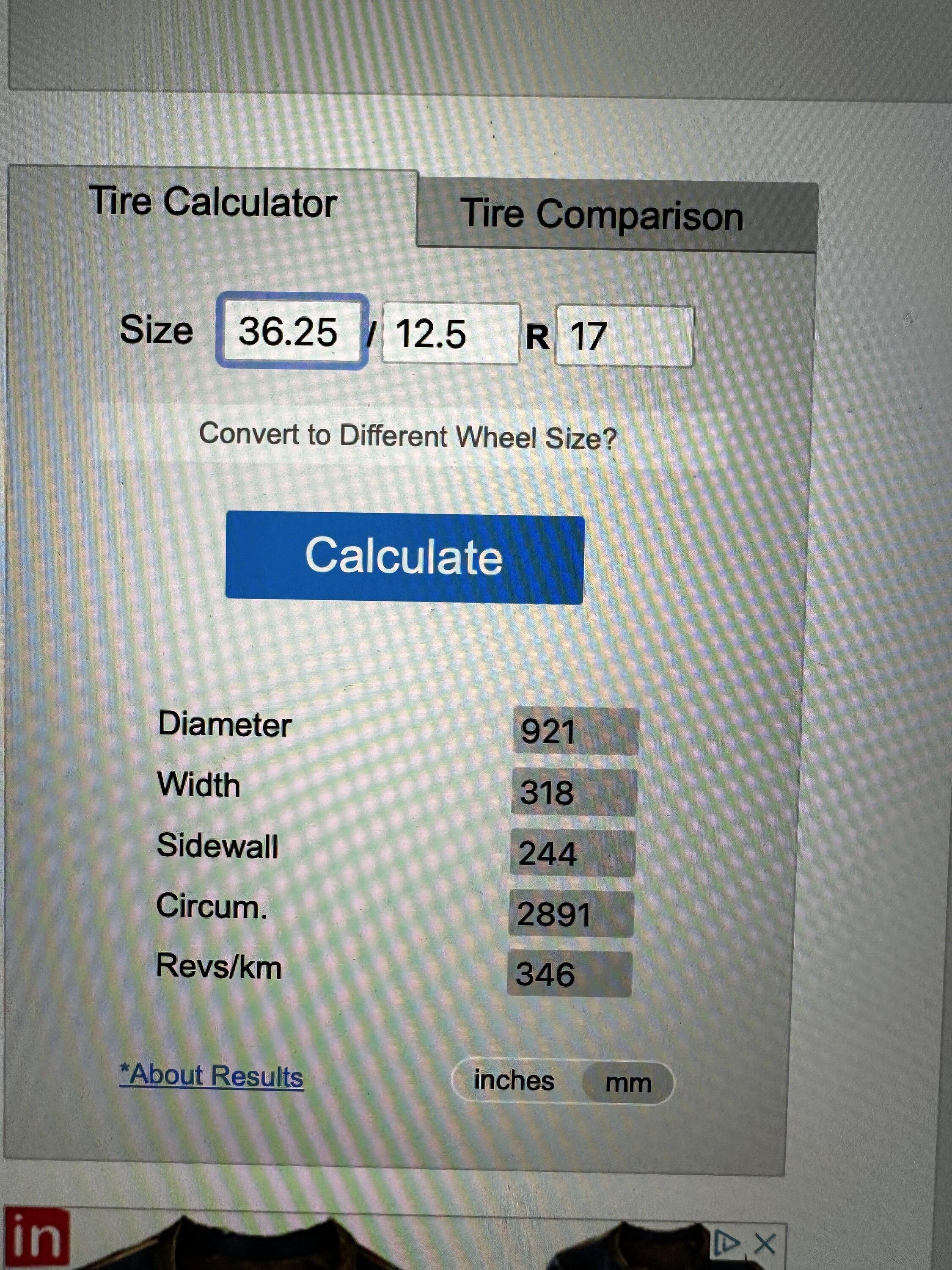

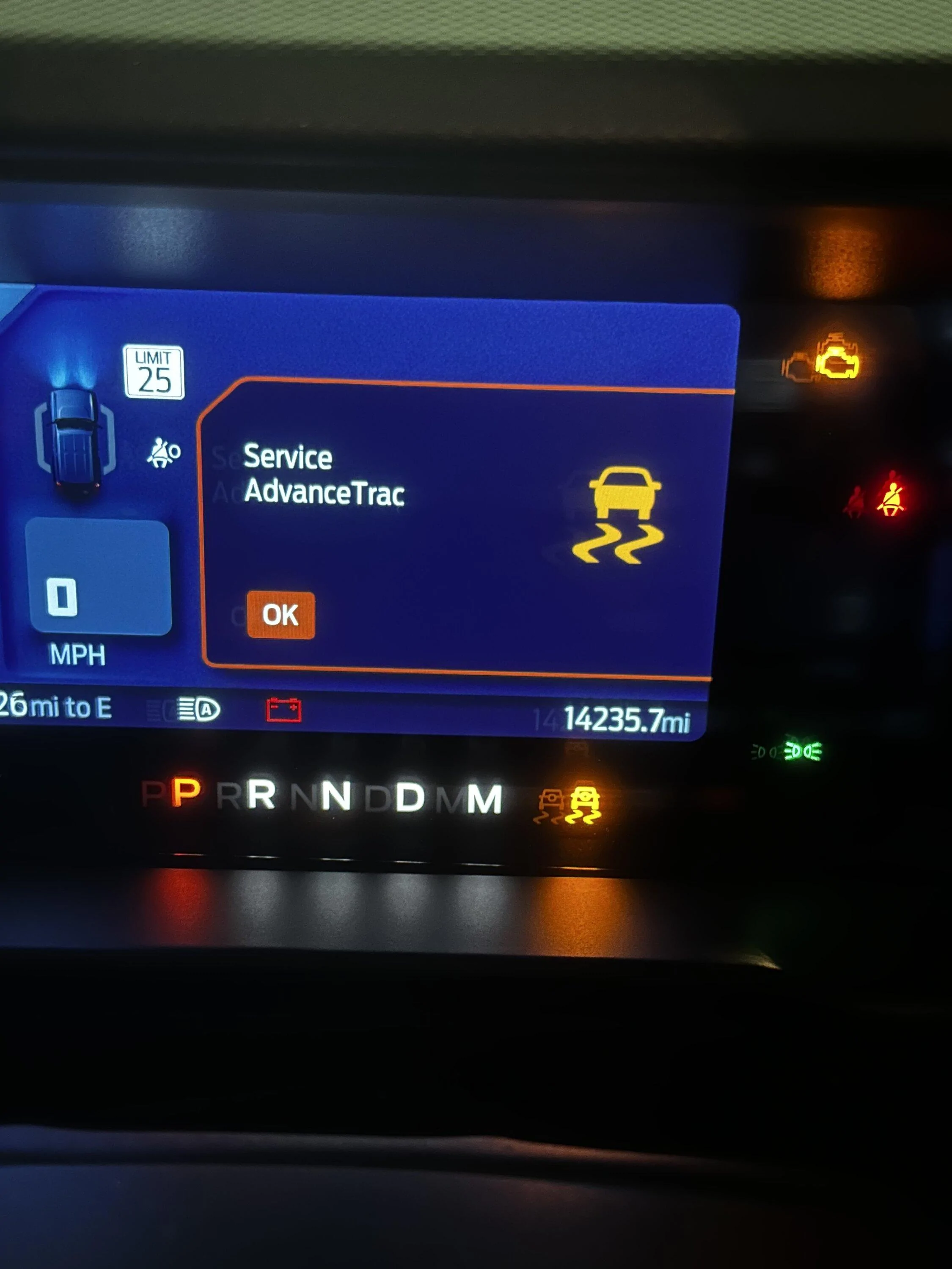

Any time I go over 2890 on the circumference a “Service AdvanceTrac” warning pops up on the dash. I’m supposed to be at 2911 for my tires (KM3 37’s with actual of 36.5”) but the calc shows max size I can really put before the warning is for 36.25” tires.
The calculations don't add up correctly for some reason, but 2911 is way to high and not possible. There is a limit to the size you can change.
Set it at 2800 and check it against a GPS app. This is where I have mine set with 37's and its perfect. It should be very close for you and then you can adjust it little by little from there.
Interesting. I wonder why the website would be off that much.
I’ll do the gps check and see where that gets me.
It's not the website that is wrong. Even with all the correct math, it just doesn't match up in forscan for some reason. Its almost like the programming in the module is just wrong or something, I'm not sure. Mine were suppose to be over 2900 also, but after a lot of trial and error the number needed was much lower.
Cool thanks I’ll give it a shot
I played with the tire size settings until the GPS matched the speed. All the math, and measurements in world doesn’t seem to matter with the Factory settings on these Broncos.
At least I know It is accurate as possible now!
