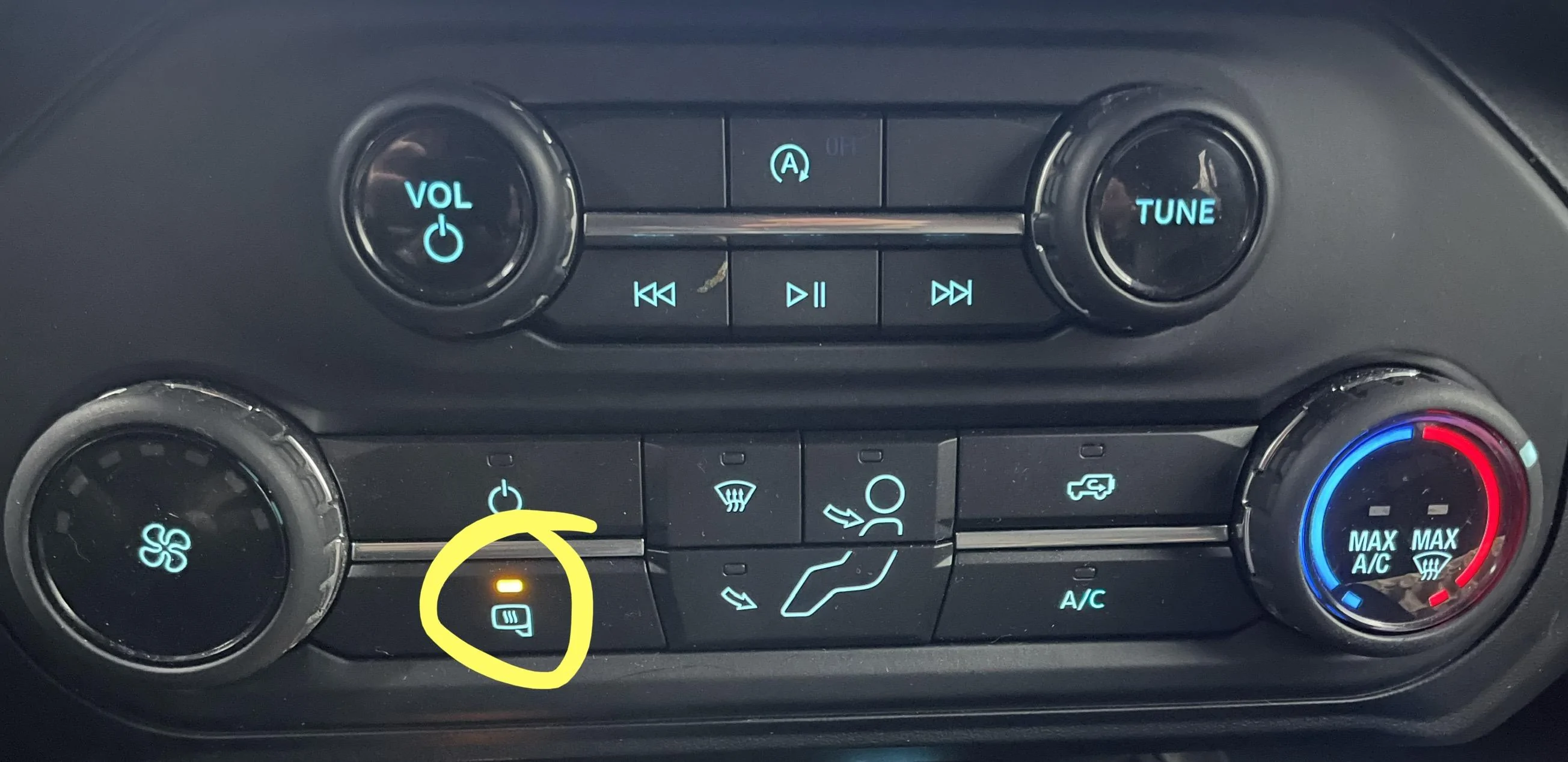

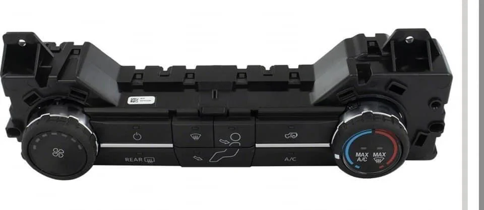

I am trying to enable Rear Defrost on my pre-prep-kit standard package model. I’ve installed the correct harness in the cargo to the hard top. I was successfully able to find, enable and write Rear Defrost in the APIM module, but it keeps giving me a “Service Procedure has been interrupted” when trying to write enabled in HVAC.
Really hoping I don’t need to buy new HVAC controls…as it seems there is a version that comes in all Standard models that looks like this:
Ford Bronco 2021+ Bronco ForScan Thread 44F0ADF6-8D1B-4029-8FDE-258EB315E7CF
When mine looks like this:
Ford Bronco 2021+ Bronco ForScan Thread B4E175F8-41D9-43C3-9A40-AF02C6E1838C
I would bet you are going to have to change that.. I had to buy new switch module to enable my front and rear fog lights
How annoying would that be. That version triggers both mirrors and rear. Wiring is in place. Just a pin missing or something?
I can understand the fogs - the buttons don’t exist on the switch. But, this is literally just a different icon.
I’m scared to ask how much they cost…
I’m waiting to hear back from Forscan if there is a Beta that will help. It has in the past…
If you know the part # take a look at tascaparts.com that's where I got mine
I think I narrowed it down....N2DZ19980L - $350!
