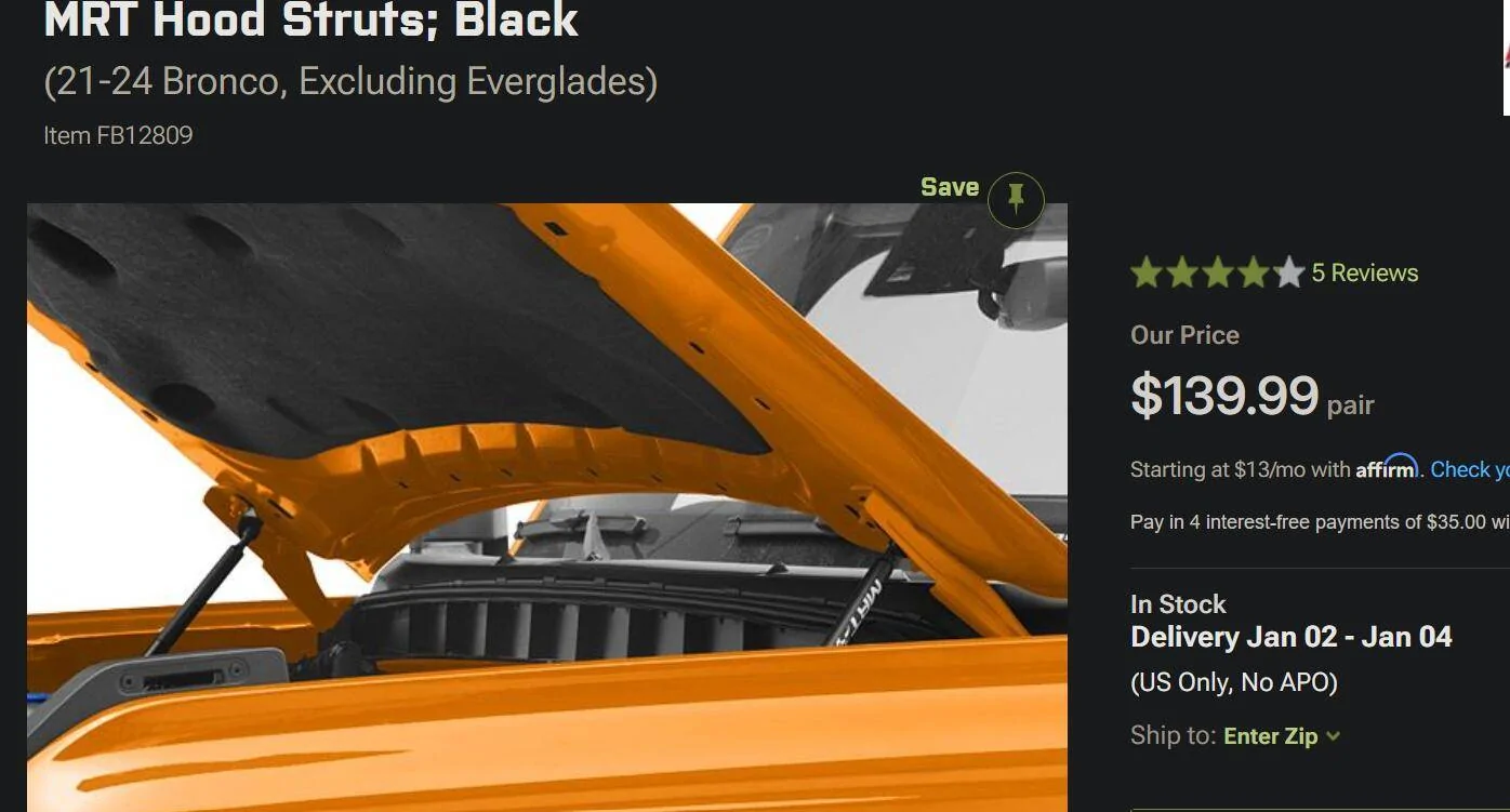

i like to wrench on my vehicles, and i went with the MRT
as they are completely out of the way once installed, and they work as required.

I went with the MRT hood struts. Dave and Dana are a pleasure to work with.
Thanks! I’ve been looking for something like this for the carbon hood on my Raptor. I’ve got redlines on our 2 door l, but they won’t work on the carbon hood.
