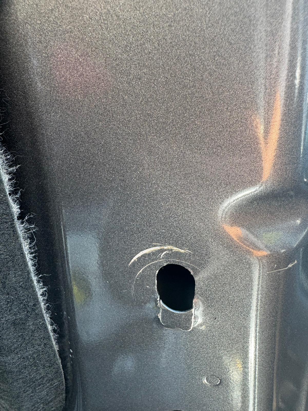

Personally, I like the idea of the strut pushing on the hinge instead of the hood.
Agreed. I also like the idea of the force being distributed across two points in a bracket instead of going to just one ball mount in the hood. I didn’t realize this until after I had hood struts installed, with the design of just one ball mount in the hood. Mine began to separate from the attachment point in the thin aluminum of the hood. If you have this type of design, regardless of brand, I would keep an eye on your hood attachment points, especially before and after long road trips or off roading. I removed and went with MRT’s design instead.
