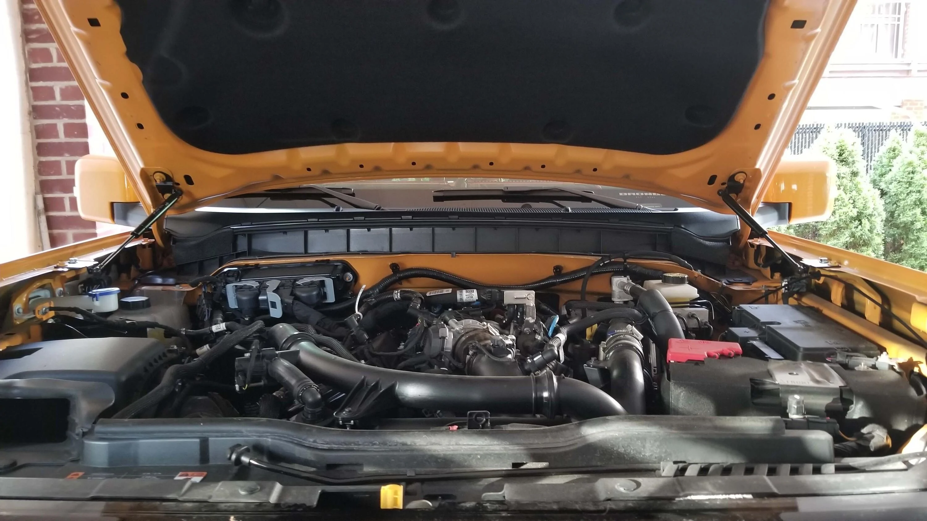

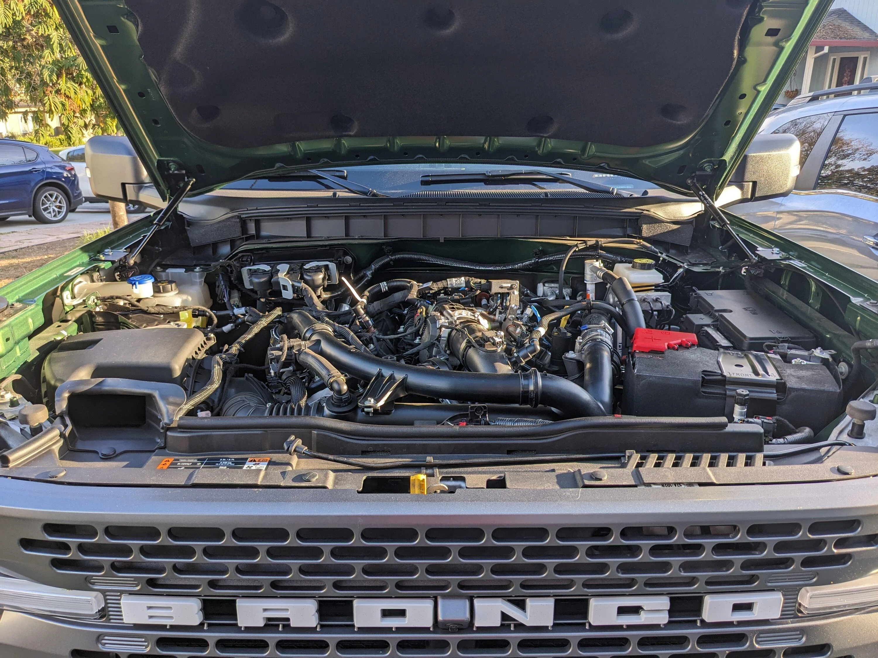

Installed my Steeda hood shocks.
Just a heads up. The Steeda installation instructions are wrong. The gas shock should be on the hood side, not the fender side. I spoke with a Steeda customer service rep, and he confirmed the instruction sheet is wrong. #5 says to orient the gas shock to the fender end. The gas cylider should be at the hood attachment point.
Wish I read this about 30 minutes ago! I installed the Steeda struts per the instructions, and immediately noticed something was wrong. I'm glad I didn't slam the hood, or there would have been some damage
@Murraydog11 - Do you still have any interference with the hood when closing? It's hard to see in the attached photo, but both the strut ball on the engine bay mount and the strut cylinder make direct contact with my hood when closing it.
Ford Bronco Hood struts: which ones to get? PXL_20221029_234749986

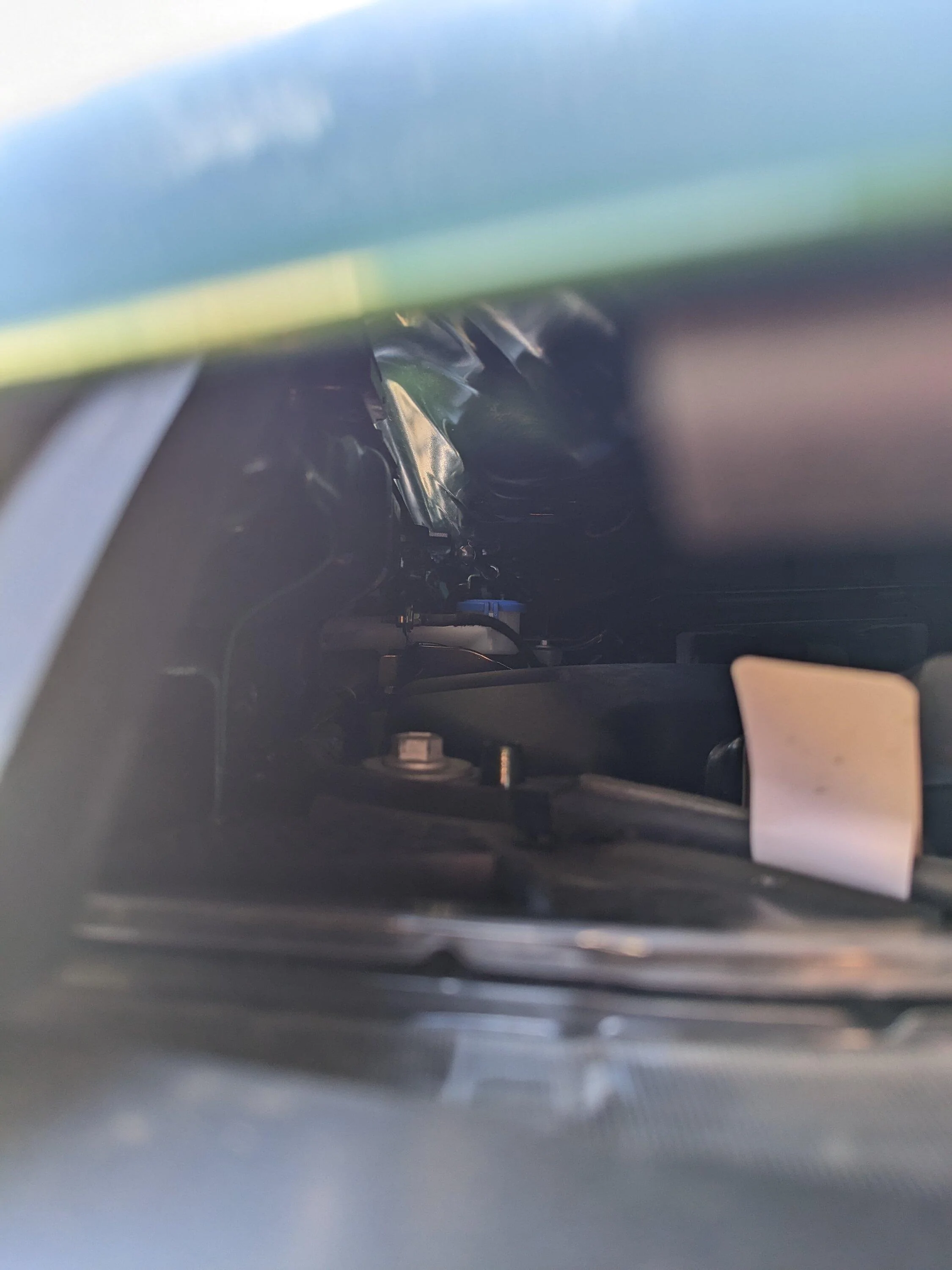

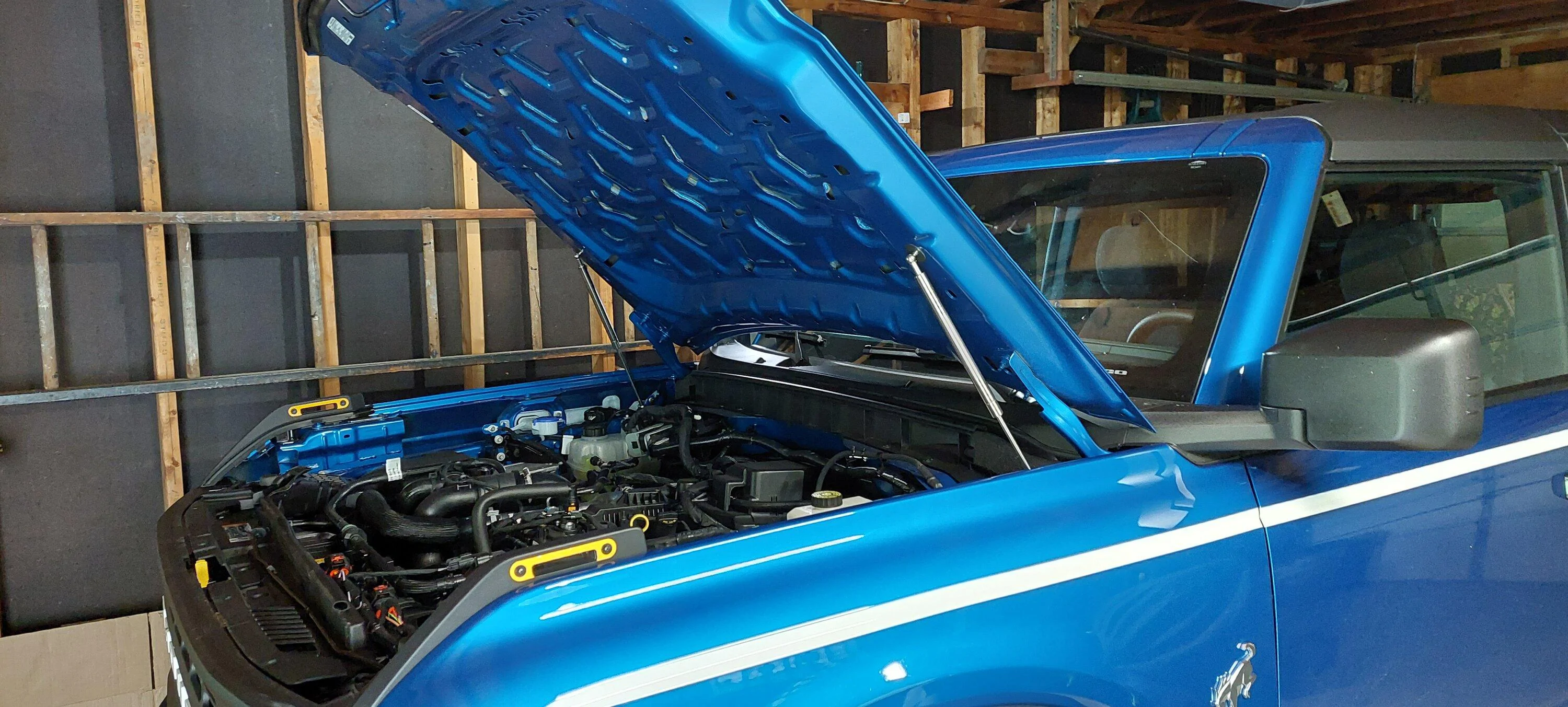

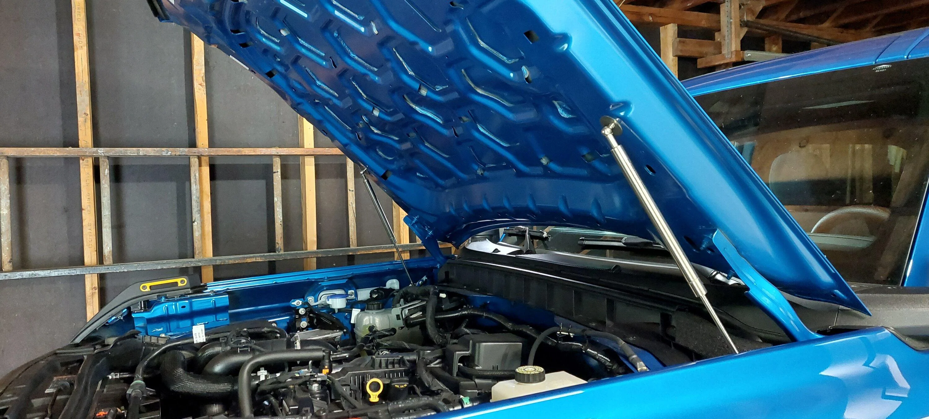

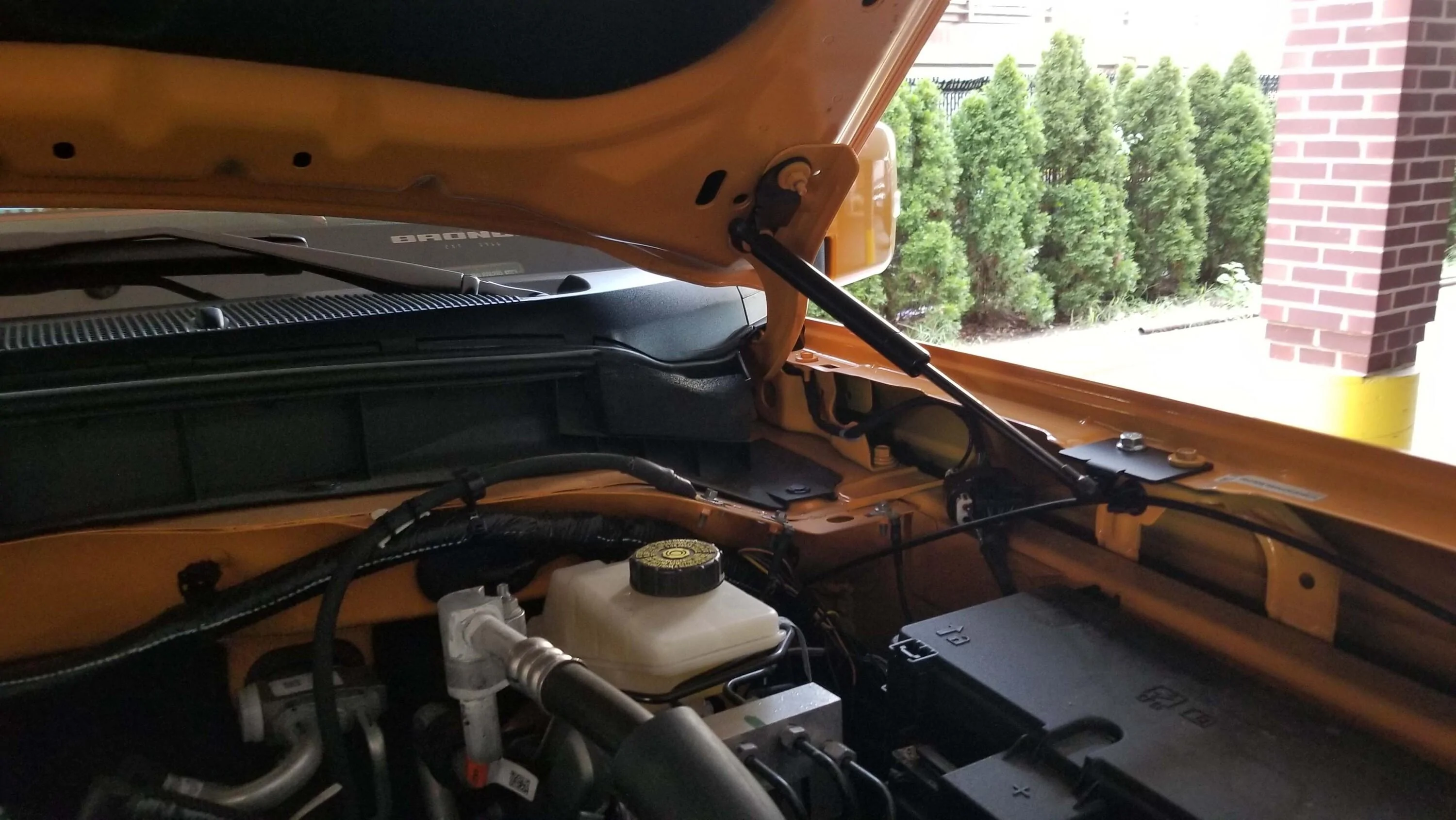

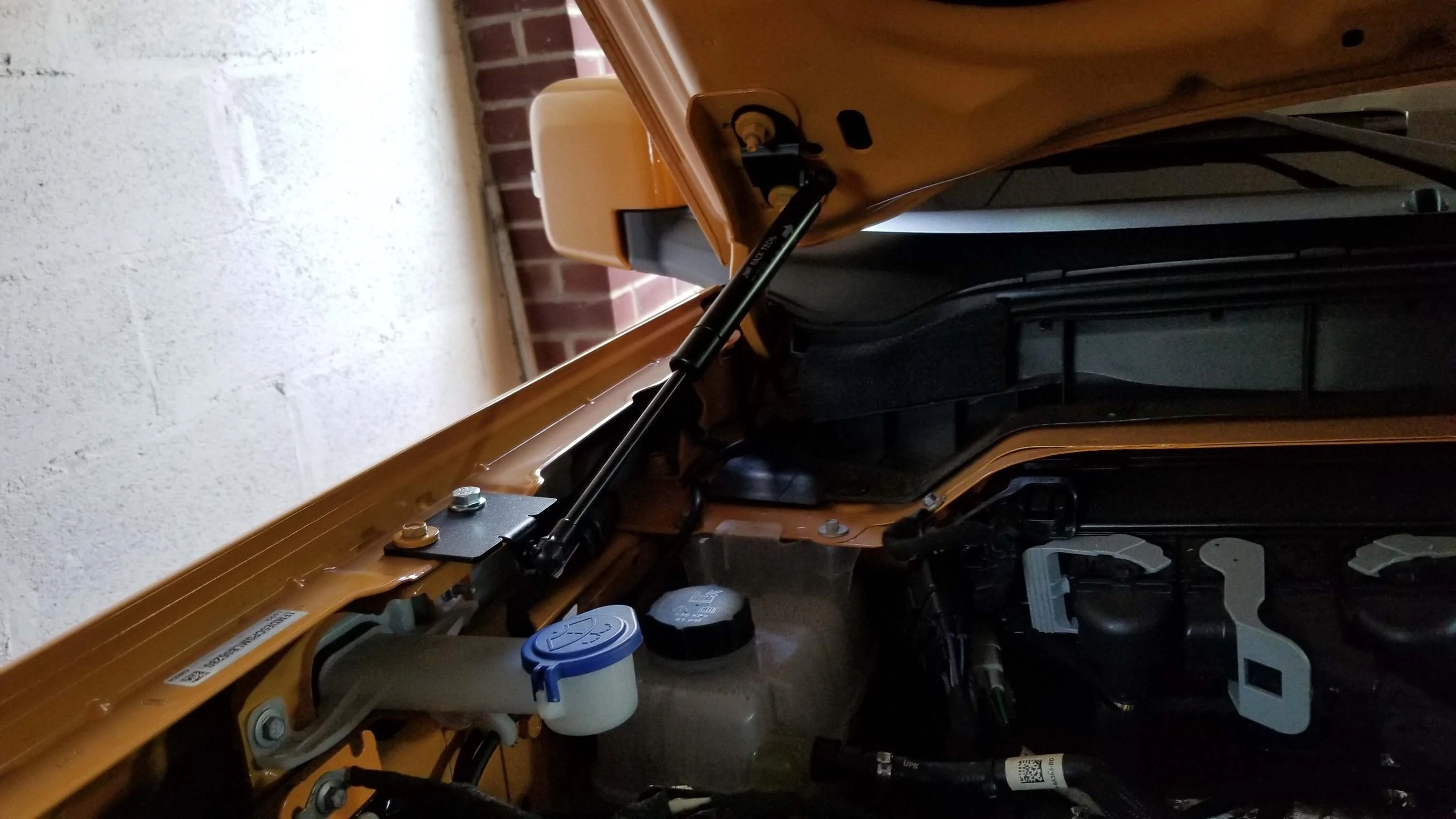

@Steeda we have a problem. Same setup as @Murraydog11 and the hood will not close. Uninstalling until I figure out what is going wrong here.
Ford Bronco Hood struts: which ones to get? PXL_20221030_000115692
Ford Bronco Hood struts: which ones to get? PXL_20221030_000326116
Hmmm... I did not have any binding at all. I spoke with Steeda before my initial install.

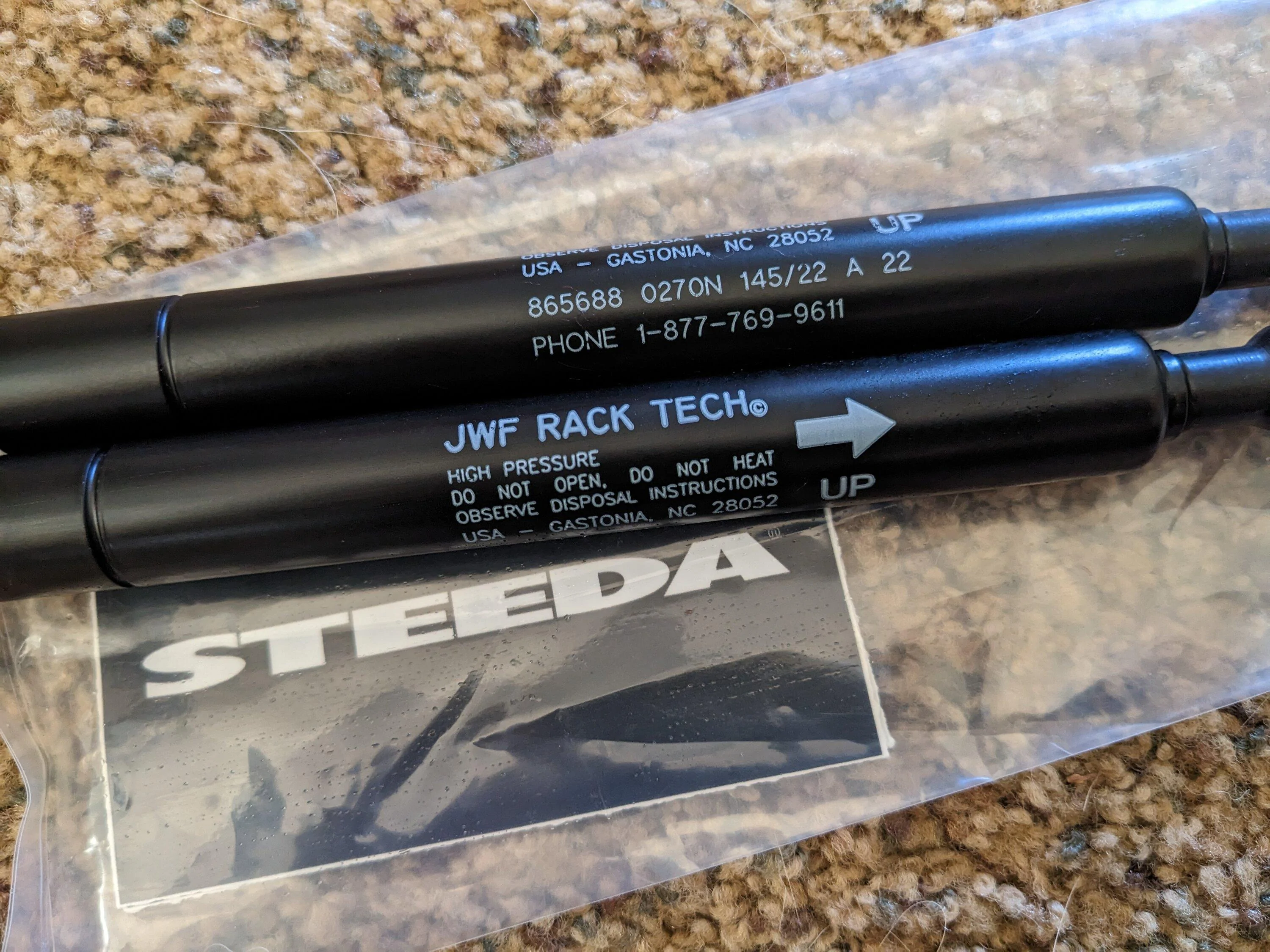

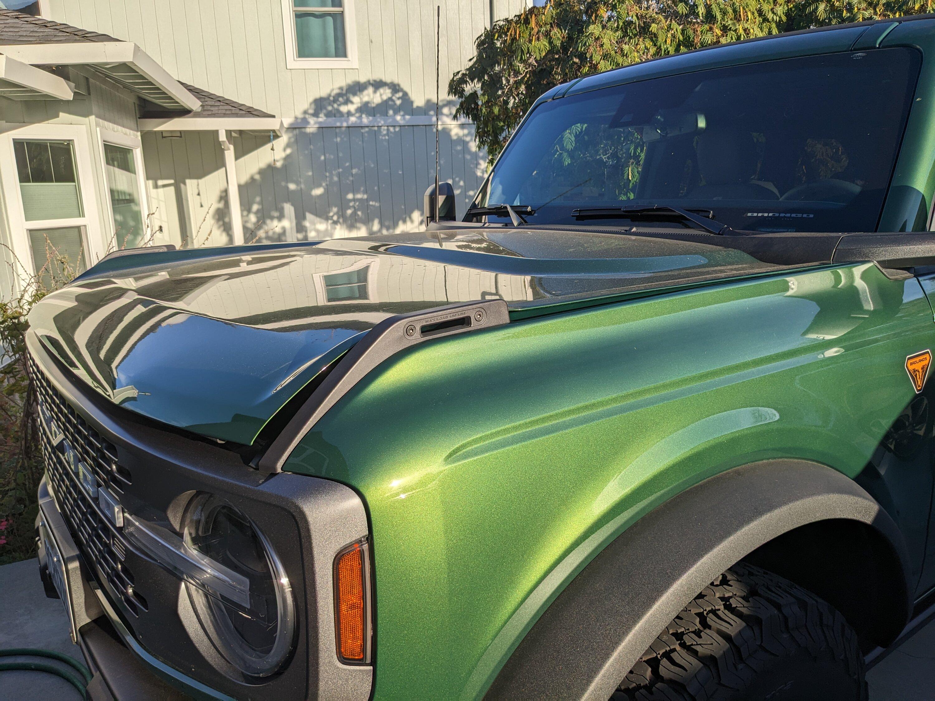

Thanks for confirming. I'll give Steeda a call on Monday, but it looks like this is getting returned for something that works with no mechanical interference!
Side note: The phone number printed on the side of the struts is JWF Technologies in Hamilton, Ohio, so it will be interesting to see how this is handled.
Ford Bronco Hood struts: which ones to get? PXL_20221030_153206614
Yeah, I checked that out before I called them. JWF Technologies looks like they're a wholesale distributor. I went through the website, and it's really hard to even find this piston. Steeda seems legit. I didn't expect that they built everything in house. I was more about the fact that these are Ford approved. That way, if they blew something out, I'd have a fighting chance with warranty work...
