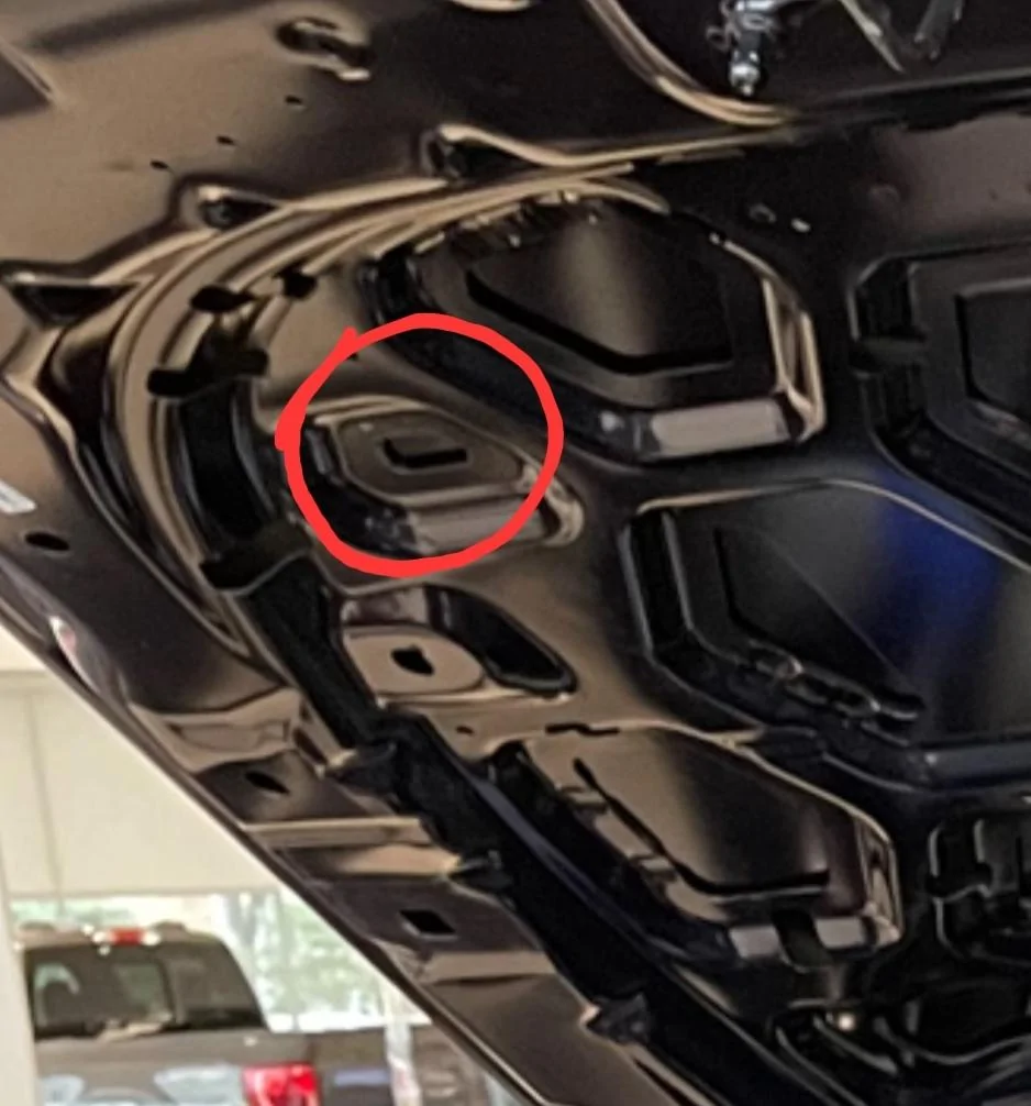

How about this for a 1-up. I dropped one of Rough Country's flat sided nuts for their hood prop kit (it's terrible people, don't buy it) in this hole (that's where they tell you to route their hardware for the install). I've accepted the fact that I'll never fish that thing out.
Their kit also damaged my hood, but that's a whole other topic for another forum.
Ford Bronco Dropped a socket while installing hood prop rods... Screenshot_20220306-054906_Chrom

Ha! I did the same thing. Removing the liner did the trick. Just had to remove the bottom 3 or 4 pins near the door and it was visible then my trusty 8 year old was able to get his hand in there. Haha.
Those retainer pins are crap and don’t unscrew really. Just plan to replace them.
I mentioned THESE the other day.
Also, get used to pulling the flares. You’ll want to clean behind them every wash. As long as the latches are in the right direction - just pull straight out. I’ve forgotten one here and there and pulled pretty hard and not broken them or bent fender. Just turn and try again. It will pop as mentioned above.

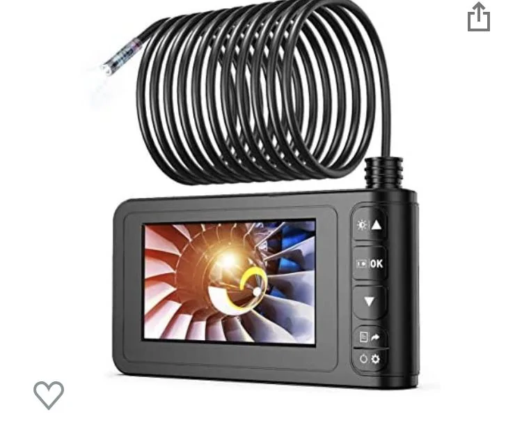

Ford Bronco Dropped a socket while installing hood prop rods... 2B7CA4FE-6FD9-4AA4-8B81-3EAE34FAFA72
I got one of these off of Amazon when I lost a bolt inside another car. It’s a camera with a light and a magnet

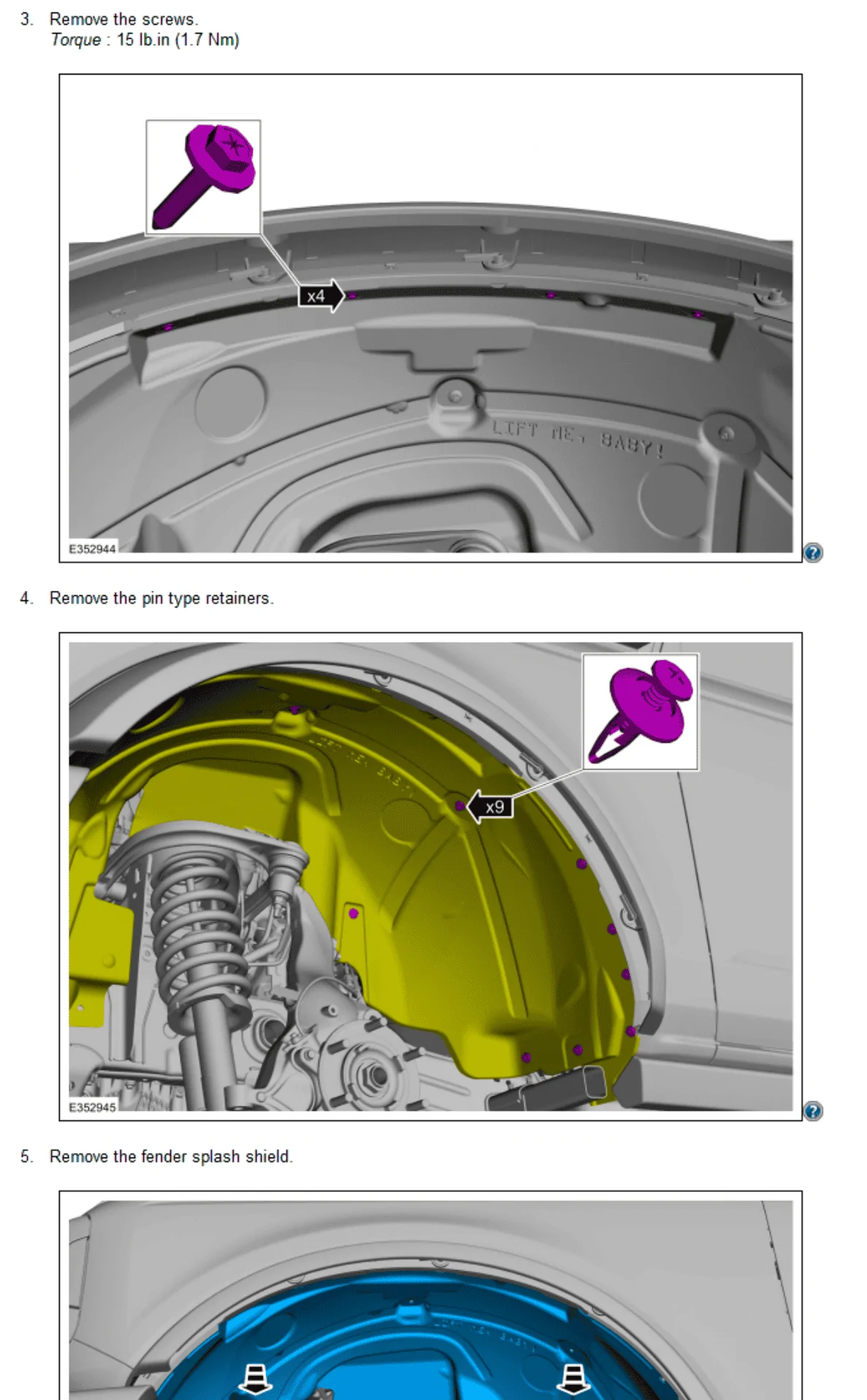

Remove the tire and fender liner (splash shield). 4 screws and a dozen push pins. No matter where it is, you will be able to reach it, assuming is doesn't just fall out.
I 2nd this solution.
