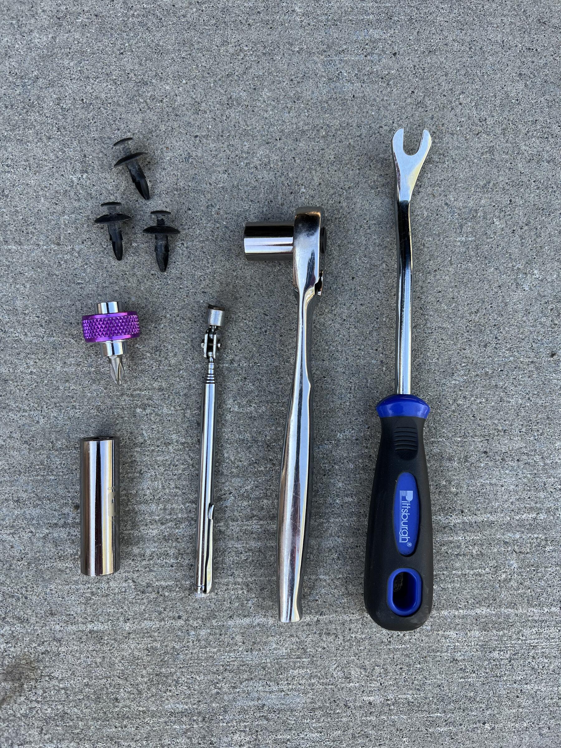

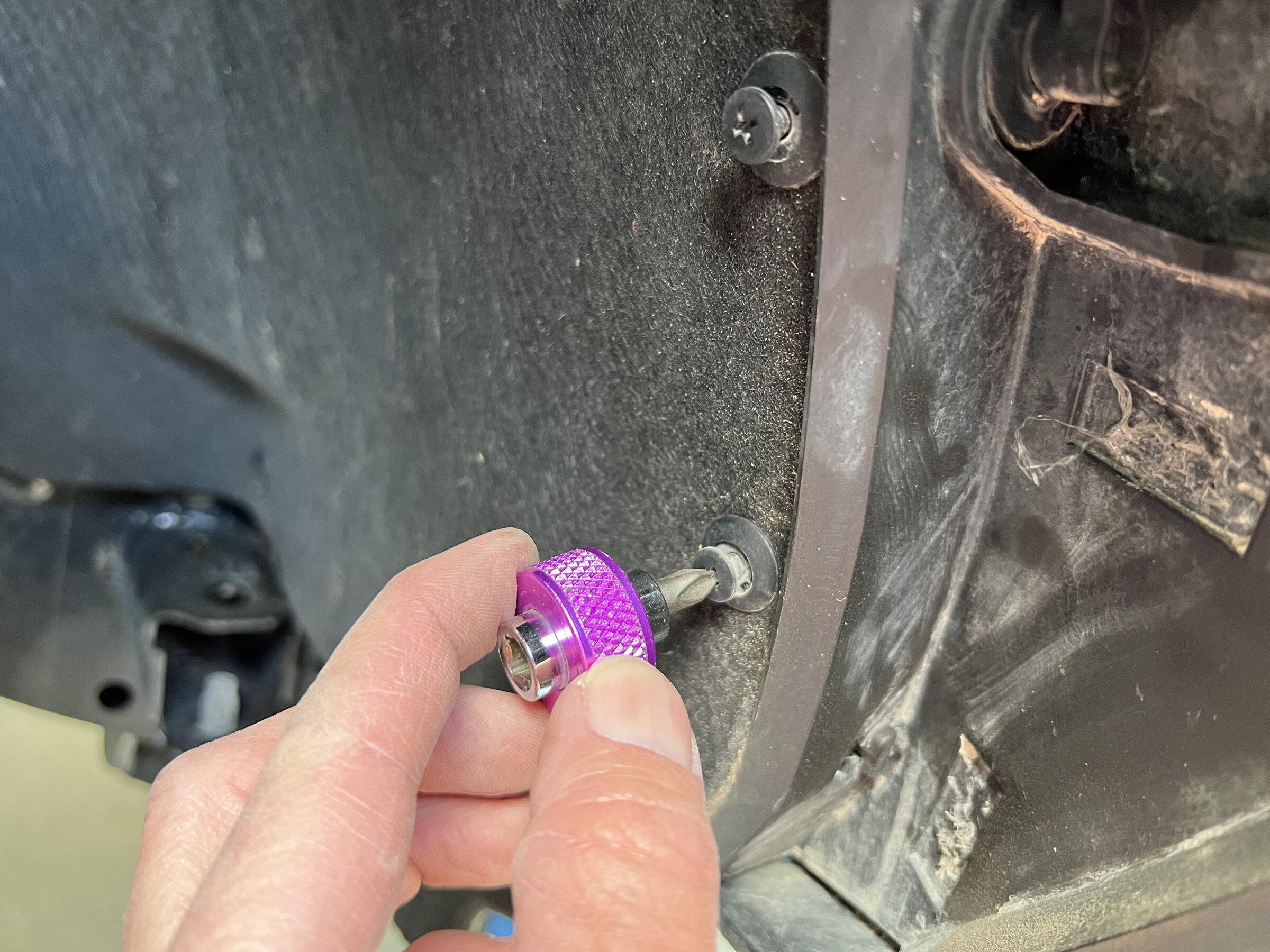

If you hold the base of the screw pin as you're unscrewing the center it will usually back out. Then use the panel popper to get her pulled.

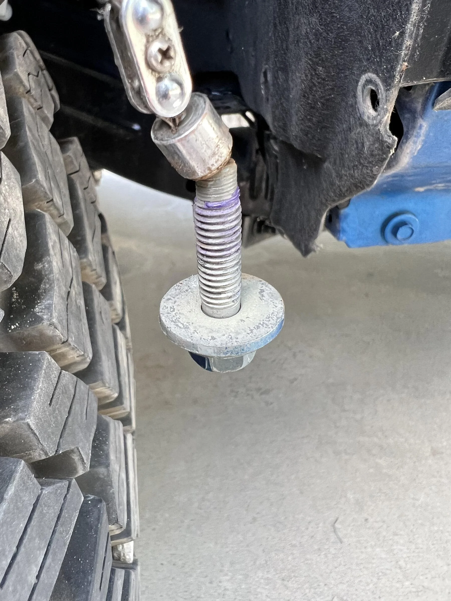

Step 1: Remove about three of the pins and reach around until you find the magnetic rod you dropped. Use the rod to fish around more towards the door until you stick the bolt you dropped. DO NOT PUT THE LINER BACK TOGETHER YET.
Step 2: Attempt to bolt the bracket again and then drop the bolt one more time. From the opening in the liner - use the magnetic rod to fish around until you find the bolt (hint: its not in the same place you found it last time).
Step 3: Third times a charm. Thread the bolt in without dropping it for reals this time.
Step 4: Move onto passenger side. Hold bolt from the top with magnetic rod. With the other hand hold the bracket in place. Using rod - position the bolt into hole once brackets is lined up. DO NOT ATTEMPT TO DROP BOLT DOWN FENDER. You already did that on the other side.
Here is the arsenal you'll need:

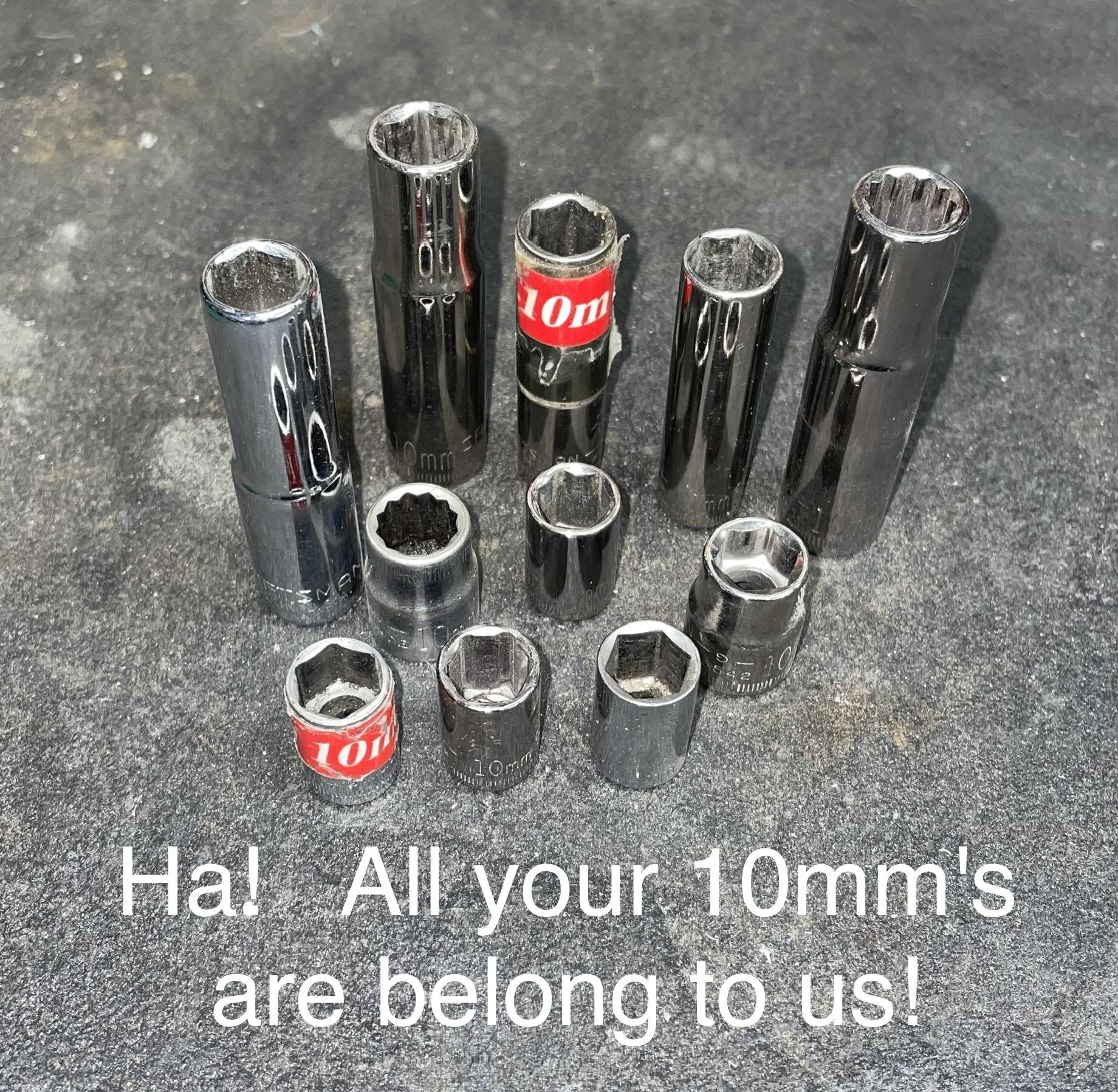

The 9/16th of the metric world. Frequent use and tend to disappear like a fart in the wind when you need them the most...
Good to know I'm not the only one. It's like the "sock" of the automotive world. Socket kits should just come with extra 10MM sockets!
