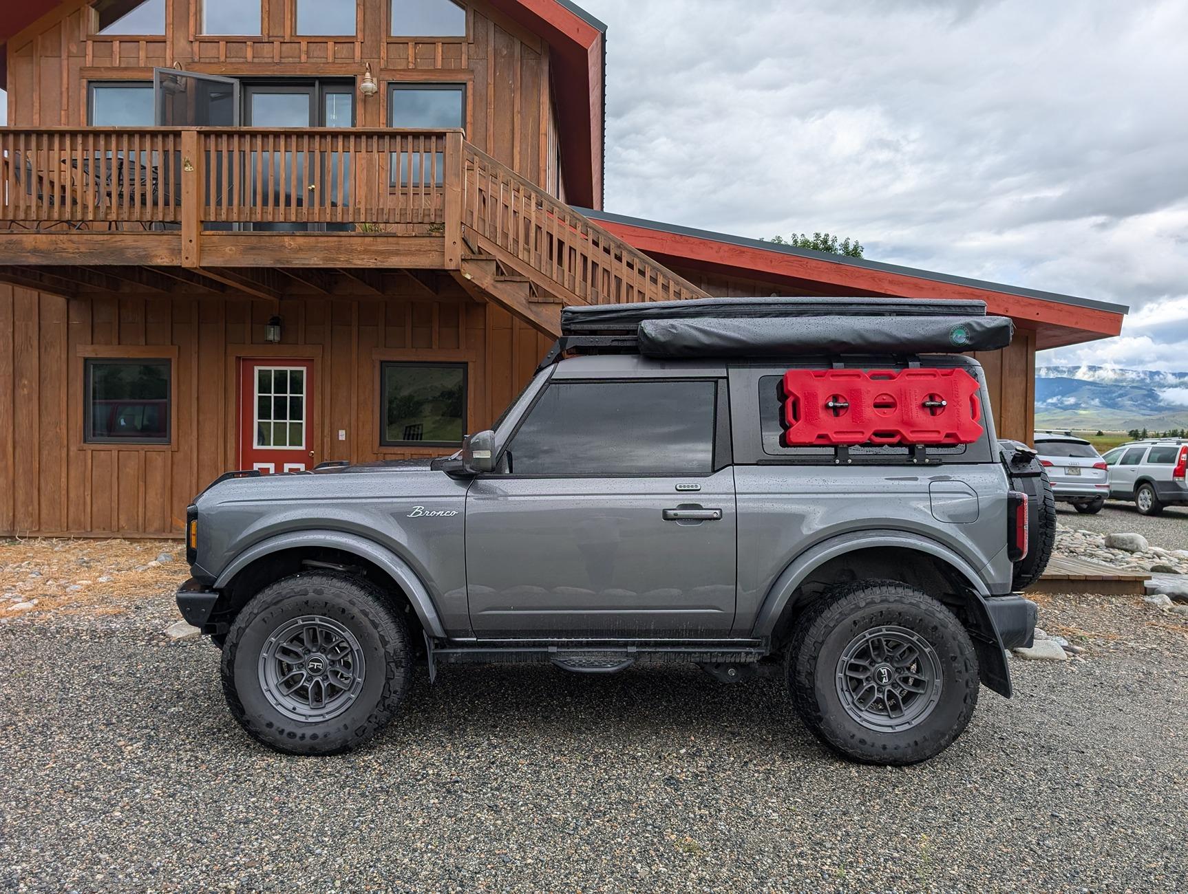

You are right about the Gas tank being way too small... That is why I had to modify a spare delete to carry two 3 gallon rotopax. I am getting right around 13... (I still drive with a heavy foot, and probably will till the day I die considering how my great Uncle drove well into his 90s/with a very heavy foot. Opposite of most old people) which really sucks with a 16 gal tank. Off road I do like just slowly tooling along though.
Ford Bronco Regearing and doing 37s right PXL_20240701_154258811.MP
I carry 4 gallons, but have capacity for three more two gallon rotopaxs. I normally have 4 gallons of fuel and six gallons of water while overlanding.
