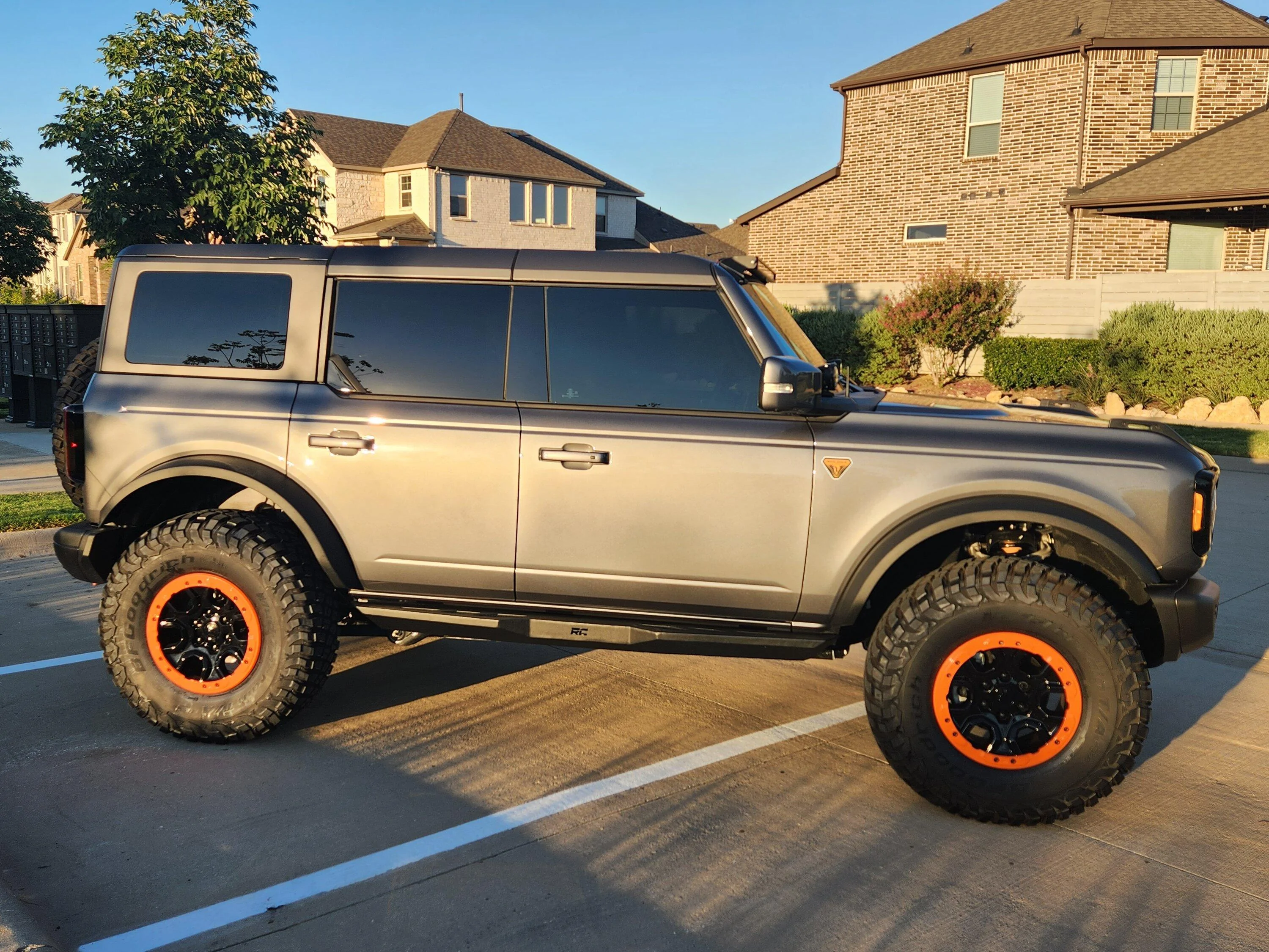

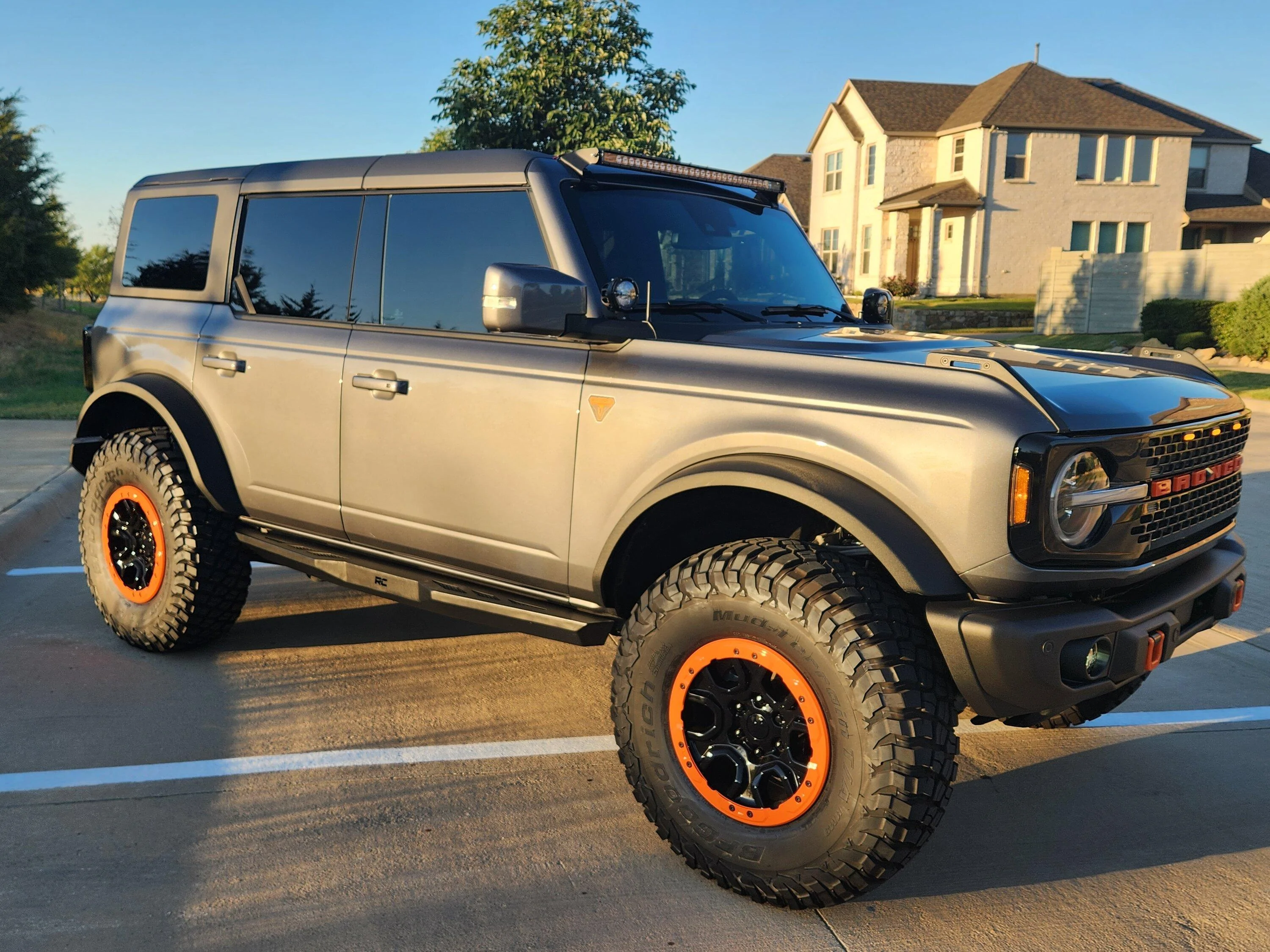

Running 6112s with 37" BFG KM3 MTs on MY23 Badlands Sasquatch. I did the JKS Max tire clearance kit, and have 1/4" Bora hub centric spacers on stock SAS wheels. No rub at full lock. Love the ride quality of the 6112s over stock SAS Bilsteins.

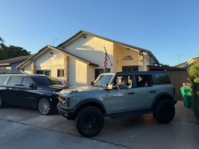

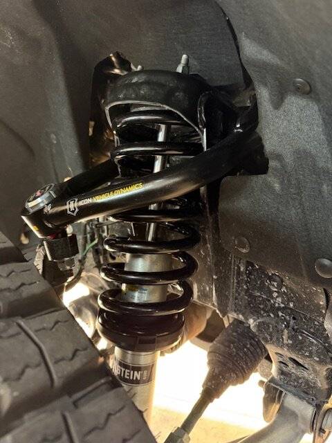

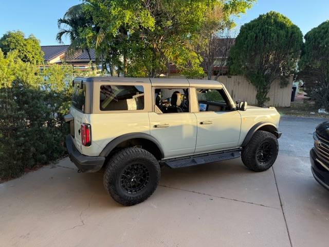

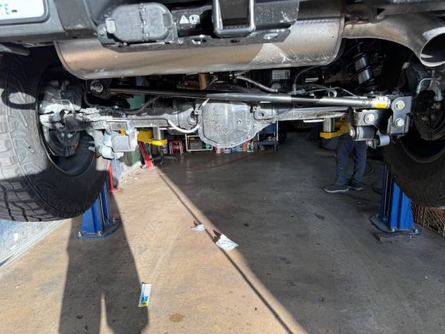

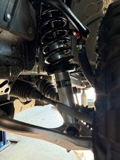

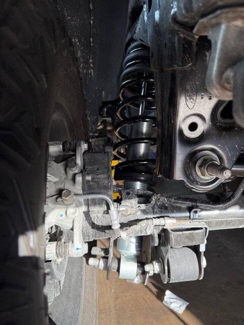

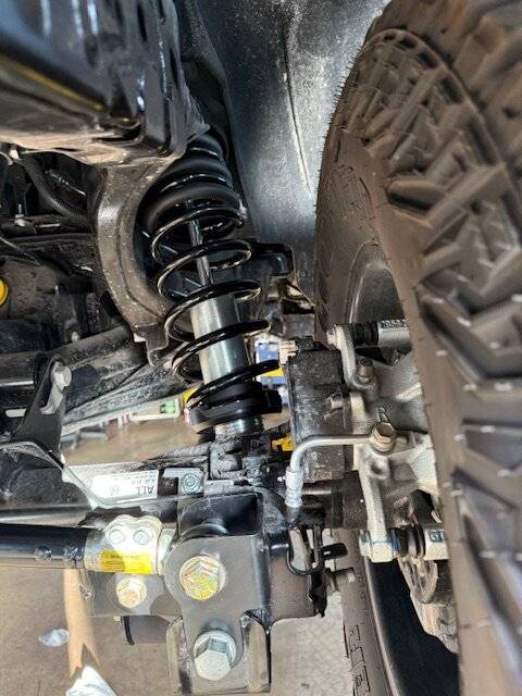

I swapped out my hoss 2.0 suspension for Bilstein 6112's. i am using both front and rear on number 6 (max) and i am using an icon UCA. i also installed the rock jock track bar relocation kit and an icon adjustable track bar to tighten up the rear. my rig handles better than stock on road and feels like a sports car on turns. Off road it soaks up the big bumps way better than the hoss 2.0. I am on 35s currently, but im swapping over to 38's this summer. I plan on doing a 2 inch body lift, the jks big tire kit, and Rear upper and lower links (metalcloak or rock jock not sure yet) installed after my amp steps get installed.
