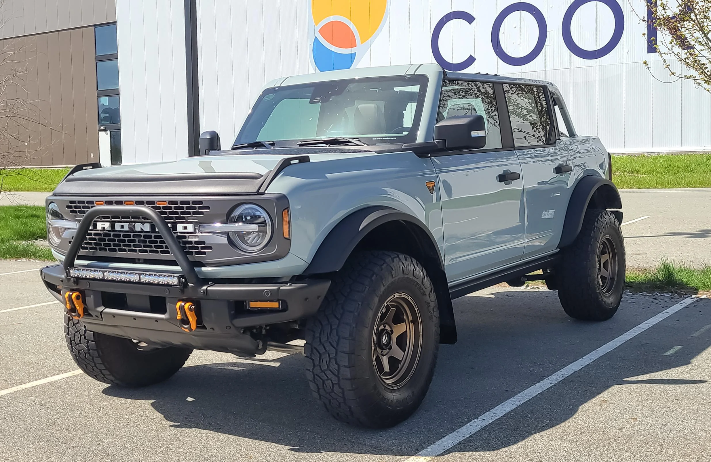

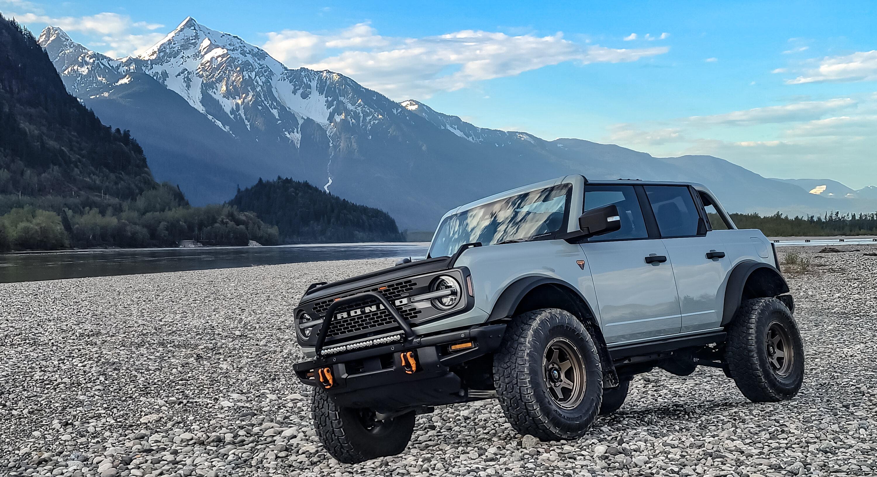

This is my Badlands on non Sas springs on the 5th clip front and back. 35x12.5x17's.
Ford Bronco Anyone install Bilstein 6112s ? 20230427_143350
Ford Bronco Anyone install Bilstein 6112s ? PSX_20230428_164209
Ford Bronco Anyone install Bilstein 6112s ? PSX_20230430_224803

Looks good. How does it sit with clip 5 in the front? I’m changing from 4/5 to 5/5 this week.
These are 6112s that come with the spring right?

No these are factory badlands springs. Non Sas. I get a little lean as well and it's about 1/2" to 3/4" lower than I expected as well.
