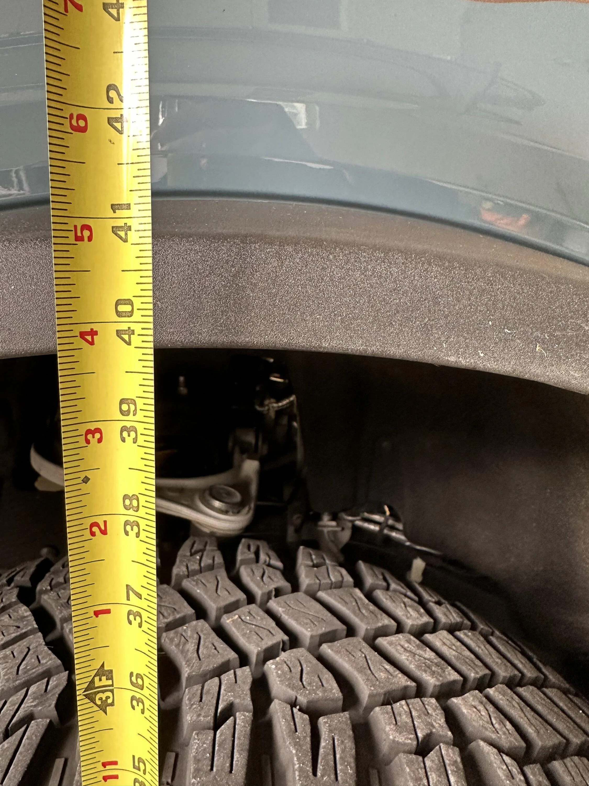

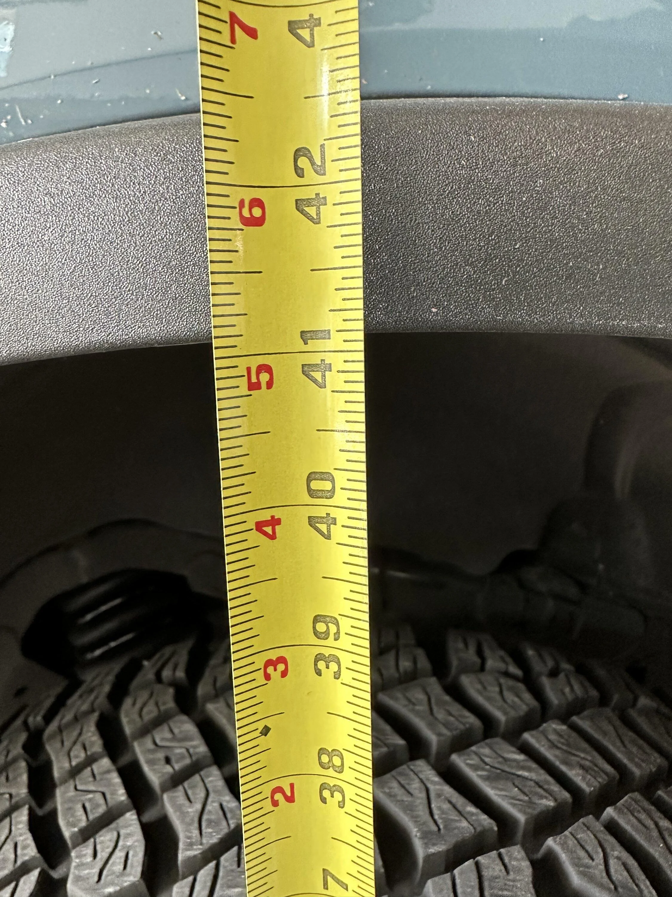

Here are my measurements after installing 6112s (see images) Probably closer to an 1.25 difference between front and rear.
clip 4 front netted roughly an 1 in (advertised 1.8 in gain)
clip 5 rear netted roughly 1.25 in (advertised 1.2 in gain)
Stock was 39 front and 40 rear ground to fender.
still not sure why my front gain was so “minimal” compared to billstein advertised. no added weight over stock SAS. Hoping that changing to clip 5 in the front will give me what I’m looking for. I loaded up the cargo area with all my gear roughly 200lbs and sag was about 1/2 inch. When I go to clip 5 front I should be just about level when fully loaded.

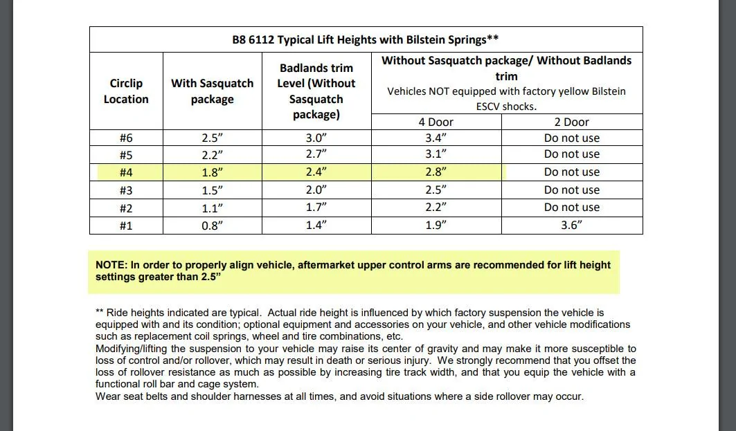

I don't understand why the Bilstein charts say that raising the Bronco more than 2.5" requires a new UCA, but it's my understanding that people lift Sasquatch Broncos 2" all of the time without a new UCA... And I thought that both the SAS, Base, Black Diamond, all have the same upper and lower control arms.. So wouldn't that mean that raising the SAS 2" would be the same as rasing the Black Diamond 3.1" ??
I will not be doing the install myself, and I don't want to pay twice to have the circlip moved up or down to get the desired ride height. I'm tempted to go 4front/4rear for the clip but that puts me at 2.8" lift hypothetical, but don't know what I'll actually be getting with the 2.7L, etc...

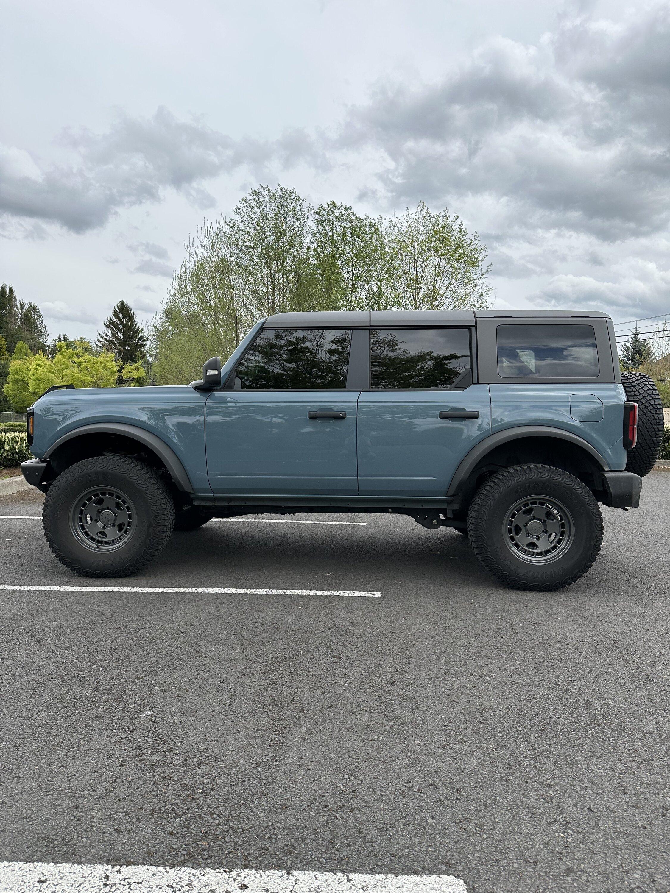

Went up to clip 6 in the front and stayed at 5 in the rear.
drove roughly 300 miles after going from 4 to 6 in the front and remeasured.
Clip 6 front: 40.25in
Clip 5 rear: 41.25in
I netted 1.25in at the highest clip setting in the front. Started at 39in stock SAS with no additional weight up front.
I am somewhat disappointed that I couldn’t get another .5 out of the front when bilstein is advertising a 2.5in gain over stock SAS haha. I have an inch of rake with no rear cargo. I went camping this weekend and loaded the cargo area down and with all my gear I sagged about half an inch.
oh well…. Overall I am happy with the performance just wish I could have netted slightly more lift in the front.

So I plan on setting the 6112s at clip 6 which is 1.7 inch lift in the front and clip 6 in rear which is 1.4 inch lift. I will add a winch in the front and have some equipment in the back so I figure setting should be maximum on front and rear, if anyone has suggestions if the rearnshould be 5 please let me know why. I also plan on getting 0 offset wheels and true 35s so they will stick out more. Do I still need to install the UCAs with this setup? I AM so confused on all this now. If UCA is recommended who makes the best ones? I AM currently leaning towards ICON but not sure if this is wasting money as I am not going to 37 inch tires just true 35s with 0mm offset wheel. I heard factory UCAs are pretty decent but don't want to risk anything.
87-Z28
Andy
Sep 1, 2022
1,225
2,959
BMW
You should not need UCAs. You should be able to get it aligned to spec.
