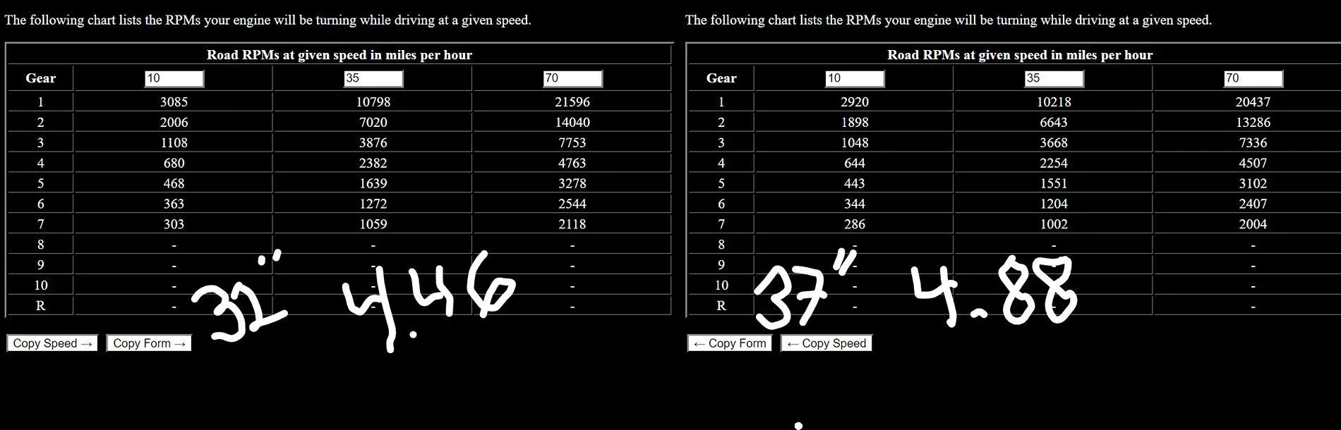

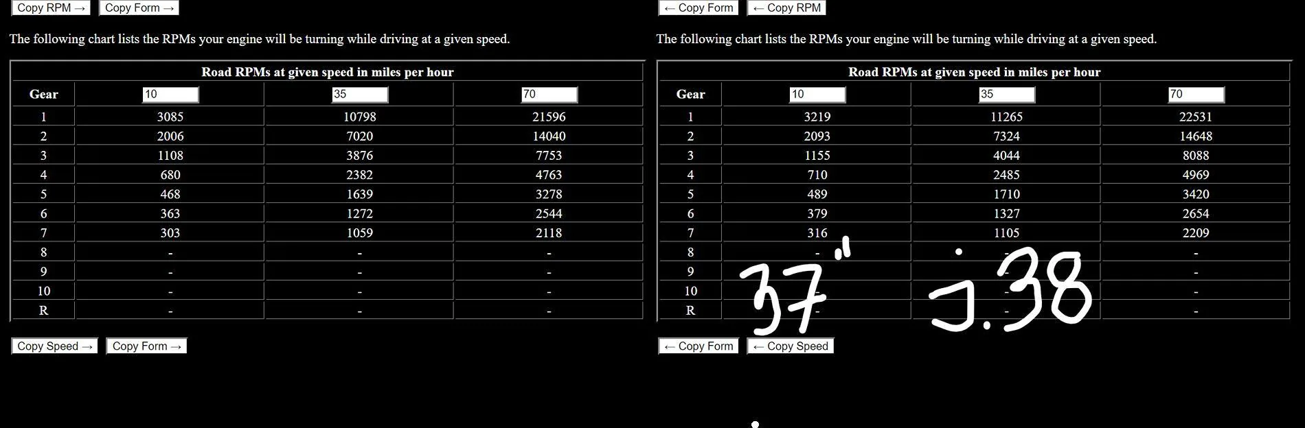

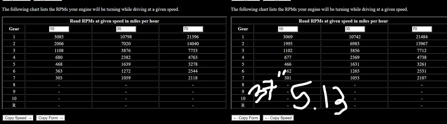

http://www.grimmjeeper.com/gears.html
Plug in your OEM gearing and tire size on the left, then experiment with 37s and the different gear ratios on the right.
The best way to do this is look at RPMs across different tire sizes and gearing.
You want to stay close to factory RPM, but remember you are turning heavier tires, so it is ok to have MORE RPM at the same speed than less. You do not want less RPM, that will make your Bronco feel very sluggish.
You absolutely have the have the front and rear gearing match.
37s are very tough on the M190, it does not have the torque capacity to safely handle them. So yes, you really should upgrade to a M210 before going with 37s.
I echo everyone else recommending the Ford Performance tune. It is excellent for the 2.3l and really excellent for the 7MT.
Do it right the first time
Pay to play
Buy once, cry once, etc
EDIT I DID IT FOR YOU
