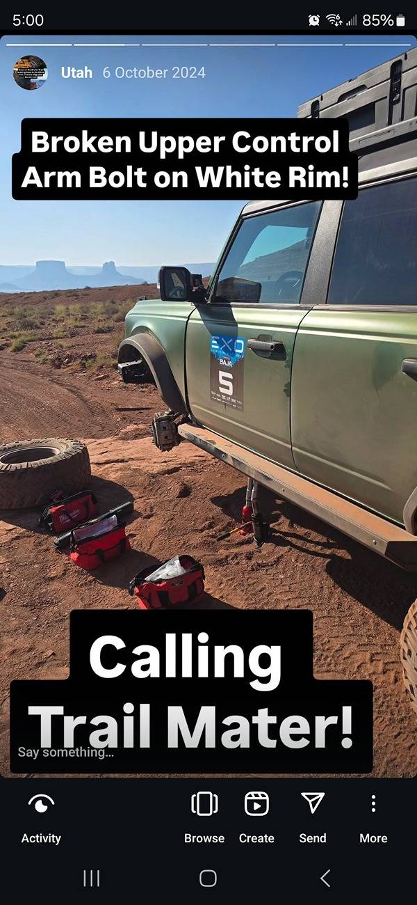

ROFLMAO!! Allegedly, we may have had Rory come out a few months ago and fabricate a new UCA bolt in the field (never leave home without one folks)! I had my career mentor along with us and he has seen a lot in his lifetime. He ranks Rory #1 for the guy you want to have coming to your rescue, albeit, when you have Starlink to ensure that you can brief him on what to bring). Jaw dropping experience and then he drove off and said "call me if you need anything more". So, we drove out solo after dark . . Epic adventure.

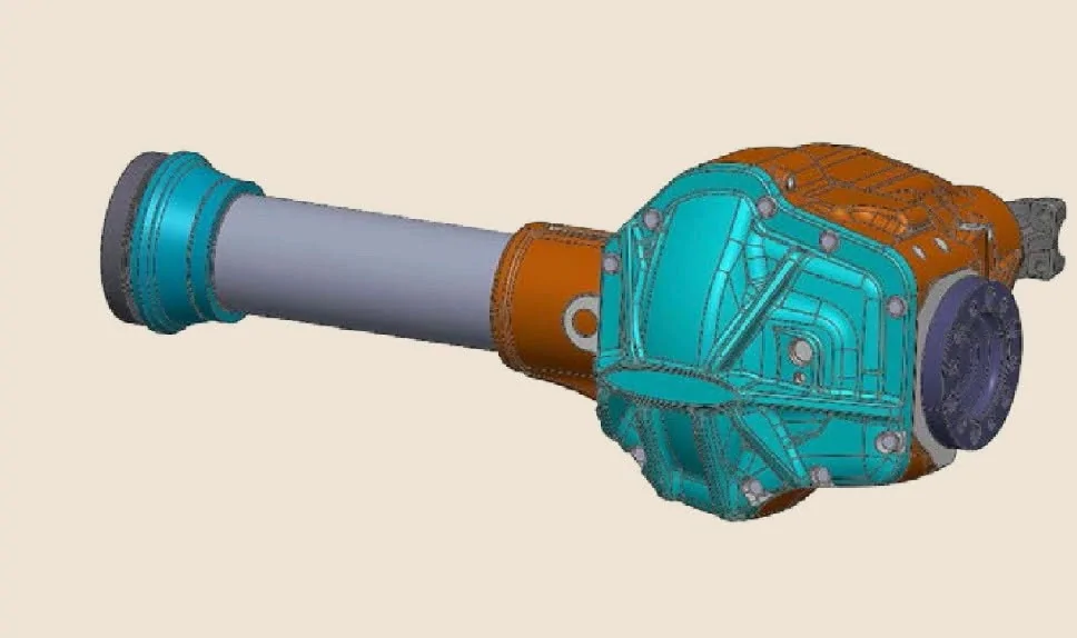

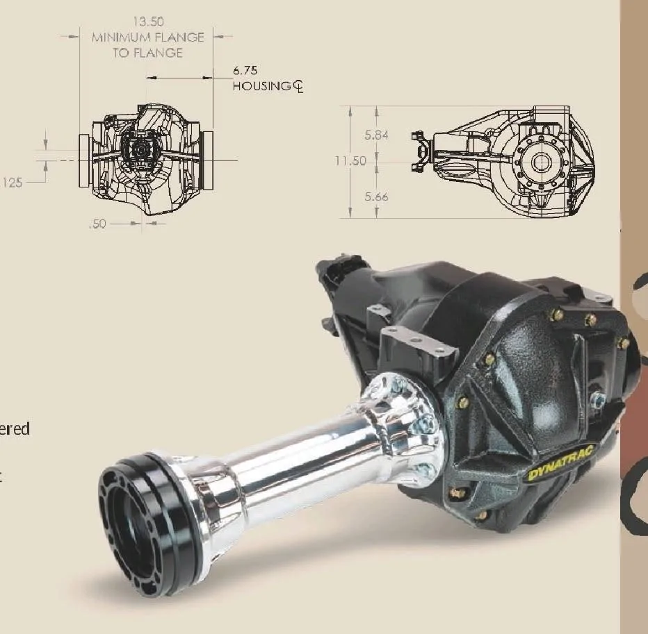

This is exactly why I'm doing double shear on my UCAs on my Braptorized 2dr. Also going to TRY shoe-horn a high pinion Super 60 center section in the front keep it IFS...
This is about the UCA bolt. It is a POS - basic white metal and no high quality after market solution. Ford went cheap and copied Toyota design for Bronco, Braptor and Ranger. Horrible.
Solo Motorsports have a weld solution which I have now done in Bronco and will do on Ranger Raptor. Quinn at 74weld and the guys at Exodus 4x4 strongly recommend for anyone running 37" or larger.
https://solomotorsports.com/shop/parts/ford-parts/suspension/2021-ford-bronco-uca-double-shear-kit/
