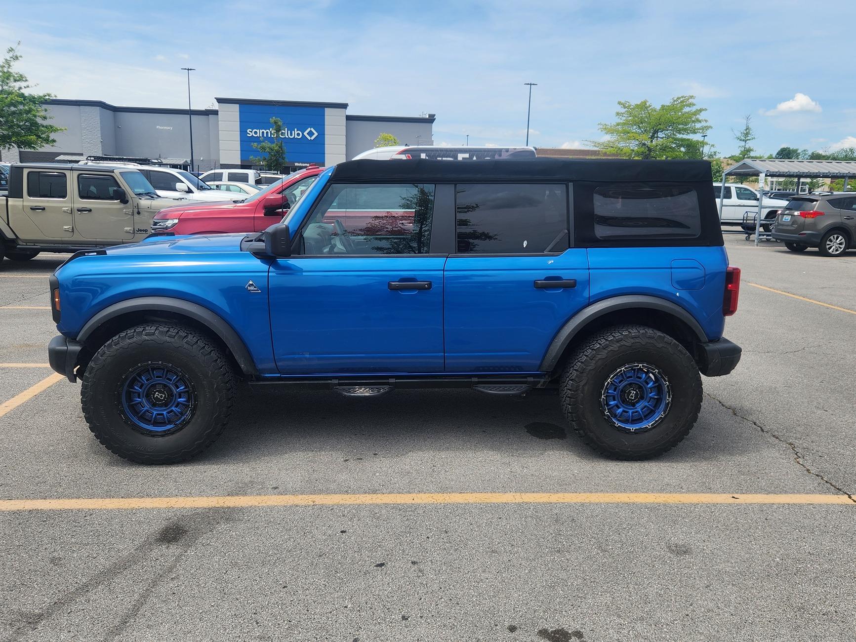

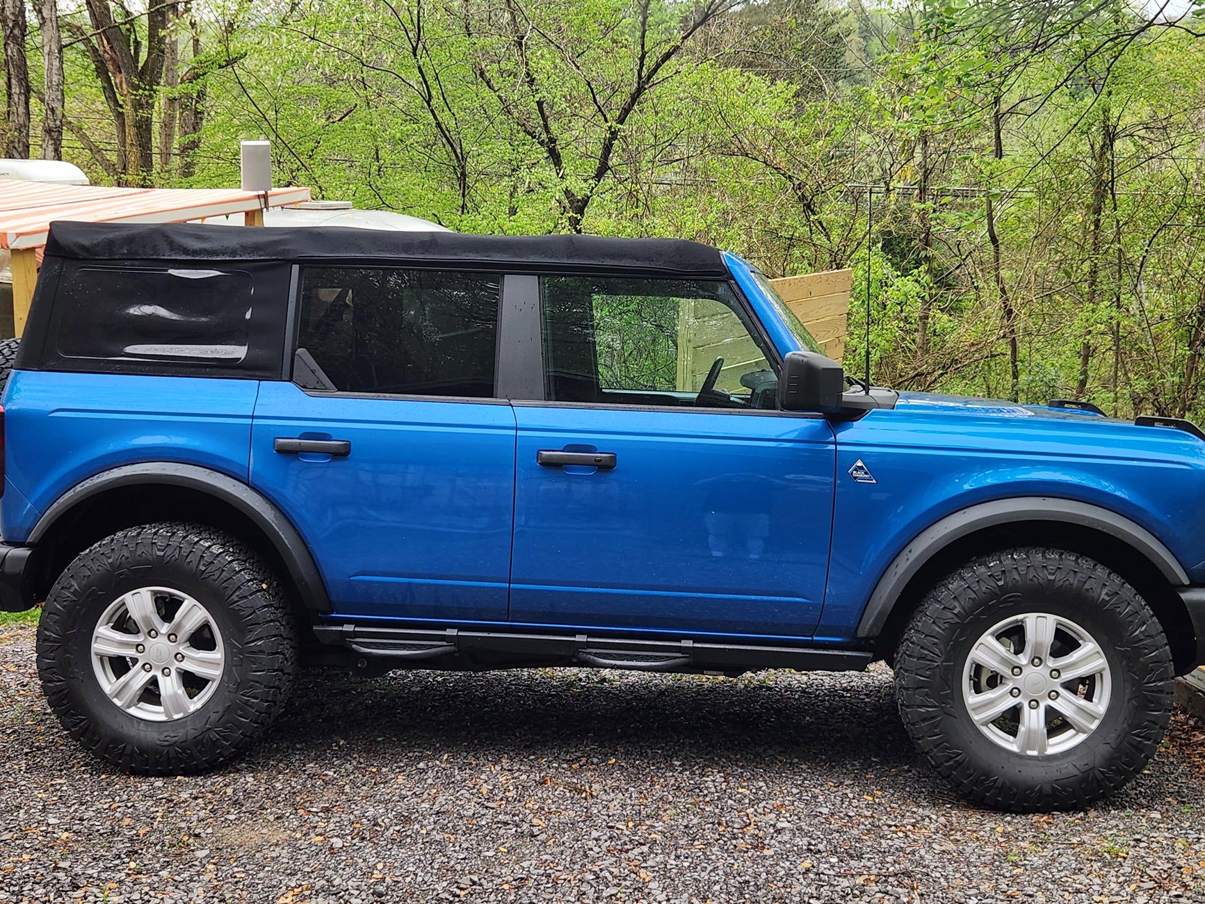

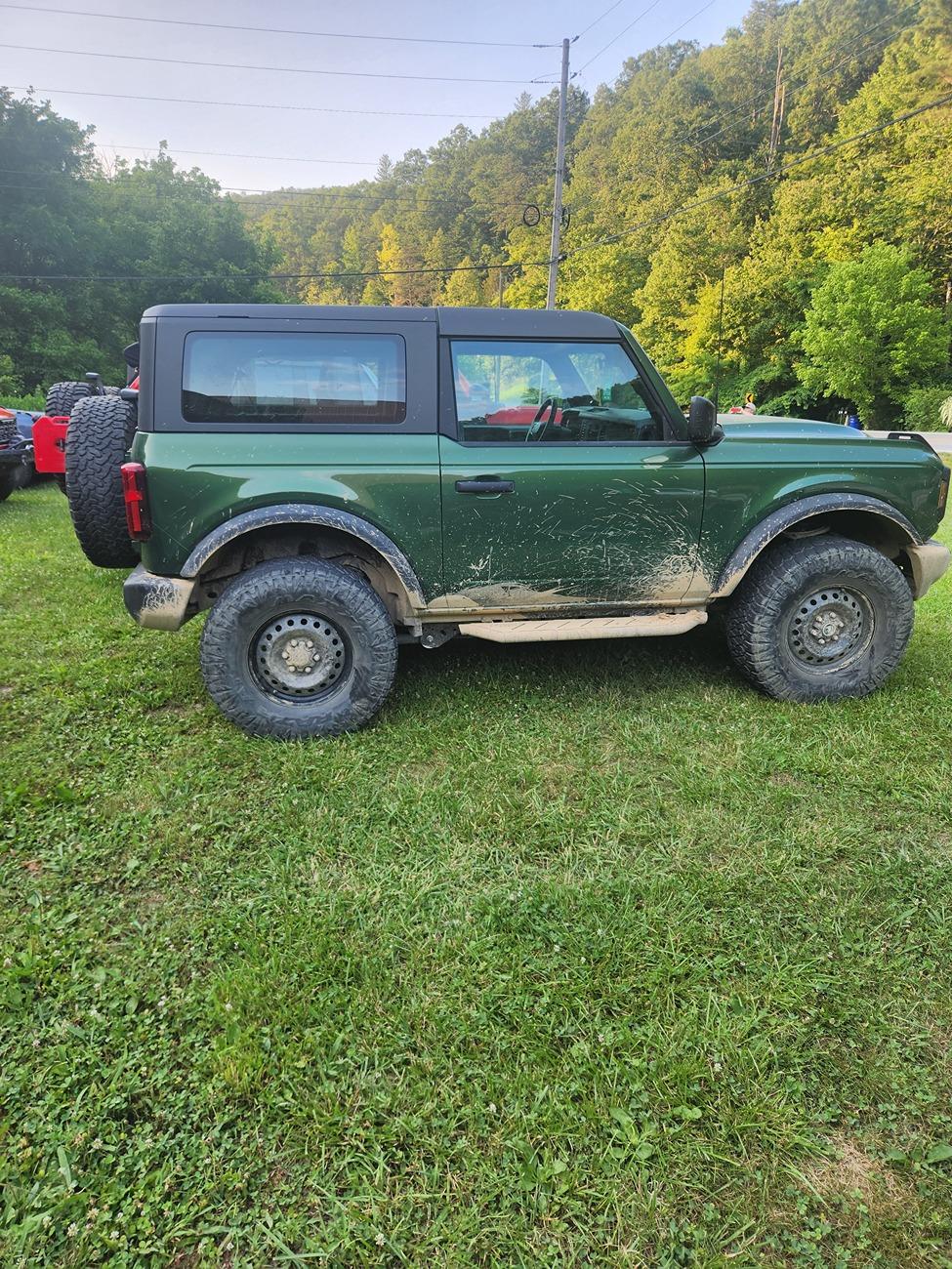

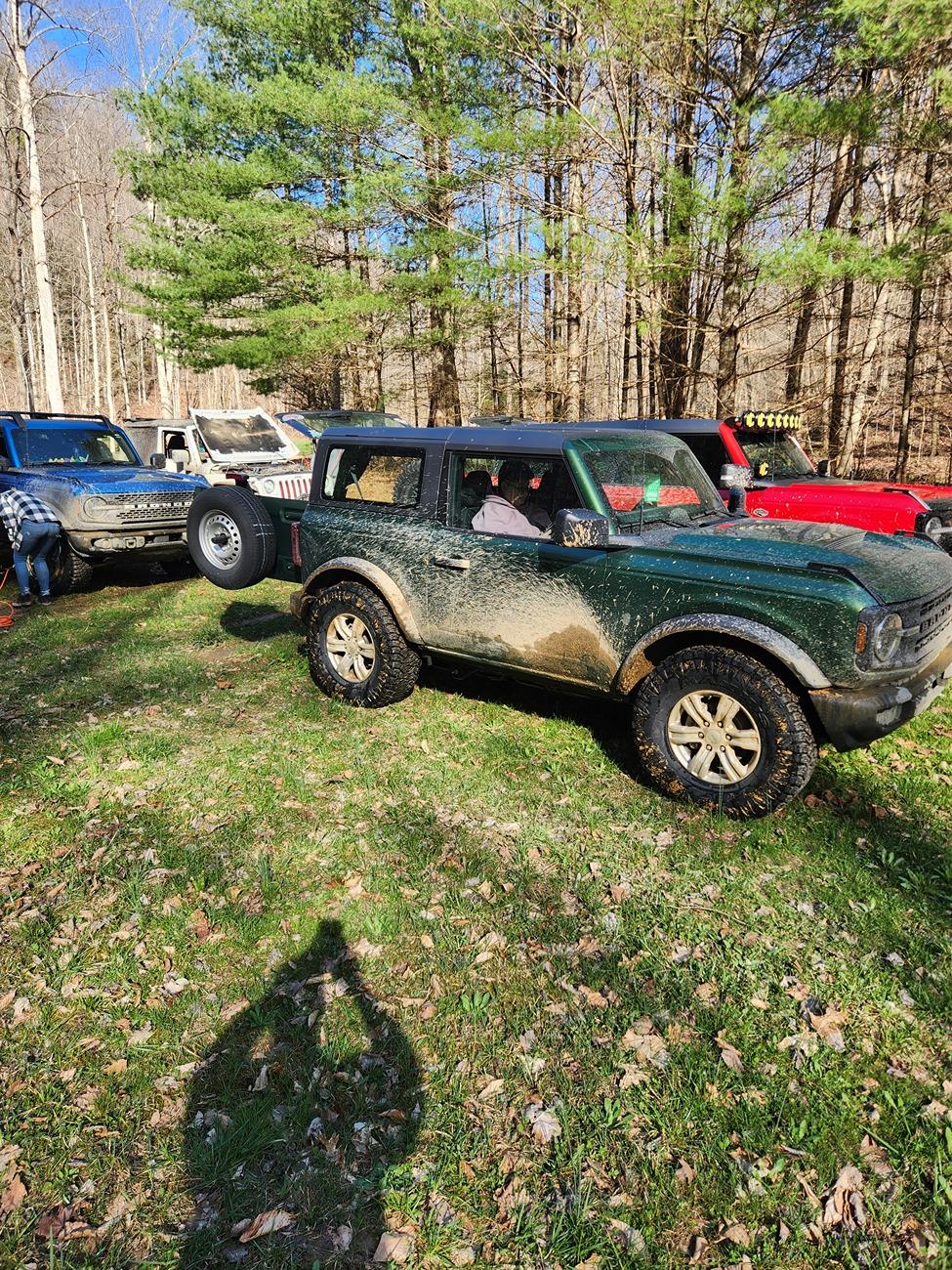

I would do lift and 37 first then maybe gears . I run 35 on my base with a 7 speed i also have a bd with a auto on 35. We run the trails here in ky . 37 would be nice on my 4 door but that my wifes daily . My 2 door base does just fine with a 2 in lift and 35s if your doing it.mainly for looks then just lift it and put on 37. If you are going to wheel it go with a good set of true 35s and have fun. Just dont be that guy with all the gear and no idea. I been off roading for over 30 yr. The blue one you will see on broncbuster trail ride at windrock. The green one you will see on trail hunter usa.
