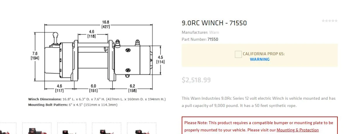

What is the maximum width of the winch (between side plates) with this mount? some of us might want other options the the Mile Marker.
We’ll measure. I don’t have the number in my notes I guess. The mile marker winch is REALLY tight

Are you saying that the 9.0 RC fits on this new hammerbuilt winch mount? Has anybody tried this?
It looks like it’s the only other possible option but the price is so much higher we’re not sure the benefits are there.

I posted the MM dimensions earlier. Just for reference here are the Warn numbers.
That width dimension looks exactly the same... The price certainly does not.

For what it's worth, and if it helps anyone. There are people who have cut down and M8 to the RC 9.0 specs. Only real difficult part I believe seems to be cutting off the flange on the drum and rewelding it in place.
This is what I was originally going to do on mine when I decided to modify it to use a full width winch. Just to Future proof it a little bit.
This is what I did with mine. The old pirate4x4 method.
For real! It is pretty crazy that the RC 9.0 as far as I know is basically identical to an M8000 with the exception of the width. I believe they use the same control pack and everything.
