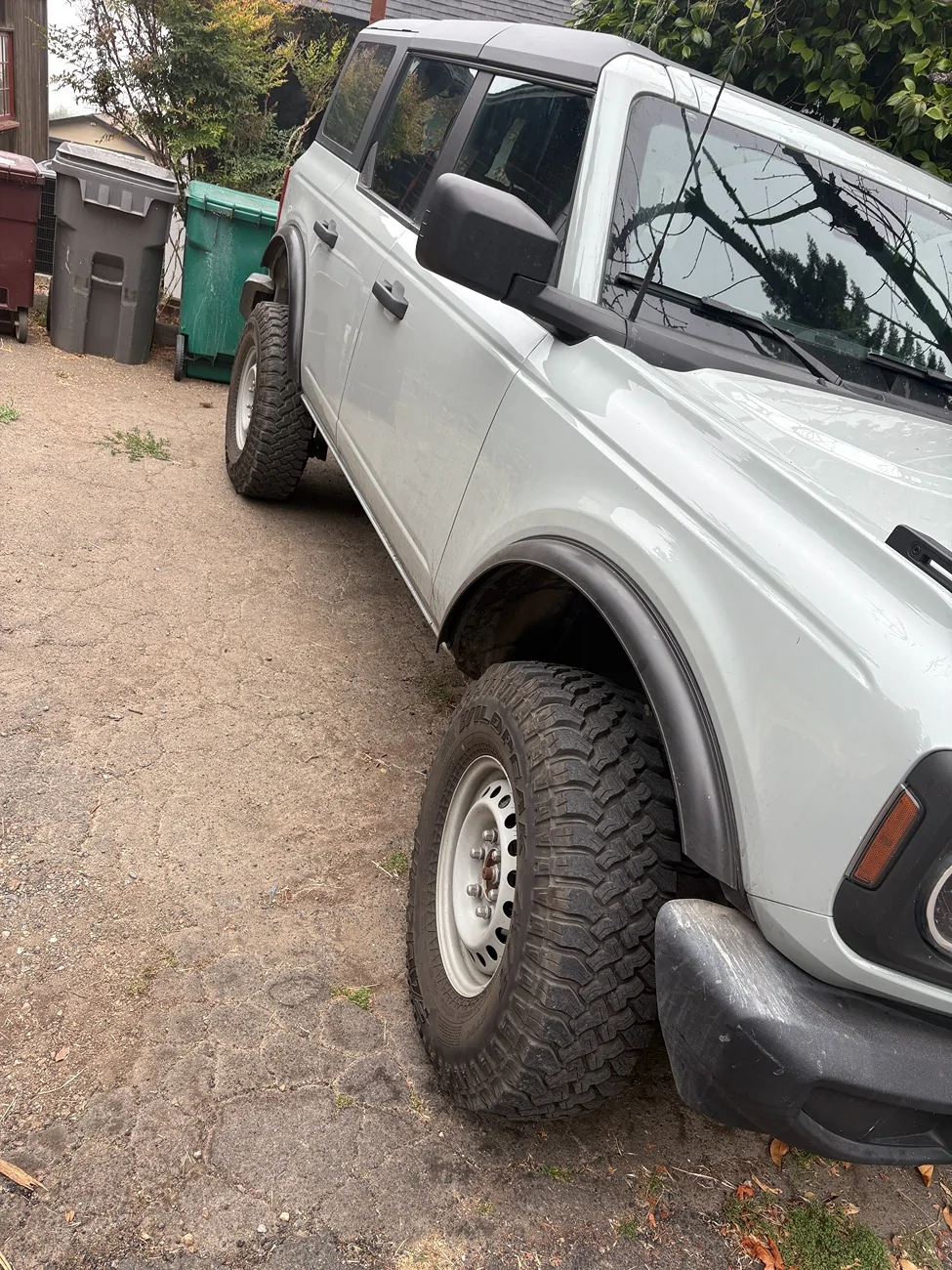

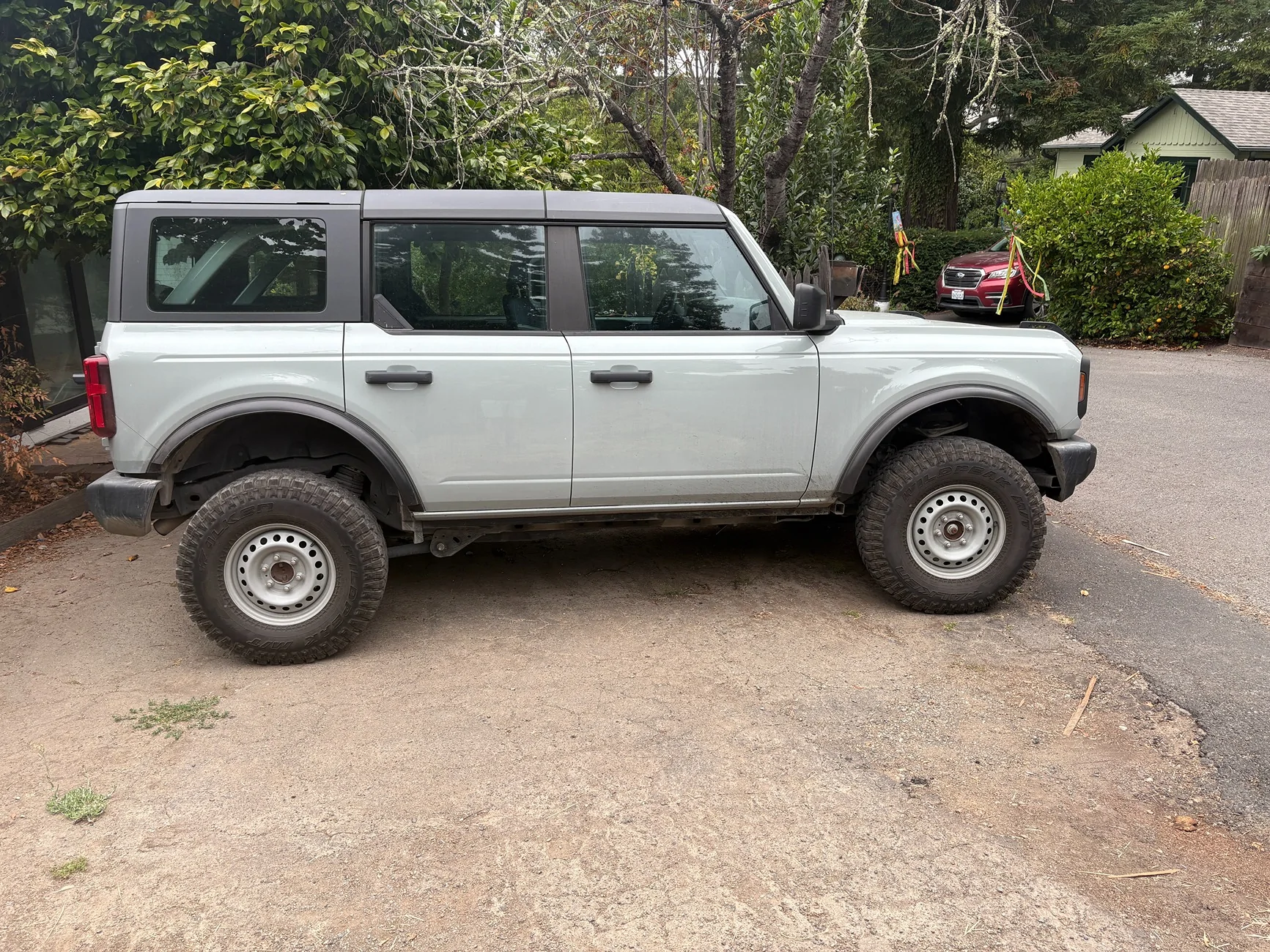

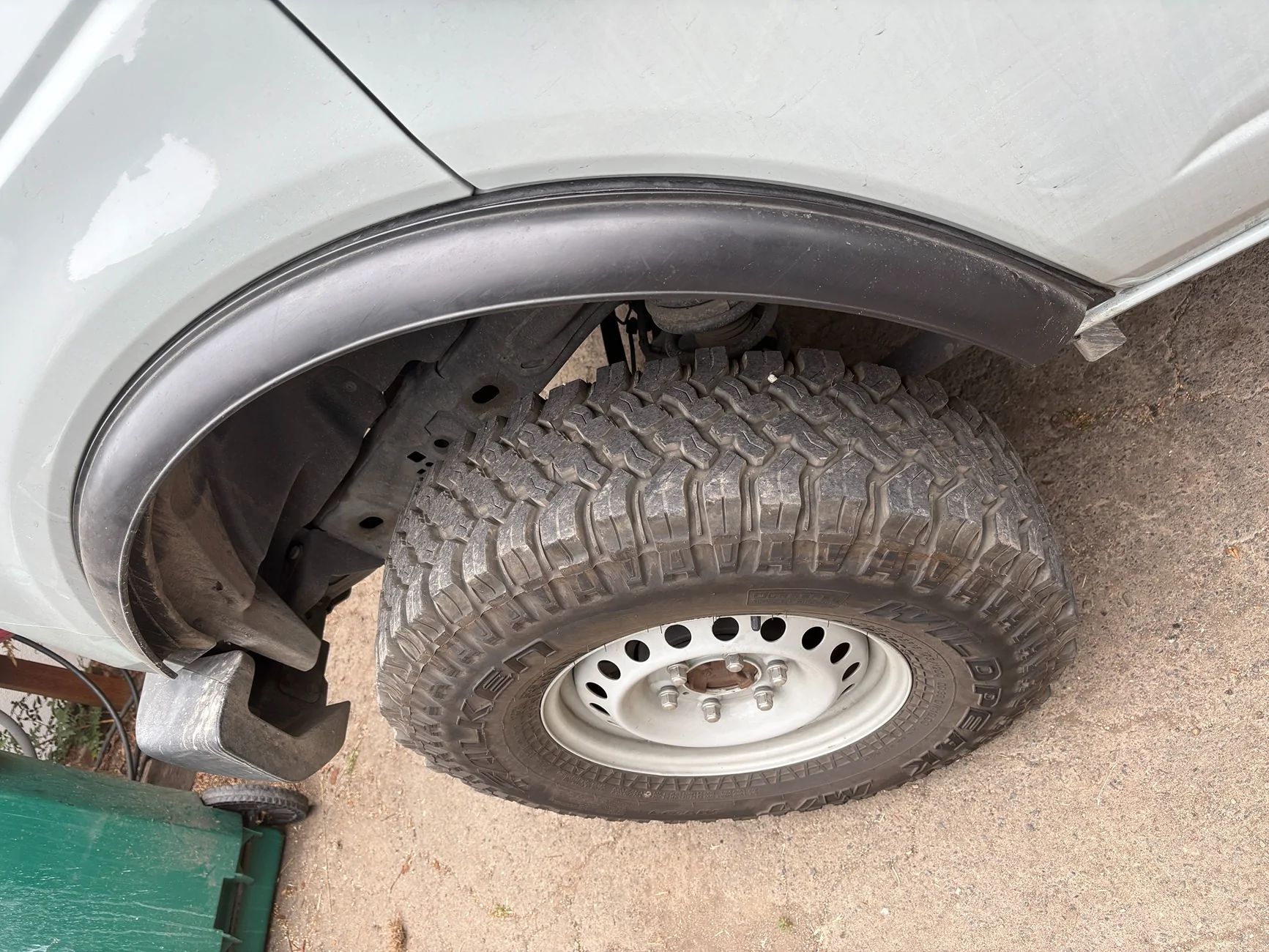

Do these two products work together? Or are they independent of each other?
its 2 separate products, from 2 different companies.
I included the links
my photos show them working together
you install the flare delete, then install the rubber flares on-top.
you need to use special tape with primer, and its good to add some screws at critical points.

So do you remove the Flexy flares when wheeling? Or leave them on? Is the purpose of the RPM fender delete to have a more polished look beneath the flexy? How is the tape used that you mention?
Bruno
Bruno
Apr 24, 2021
56
1,090
1,183
Sierras

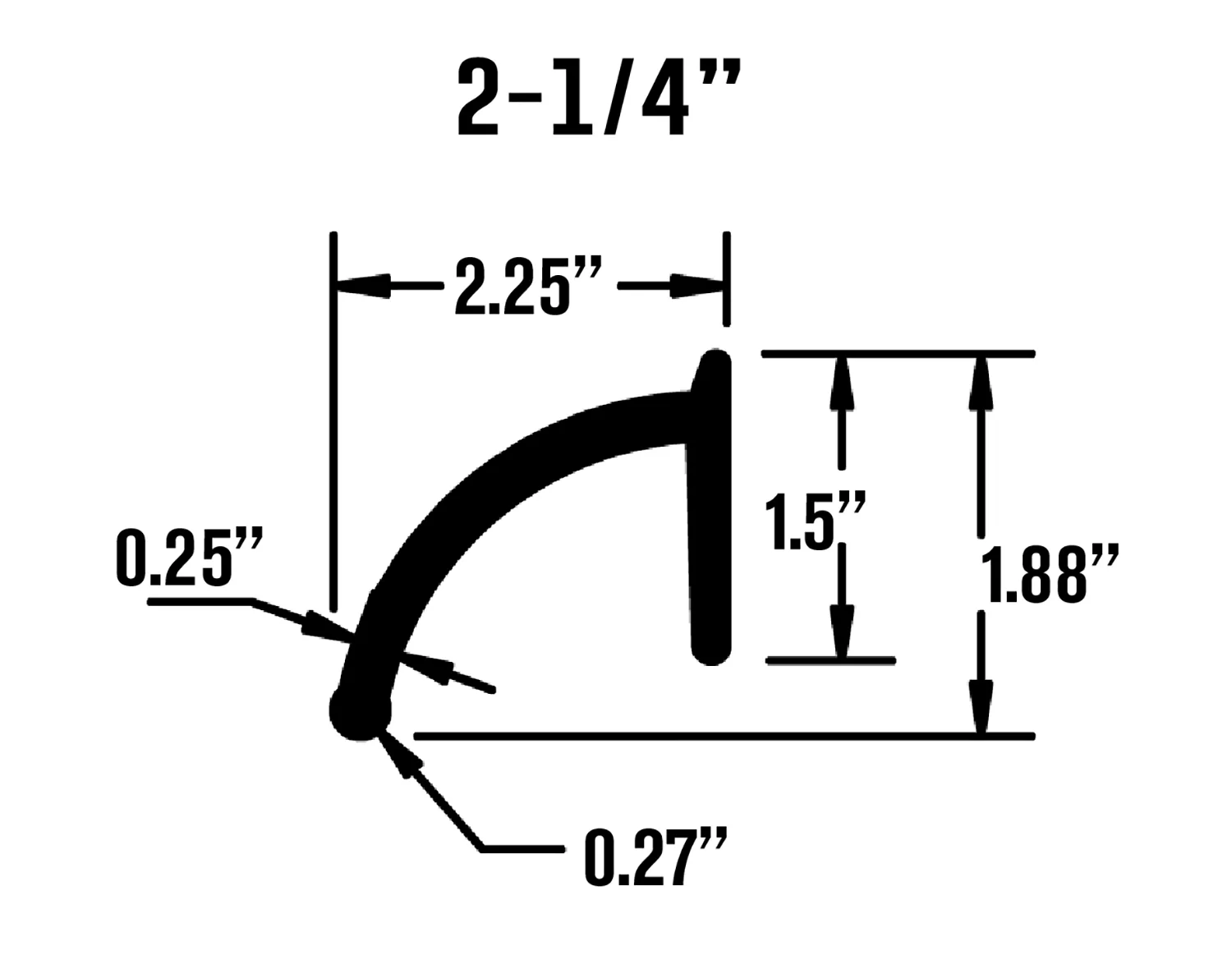

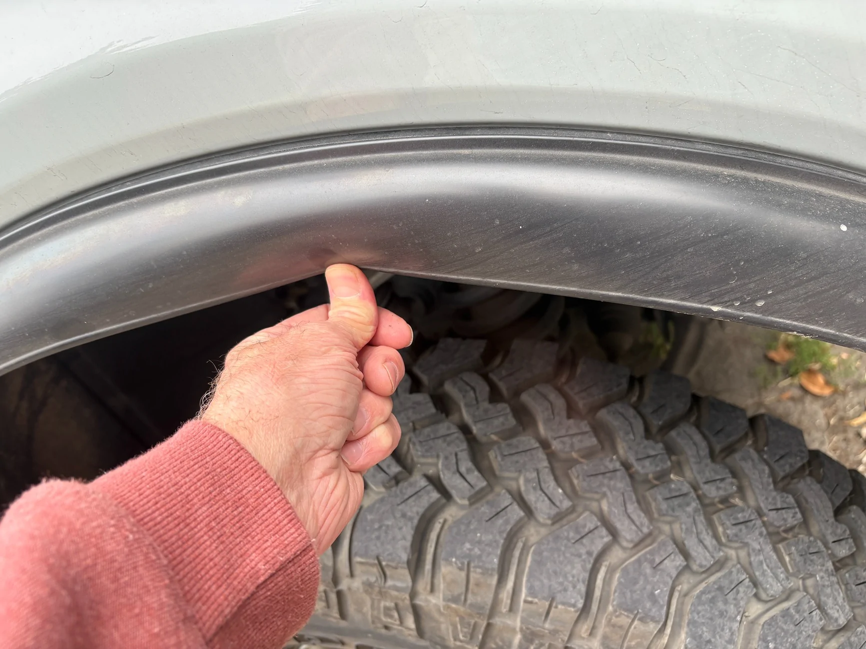

I don't take off the flexi flares ever, they are ultra compact and permanently attached to the flare deletes.
My only "wheeling" is on fire roads and yes it can get narrow that's why my bronco is focused on being narrow.
the tape is just attaching the flexi flare to the flare delete - and also a few screws.
pretty common stuff
the purpose of the flare delete is to give something for the flexi flare to attach to.
if you take off your flare you can see its a lumpy area filled with holes, you cant attach a rubber extrusion to that
