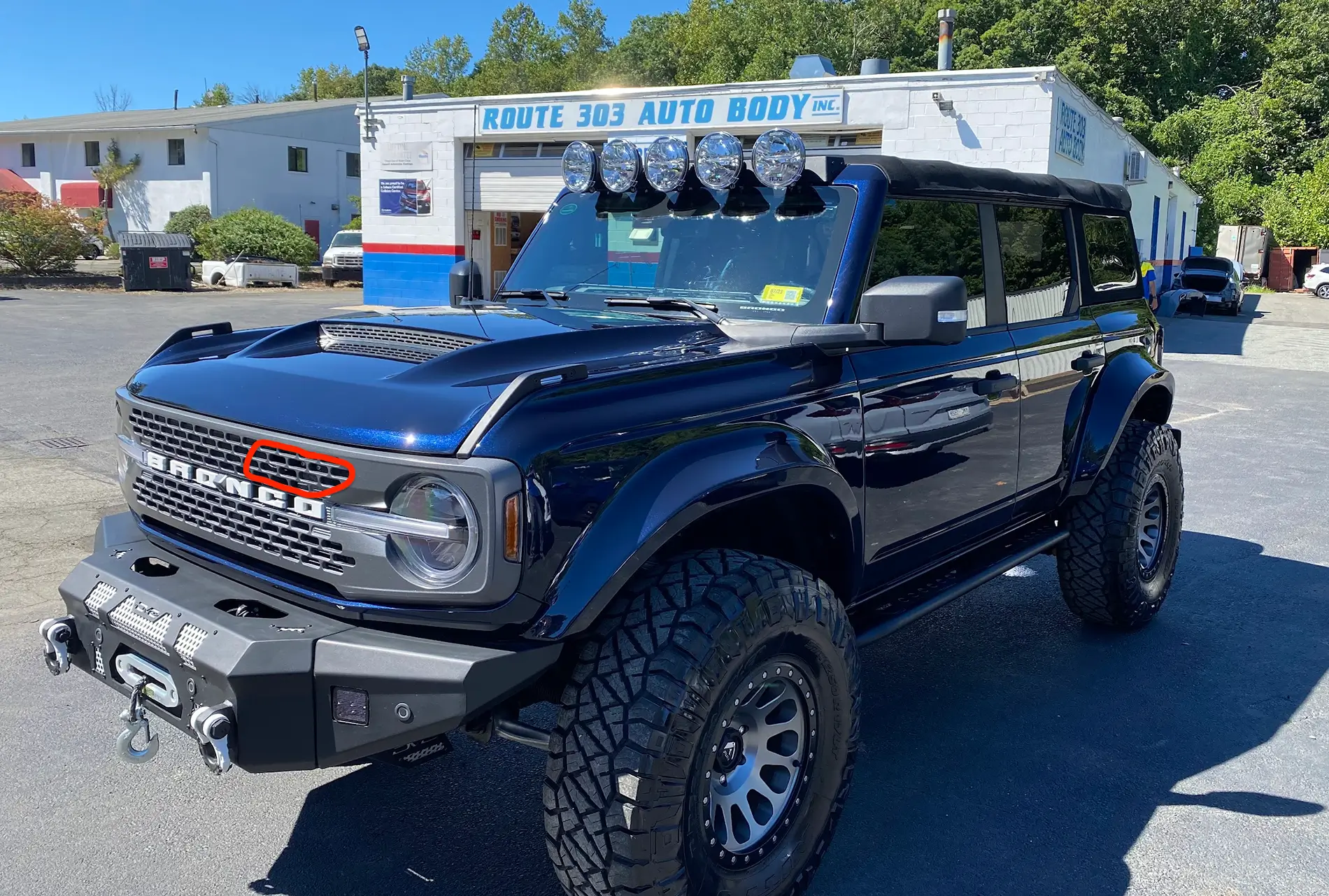

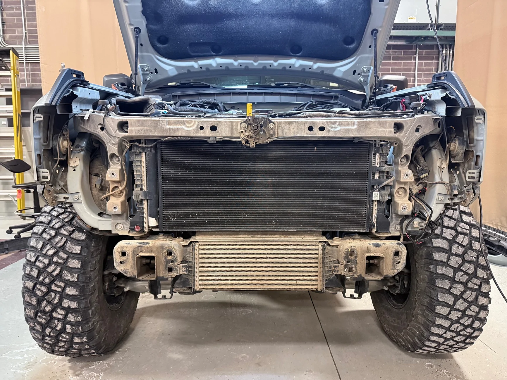

questions - I have a '21 Badlands. I currently have a DV8 bumper on it and have relocated the ACC sensor using the DV8 relo bracket. I would love to go back to the original bumper (which I will have to source) and install your solution.
Given that I have relocated the ACC sensor already, could I do your solution without having to change the intercooler?
the ACC bracket lives in the area I circled in the pic below

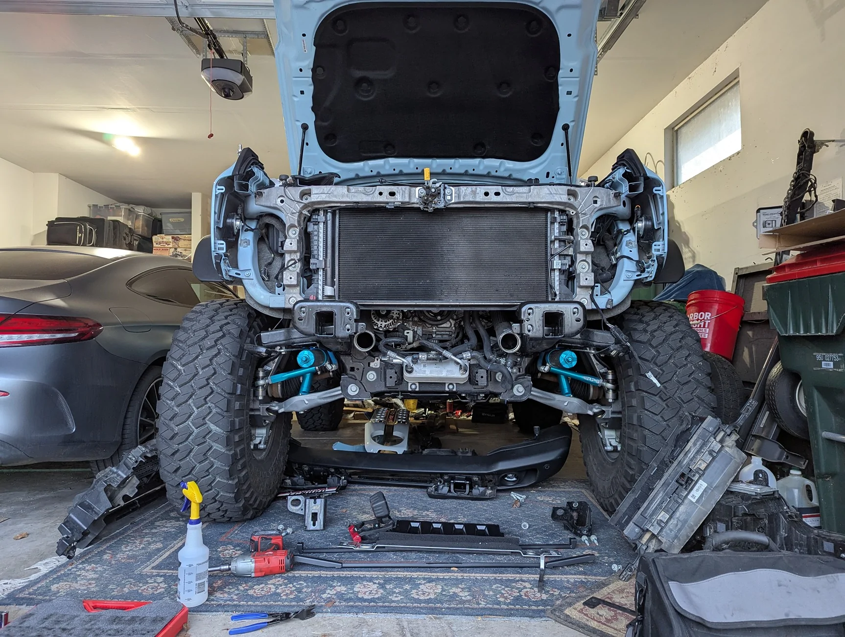

Any of us with ACC have to relocate that, you would not. BUT you still have to move the intercooler.... The winch mounts right where the intercooler is currently.

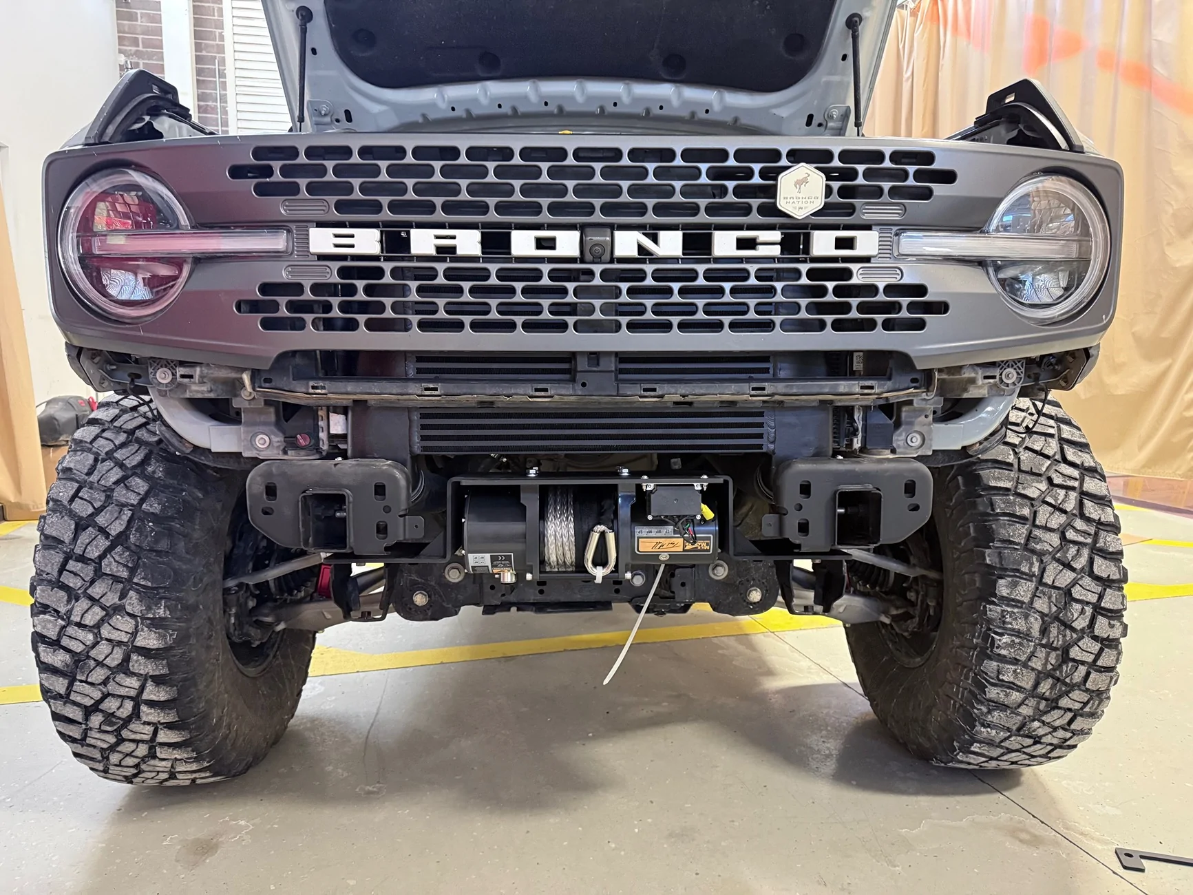

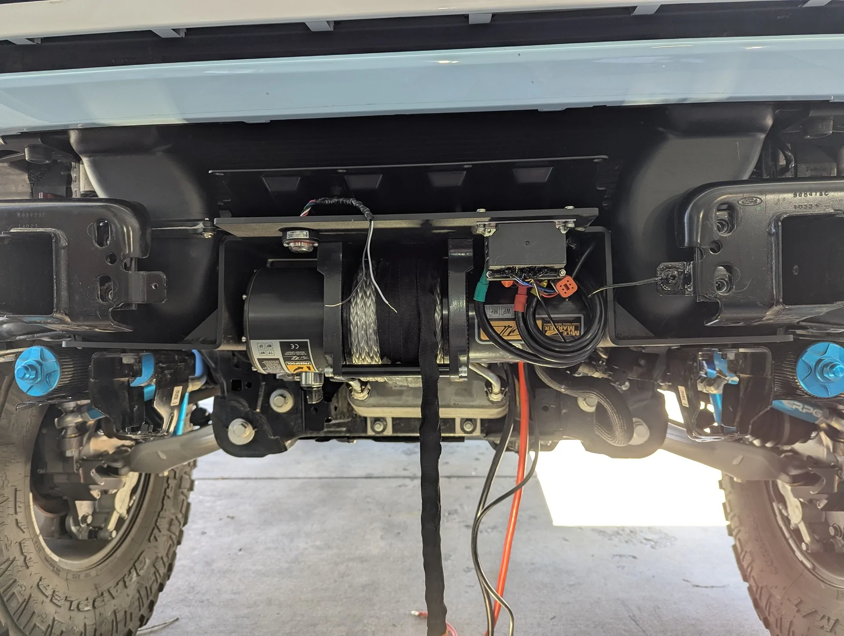

The stock intercooler is right in the way of where the winch mounts. It needs to mount up out of the way. The Mishimoto intercooler also has brackets for the ACC relocation. The Wagner Tuning I am running does not.

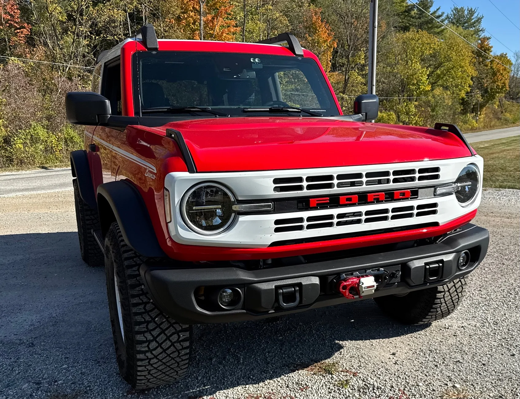

I seen earlier where someone asked if this would work with the Raptor and the reply was that mods for the intercooler were being looked into. If there was an update I must have missed it. Any progress on this? I am waiting on a raptor now and hope so.
For some eye candy, here is my 24 with this unit.

Like 5GENIDN, I too have the Mishimoto high mount (although with the 2.3) and have noticed nothing out of the ordinary with the temp.

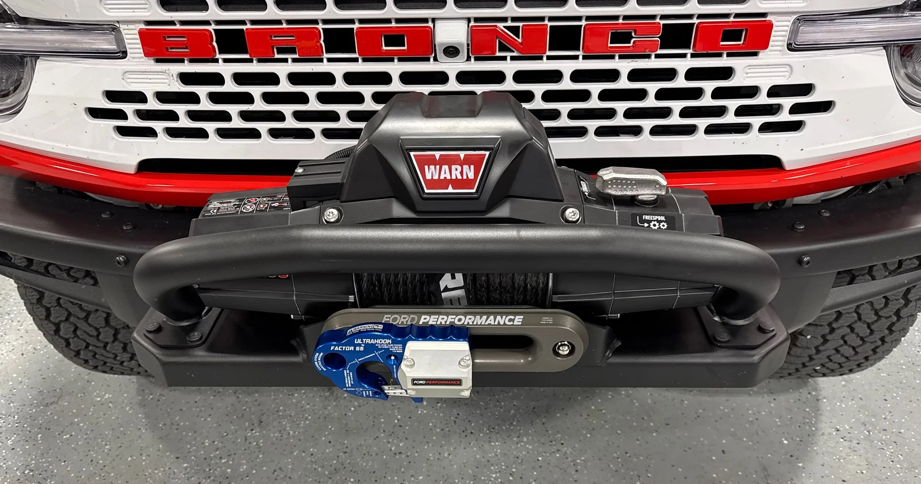

The bumper may be a great idea to help counter the slight drop with the front end that I noticed with mine. I do not know what the stock bumper weighs so not sure.
I can say that the drop is not near as much as the ford winch kit. (understandably) The tires actually rub when turning in reverse with it. I have another Hammer built hidden winch kit to replace it. I prefer the hidden/clean look as well.

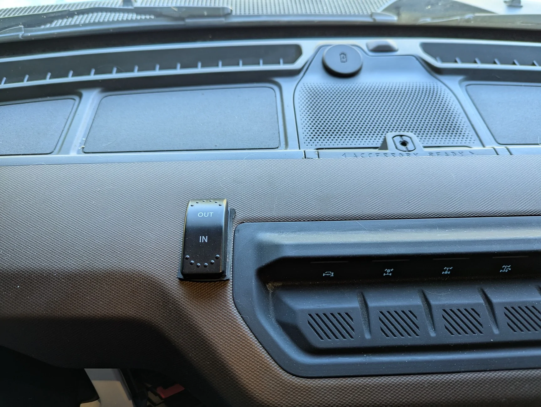

What I like about the short drum is that I am quickly on the first layer..... That is where you get the full rated pull. Anything in the second or third layer has dramatically less pulling power. I believe there are a couple of others that might fit... I think there is about 17.5 inches in width available...
I am not sure what you mean about "wireless free spool"? As in your free spool lever is electric? My "manual" free spool lever is easy to reach. And I always have the in and out spooling on a switch in my cabin (I mounted it on the dash).... I carry the wired controller but do not really need it if I am in the cab.
