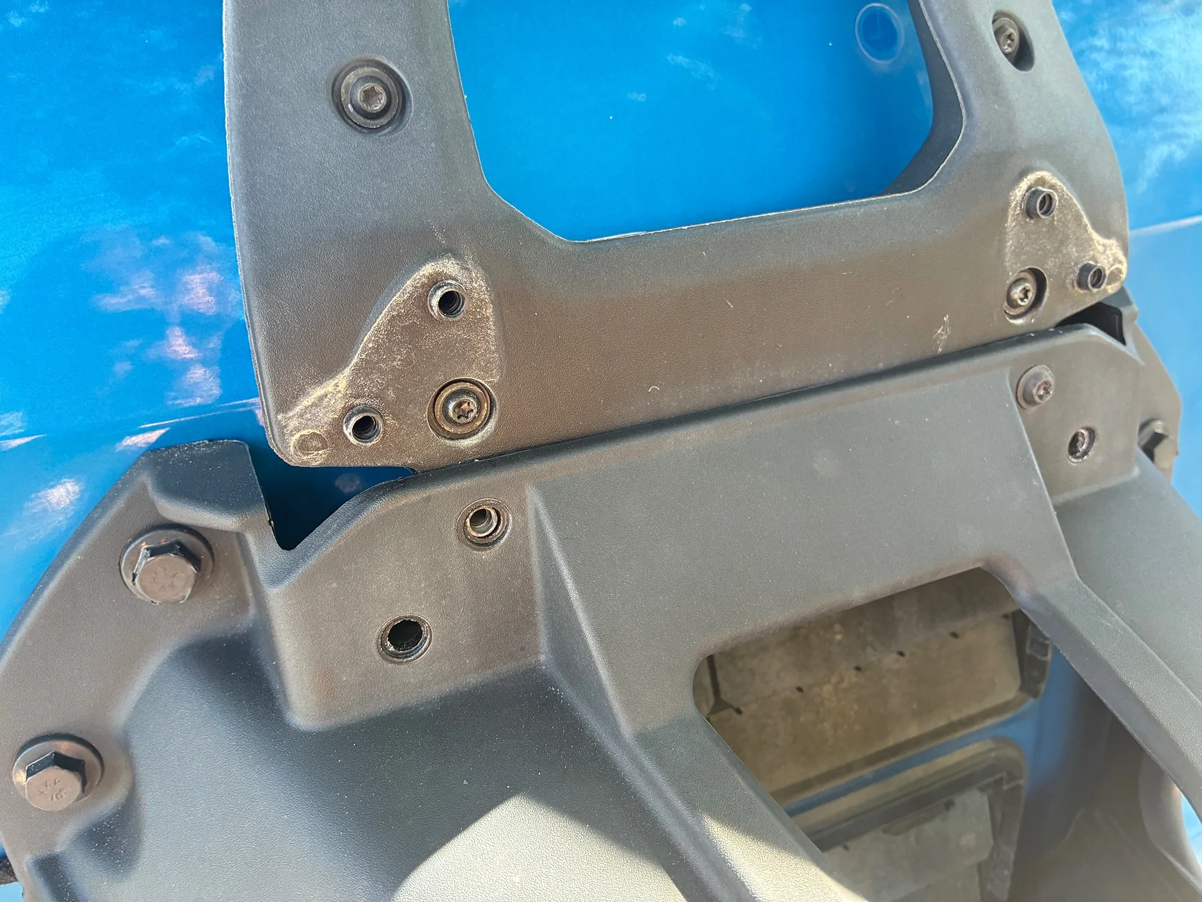

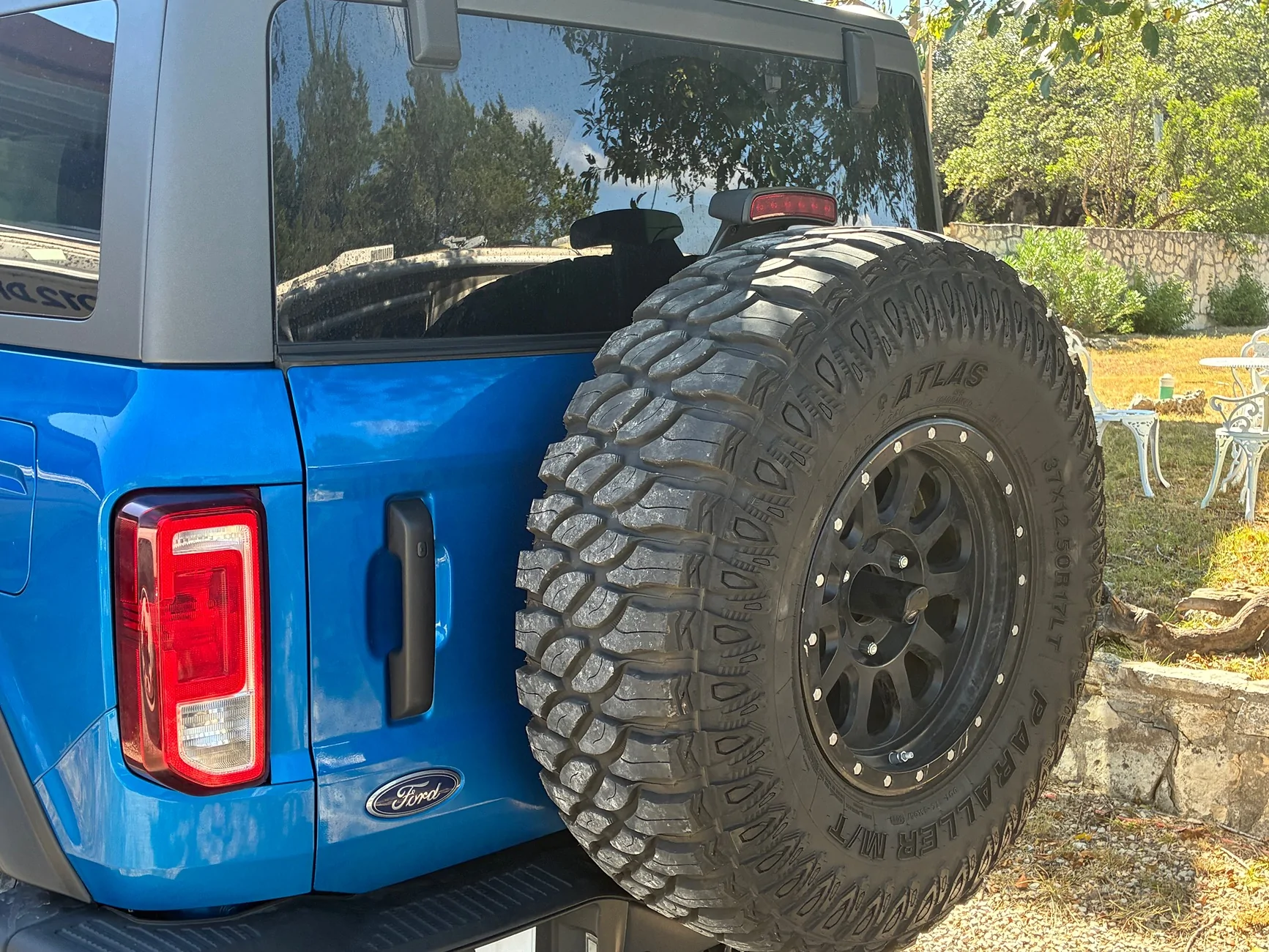

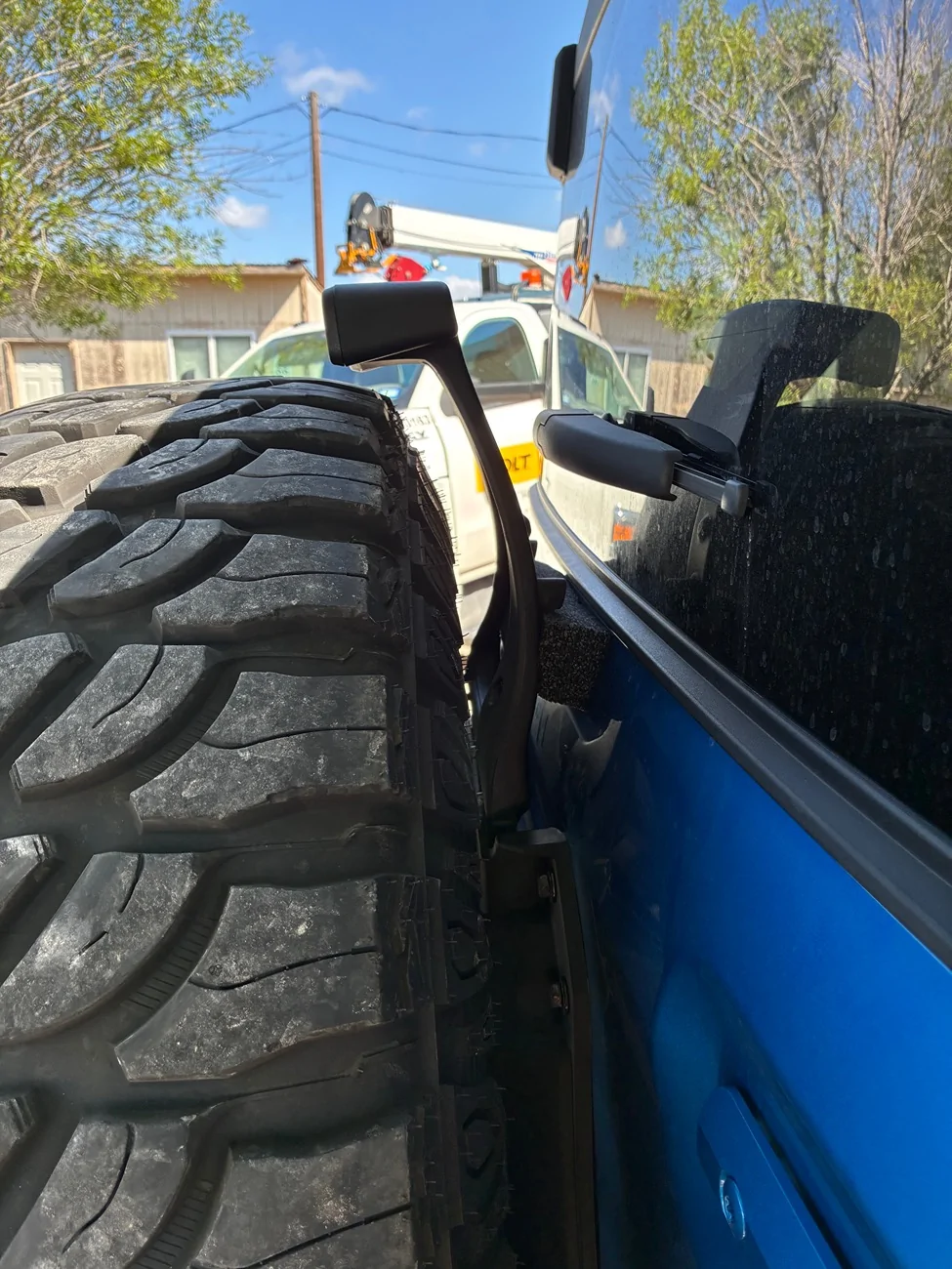

Didn’t know where else to put this. When I put 35’s in my non- Sasquatch Bronco, the third brake light flexed back a bit and barely peeked over the new 35” tire which I was good with. I have since gone to 37’s and the spare was completely hiding the third brake light, so I did this as a “temporary” (read cheap red neck permanent) solution. The stock bracket has 2 extra screw holes (picture shows one screw in and other not yet) that can be used to secure the bracket roughly 1.5” higher than stock. Being only 2 screws holding it now, it does vibrate, so I cut a peice of foam and jammed it in behind it. The wires are just long enough, but you may have to cut the zip tie. I didn’t.

I'm all for these DIY fixes.
Be careful though, that piece of foam will eventually eat the paint as it gets dirt behind it. May not matter since it's hidden behind the spare.

I actually thought about that because the little rubber bumpers were starting to rub dirt through the paint. May do something different IDK.
