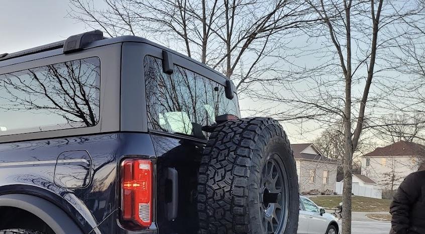

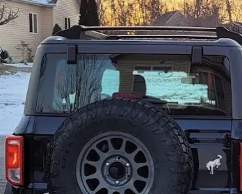

Best shots I currently have of my 35 x 11.5 spare on a 17x8.5 +35mm offset wheel.
The light is resting on the tire. I'd imagine it is blocking the view for the folks down low, up close, in cars.

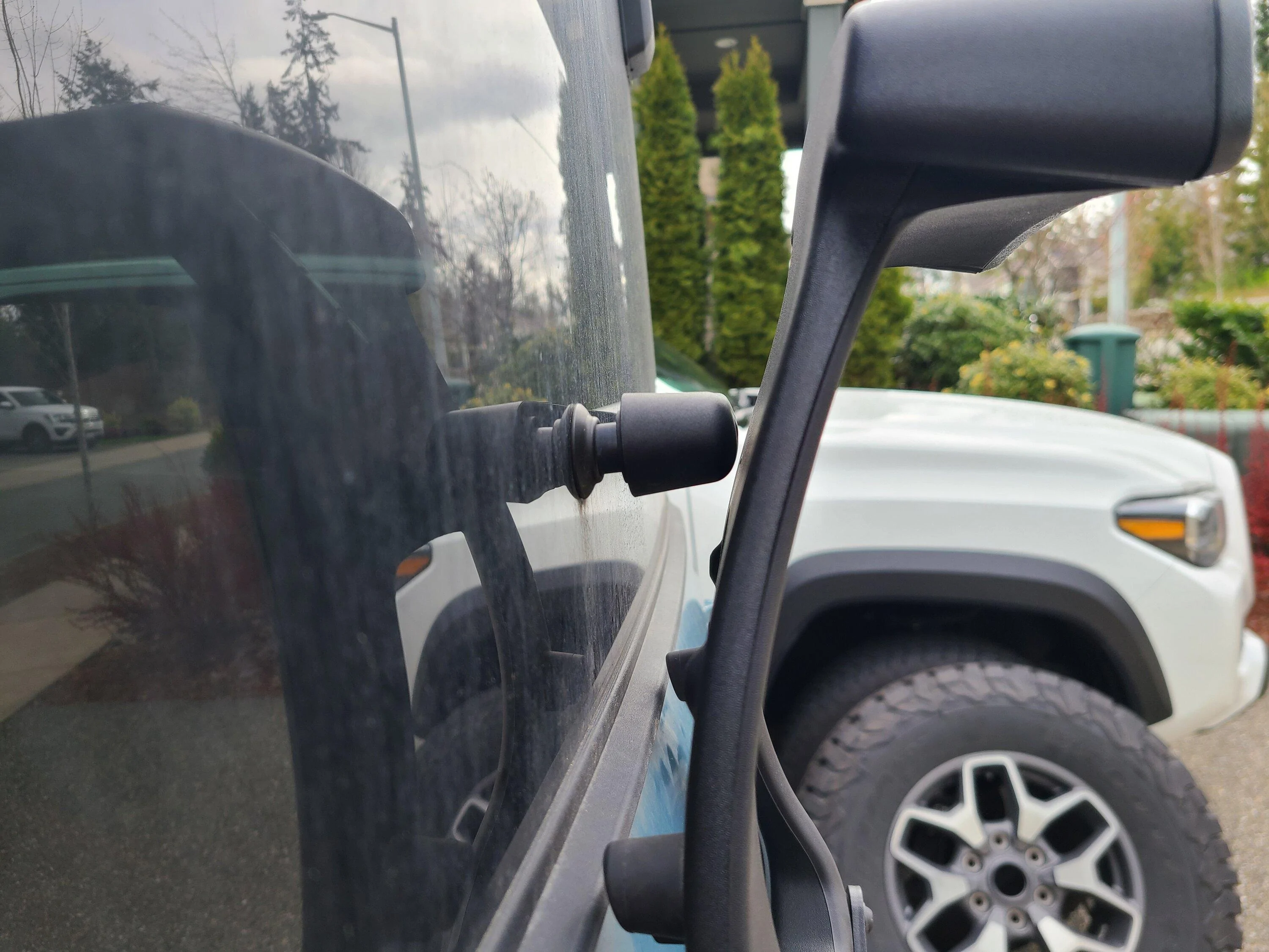

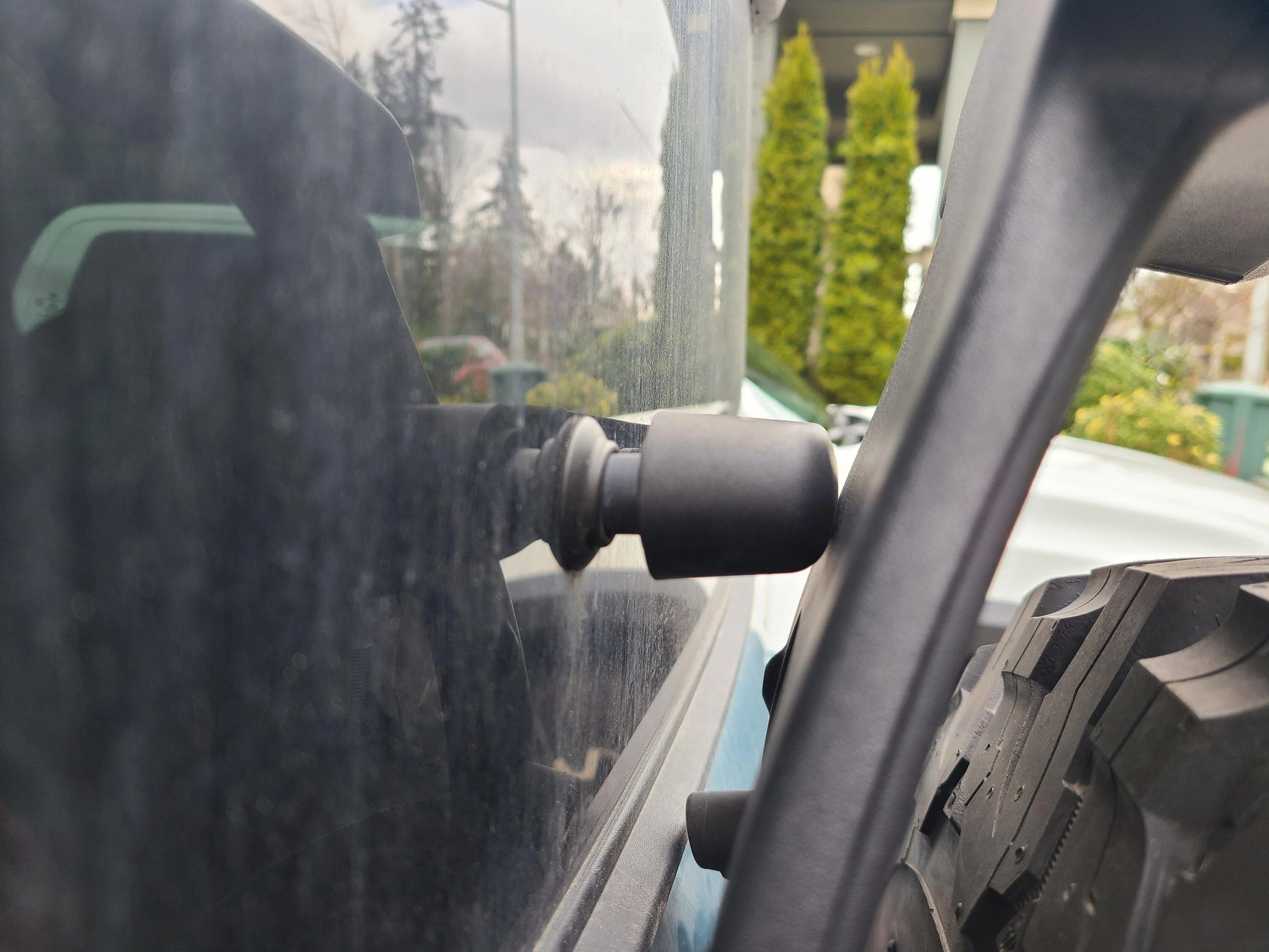

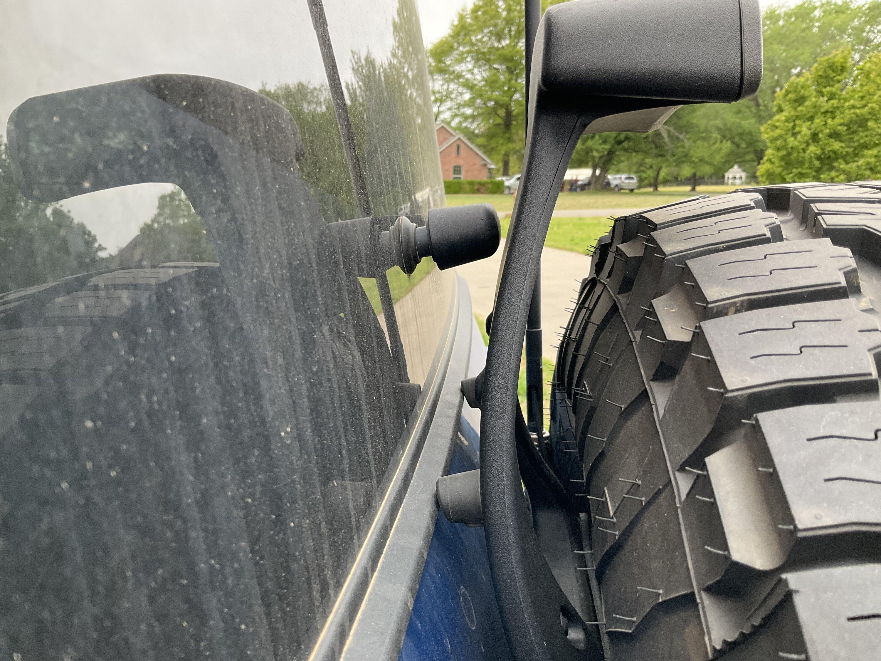

I installed the RC extender. The brake light post is now resting on the rear wiper. Does anyone have this problem? Or just ignoring since no one actually uses a rear wiper?
No, mine doesn’t contact the wiper.

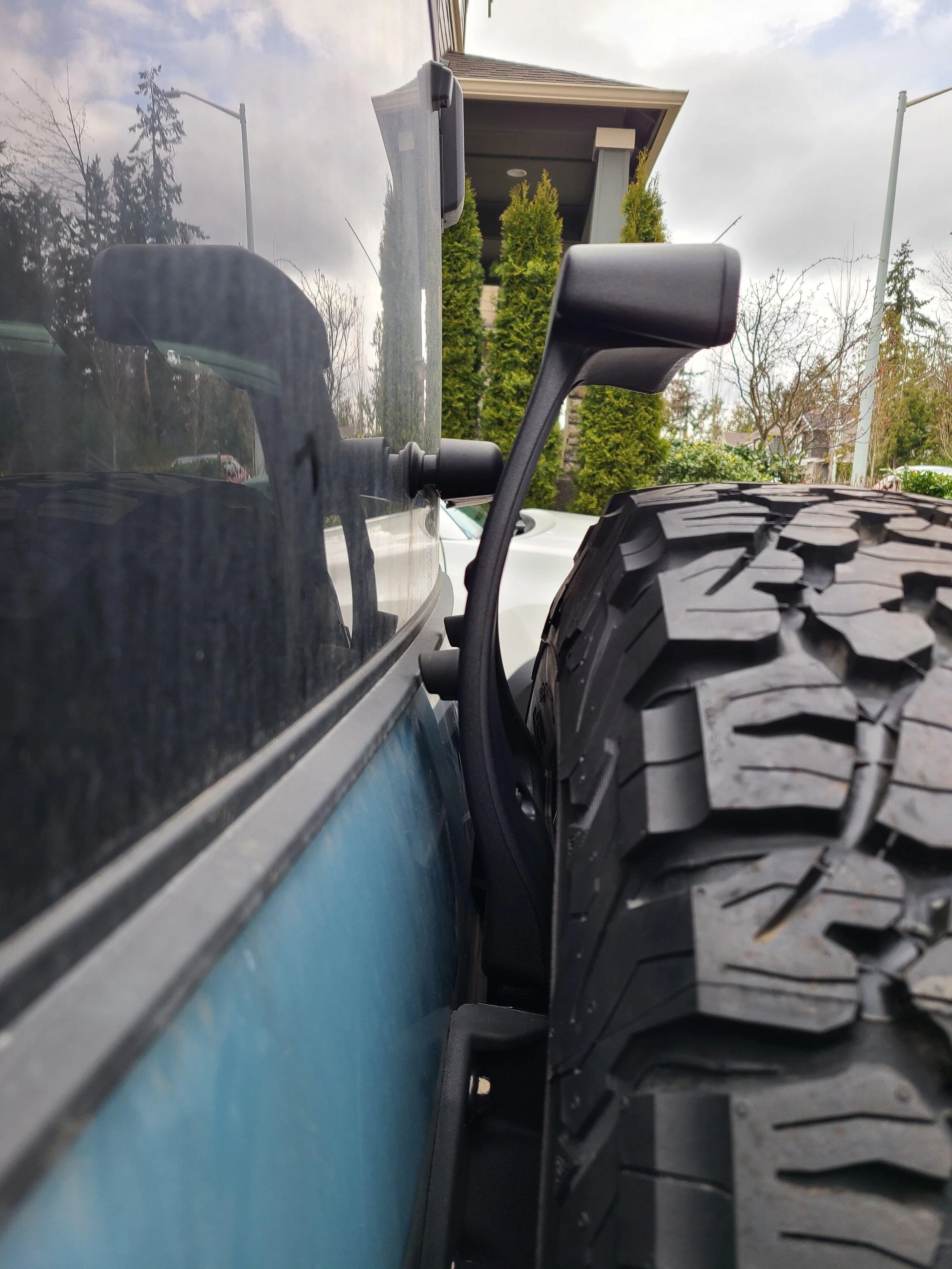

Interesting. Could be that the entire spare tire carrier is adjustable and just needs to go down a hair. Including some photos for reference.

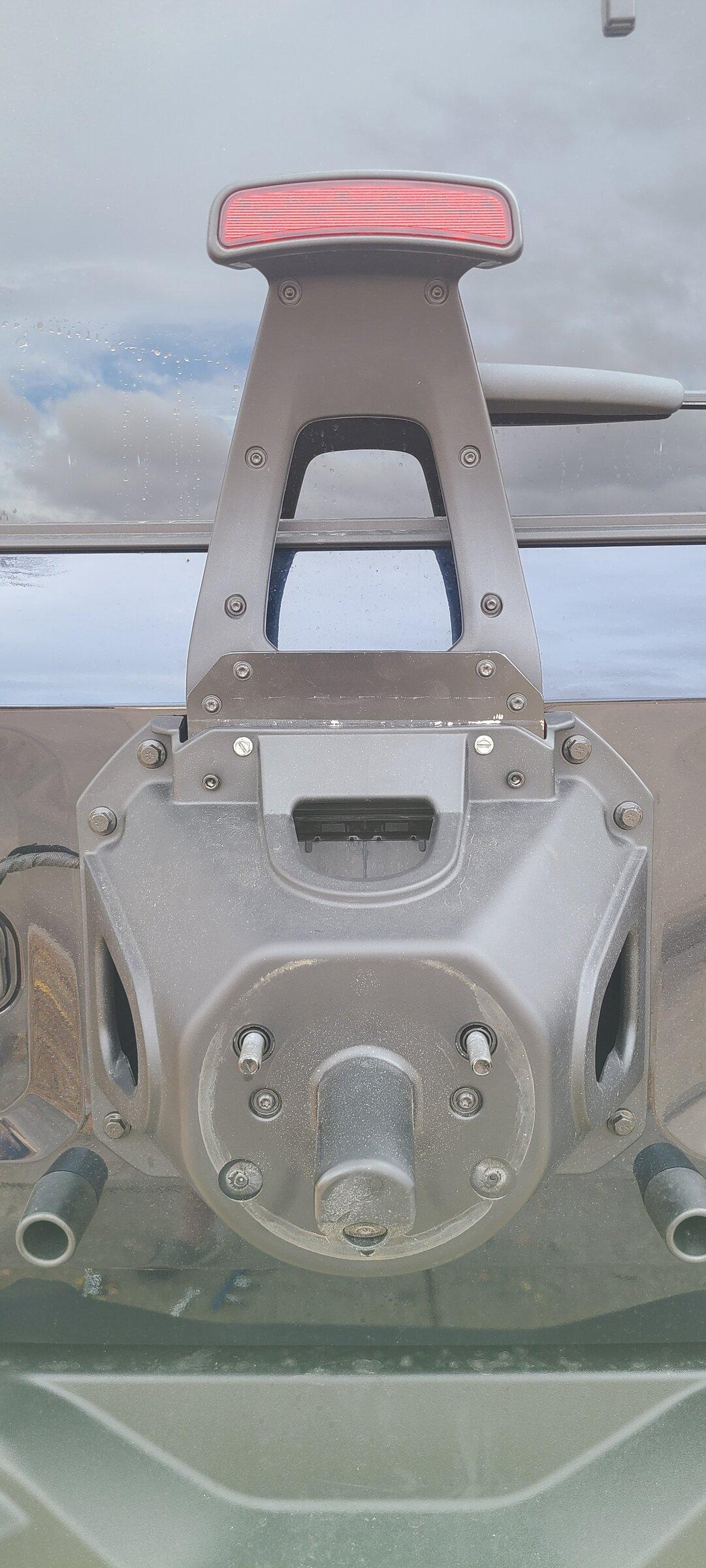

Not sure if there is any adjustment. Maybe loosen the screws and retighten pulling it out from the top?

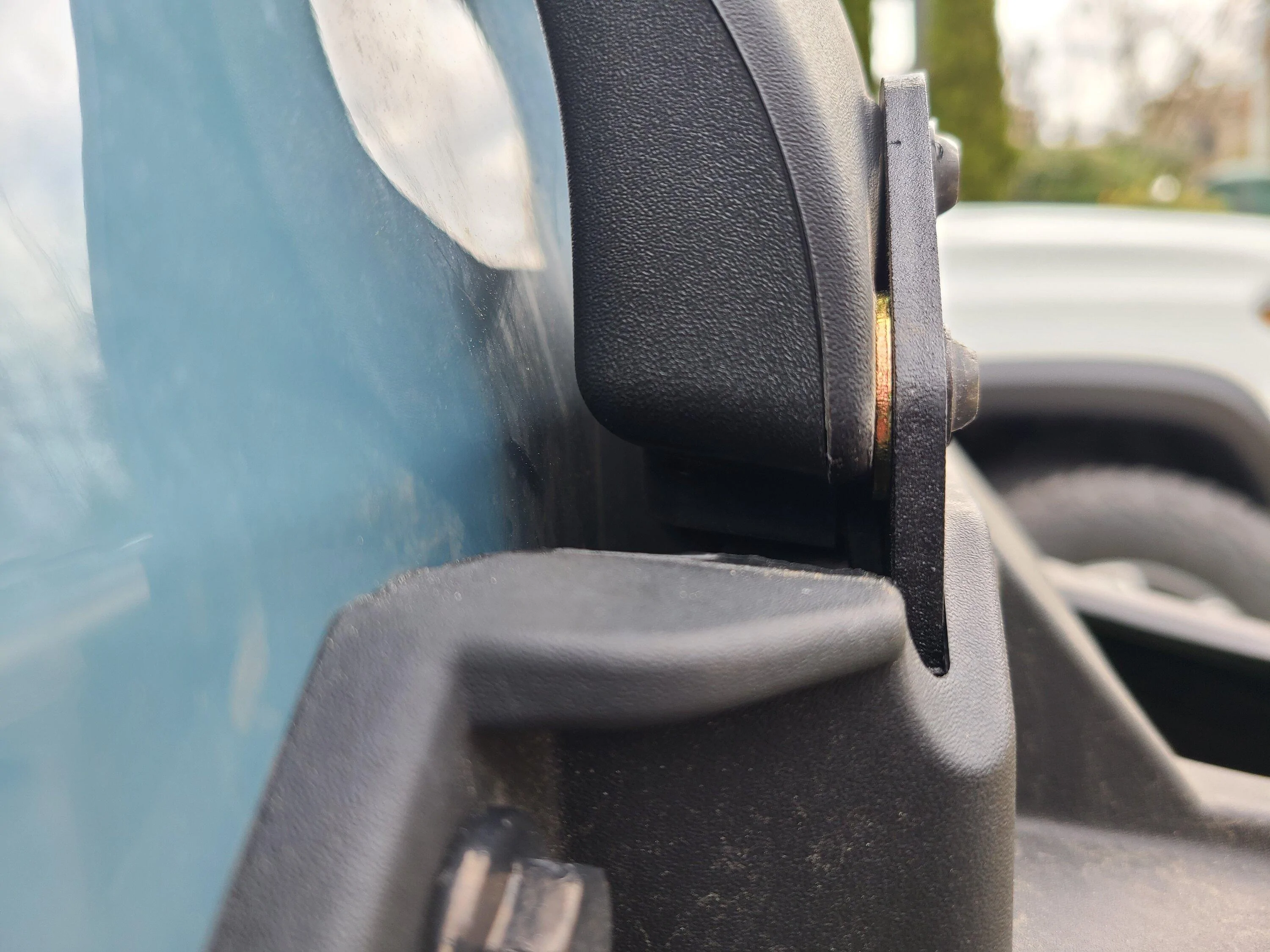

Just added washers under the lower screws to push the top out. See daylight now! Should be OK.
