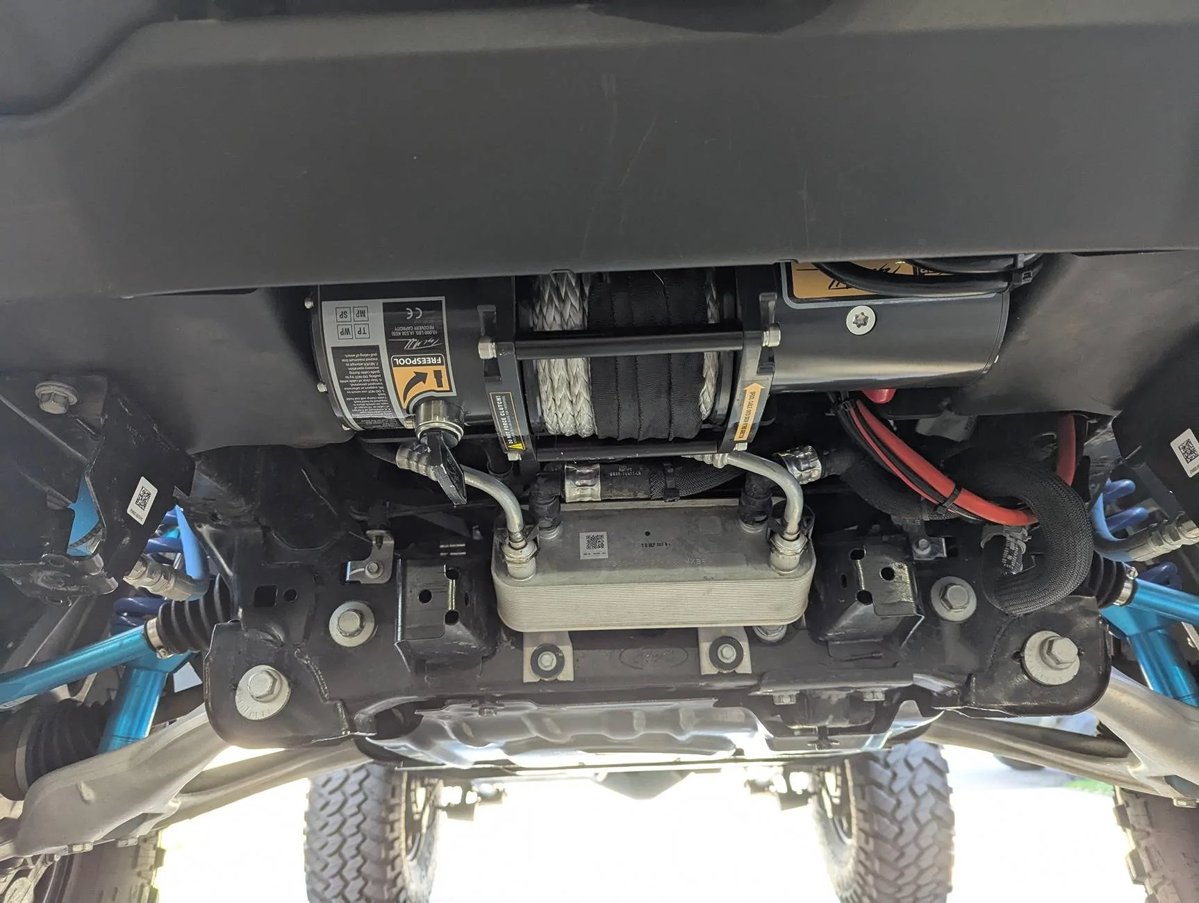

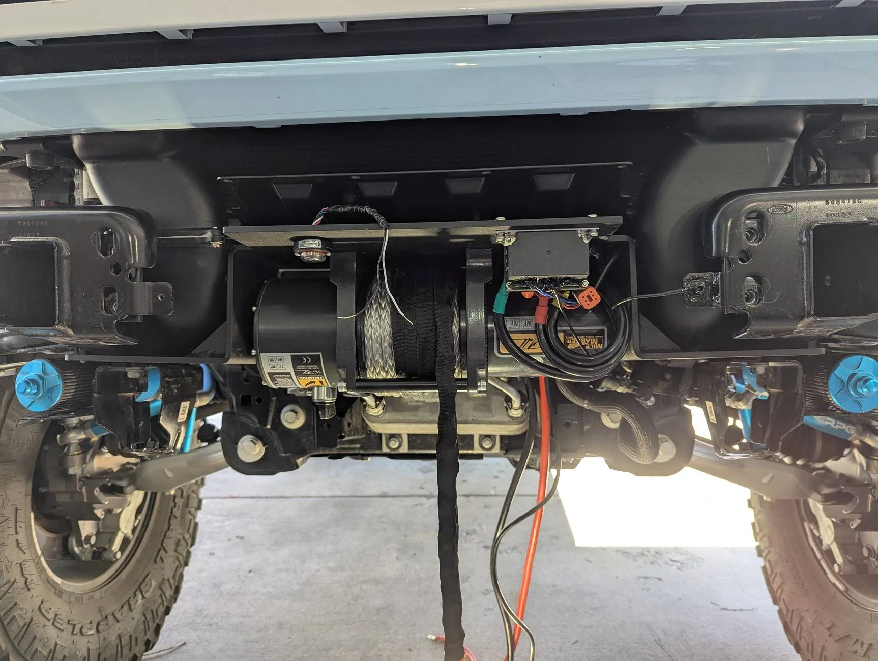

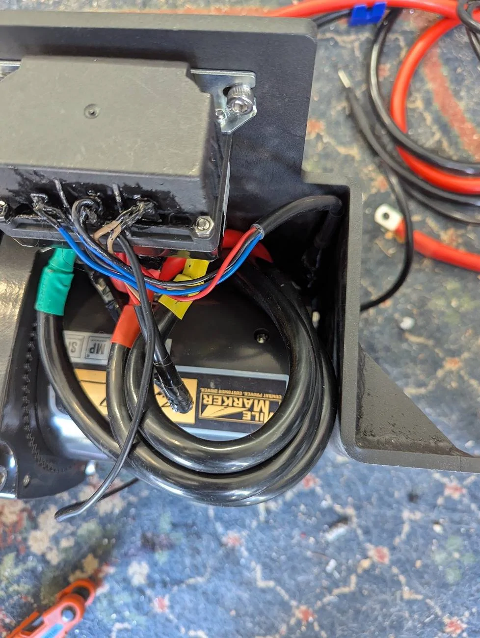

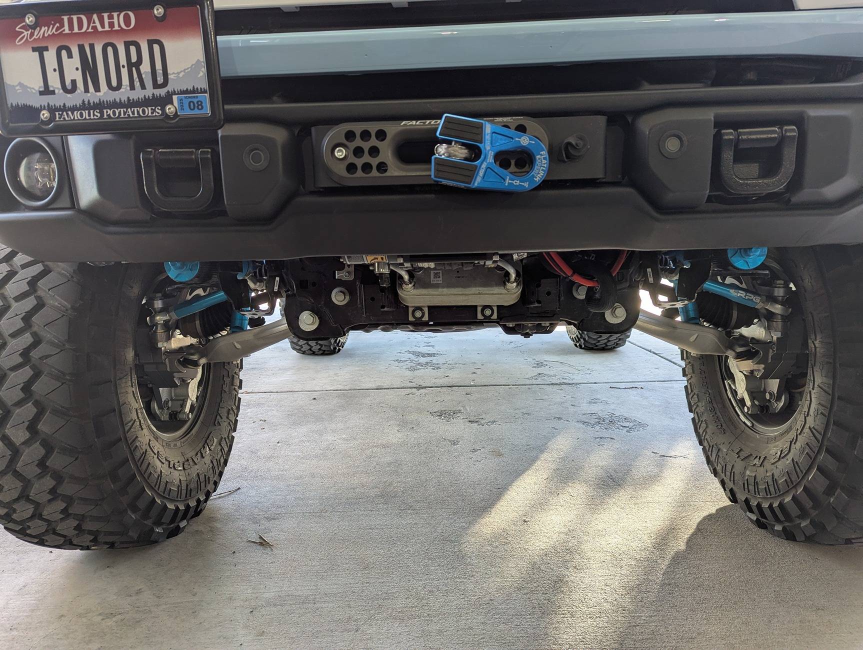

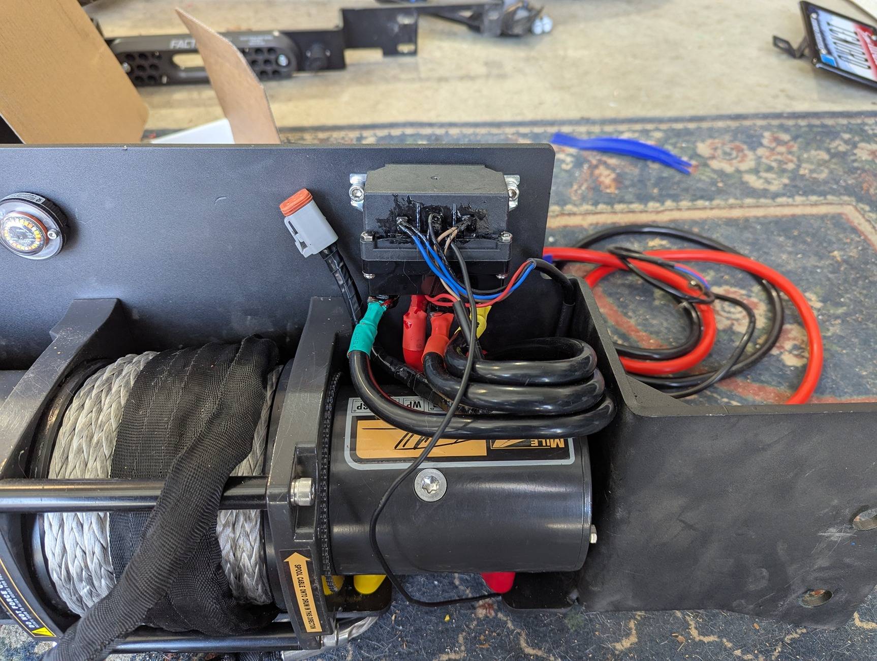

I am very impressed.... The product is top notch. Fit is perfect. I am figuring a few things out with the wiring.... You do have to disassemble the control box from Mile marker to make it fit. It will be a little easier for people once there are some instructions on that... and I need to put an IP68 connection in the wiring between the control unit and the plug for the hand held.... That plug needs to go through the front side of the fair lead mounting plate and it comes from mile marker with all the electrical soldered in place, and since I might in the future need to drop the bumper (which drops the fairlead mount but leaves the winch and control unit mounted.... I want a water proof quick connect between them.... Very impressed with the structural design. Have not spent any time figuring out where to hook up the LED light yet.... (Quickly buttoned everything up to jump on a flex trailer while it was in town last weekend.... And I am a weekend wrencher.... Too much to do during the work week otherwise I would have it done by now.
I connected the power for the light to the solenoid that interrupts power to the winch. So, when I turn the Auxiliary switch on to power the winch, the light comes on. The solenoid I use is just a 500a continuous duty solenoid from Amazon.

Looks great! How’d install go?
Other than about breaking my nose by dropping the skid plate on my face... went pretty well.
I have had this front skid plate off and back on maybe 10 or 12 times in the last year.... Never a problem.... BUT...
Note to self: When you loosen the back two bolts and then remove the front two to slide it off.... If you accidently bump it with the impact as you are trying to place both the bolt and the impact on the ground so you can grab the skid and slide it forward.... It is possible the skid can slide all on it's own.... LOL...
Back to topic... The install is pretty straight forward and rather simple/easy.
